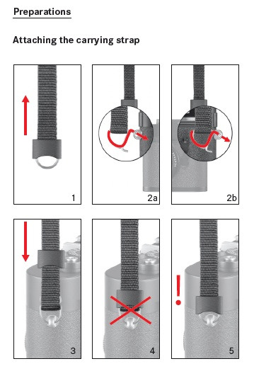

Here's what in the original manual
6 hours ago, a.noctilux said:
Indeed 14312 the best strap for Leica M (minus M5 ! )
have a look in this thread
https://www.l-camera-forum.com/topic/336167-carrying-strap-no-14312/#comment-4501327
so not really split rings
I have several of these straps and can never get the clips on the right way round. Now I put the metal part on first and then attach the cloth strap after, which makes it easier to take off and turn round when I get it on the wrong way round. Some of the metal clips are straight but some have a curve to stand off from the camera body.
