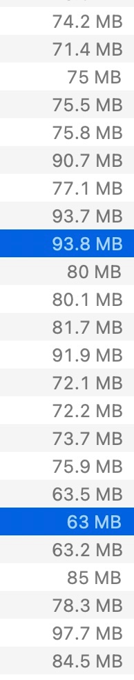

M11 for me Posted January 11, 2023 Share #21 Posted January 11, 2023 Advertisement (gone after registration) vor 10 Stunden schrieb Genoweffa: maybe a bit off tangent.... how large are typical/average DNG and JPEG(by camera) files from M11? Full size DNG has between 65 and 75 MB. There might be some smaller ones and some bigger ones as the exception. But when you think of 400 Euro for an external SSD then you will be able to put at least 70'000 images or more onto that device considering you should not fill it. So for me anyway that takes many years to be there (then I will have to buy a second drive). That is why for me the high Megapixel sensors are not a real problem. If you want to save space you can still use the sensor at 36 or 18 MPix (choose in settings). With in-camera Crop-mode the camera switches automatically to the full resolution which is excellent. So there is something for every use case. Link to post Share on other sites More sharing options...

Genoweffa Posted January 11, 2023 Share #24 Posted January 11, 2023 13 hours ago, M11 for me said: Full size DNG has between 65 and 75 MB. There might be some smaller ones and some bigger ones as the exception. But when you think of 400 Euro for an external SSD then you will be able to put at least 70'000 images or more onto that device considering you should not fill it. So for me anyway that takes many years to be there (then I will have to buy a second drive). That is why for me the high Megapixel sensors are not a real problem. If you want to save space you can still use the sensor at 36 or 18 MPix (choose in settings). With in-camera Crop-mode the camera switches automatically to the full resolution which is excellent. So there is something for every use case. Thanks for the reply. This is interesting, because my SL2/Q2M constantly produce raw @ 80-85MB and on line Leica specs lists max raw as 70-120MB Link to post Share on other sites More sharing options...
Guest Posted January 12, 2023 Share #25 Posted January 12, 2023 (edited) My recent holiday photos average around 74MB for 165 photos. A previous shoot of 123 photos on my Q2 averaged 86MB There is a much greater variance in file size with the M11. I can only assume that the M11 must be applying more effective lossless compression on the raw files Edited January 12, 2023 by Corius Link to post Share on other sites More sharing options...
Viv Posted January 12, 2023 Share #26 Posted January 12, 2023 Why? I shoot RAW with my M11. Link to post Share on other sites More sharing options...
Guest Posted January 12, 2023 Share #27 Posted January 12, 2023 (edited) Advertisement (gone after registration) 12 minutes ago, Viv said: Why? I shoot RAW with my M11. Yes, and I shoot RAW too. Note that I wrote "Lossless" compression. No information is lost unlike with JPEGS which use "lossy" compression. Have a look on Google. Edited January 12, 2023 by Corius Changed "data" to "information" Link to post Share on other sites More sharing options...
Photoworks Posted January 12, 2023 Share #28 Posted January 12, 2023 (edited) On 1/11/2023 at 4:05 AM, M11 for me said: Full size DNG has between 65 and 75 MB. There might be some smaller ones and some bigger ones as the exception. But when you think of 400 Euro for an external SSD then you will be able to put at least 70'000 images or more onto that device considering you should not fill it. So for me anyway that takes many years to be there (then I will have to buy a second drive). That is why for me the high Megapixel sensors are not a real problem. If you want to save space you can still use the sensor at 36 or 18 MPix (choose in settings). With in-camera Crop-mode the camera switches automatically to the full resolution which is excellent. So there is something for every use case. Interesting... I see sizes ranging from 62MB to 96MB for a DNG. I am always amused by the calculation of the drive per images. Looks that for me it maybe it can last me 2-3 weeks Welcome, dear visitor! As registered member you'd see an image here… Simply register for free here – We are always happy to welcome new members! Edited January 12, 2023 by Photoworks Link to post Share on other sites Simply register for free here – We are always happy to welcome new members! ' data-webShareUrl='https://www.l-camera-forum.com/topic/360126-m11-jpeg-output/?do=findComment&comment=4638836'>More sharing options...
M11 for me Posted January 12, 2023 Share #29 Posted January 12, 2023 Well, I wrote actually that there are some larger ones. But I am still a bit surprised to see your figures. Link to post Share on other sites More sharing options...

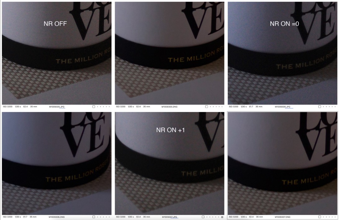

Tkphotography Posted April 8 Share #34 Posted April 8 On 1/9/2023 at 12:50 AM, wdahab said: The JPEG engine in the M11, imo, is very bad at anything above about 2000 or 4000 ISO. For whatever reason, it has a really difficult time handling large scale color noise, leading to JPEGs full of red and green splotches everywhere. It's especially bad when shooting people at high ISO, as they get very sickly splotchy faces. In my experience it made it unusably bad. While that noise is still there in the RAW files, conversion by any other JPEG engine other than the in-body one is lightyears better. That's not even taking into consideration whether you play with any programs noise reduction. IMO, the DNGs are *soooo* good on the M11 and the JPEGs are *soooo* bad, that you really have to be interested in working with Raw images on the M11. Im amazed that no one else is talking about this color noise. I have several leica cameras but the lack of color noise reduction in jpgs are so bad that Im really considering that they might’ve forgot to put it in to begin with.. 😅 Even indoor daylight at 800 iso.. Link to post Share on other sites More sharing options...
jaapv Posted April 9 Share #35 Posted April 9 It is more an issue of postprocessing skill. With DXO PureRaw, LR Enhance or Topaz Photo AI - and virtually every other present-day postprocessing software image noise is a complete non-issue at the ISO values you mention In fact I have not seen colour noise in properly processed ( including jpg) images for years. BTW image noise is not caused by ISO values but by low exposure, I.e. the amount of light hitting the sensor. ISO values are amplifying which amplifies the noise along with the relatively weak image signal. Link to post Share on other sites More sharing options...
lct Posted April 10 Share #36 Posted April 10 On 4/8/2025 at 9:21 PM, Tkphotography said: Im amazed that no one else is talking about this color noise. I have several leica cameras but the lack of color noise reduction in jpgs are so bad that Im really considering that they might’ve forgot to put it in to begin with.. 😅 Even indoor daylight at 800 iso.. Different experience here. I often shoot jpegs with the M11 as i don't need to bother with noise reduction on this camera. I mean up to 6400 iso more or less, far above 800 iso anyway. Just a snap indoor at 6400 iso here (link). Link to post Share on other sites More sharing options...
jaapv Posted April 10 Share #37 Posted April 10 On 4/9/2025 at 2:23 AM, jaapv said: It is more an issue of postprocessing skill. With DXO PureRaw, LR Enhance or Topaz Photo AI - and virtually every other present-day postprocessing software image noise is a complete non-issue at the ISO values you mention In fact I have not seen colour noise in properly processed ( including jpg) images for years. BTW image noise is not caused by ISO values but by low exposure, I.e. the amount of light hitting the sensor. ISO values are amplifying which amplifies the noise along with the relatively weak image signal. The only explanation I can think of is that the poster is systematically underexposing severely. Link to post Share on other sites More sharing options...
pedaes Posted April 10 Share #38 Posted April 10 17 minutes ago, jaapv said: The only explanation I can think of is that the poster is systematically underexposing severely. Well, it is their first post so one is always wary 😉 Link to post Share on other sites More sharing options...
wdahab Posted April 10 Share #39 Posted April 10 On 4/8/2025 at 8:23 PM, jaapv said: It is more an issue of postprocessing skill. With DXO PureRaw, LR Enhance or Topaz Photo AI - and virtually every other present-day postprocessing software image noise is a complete non-issue at the ISO values you mention In fact I have not seen colour noise in properly processed ( including jpg) images for years. BTW image noise is not caused by ISO values but by low exposure, I.e. the amount of light hitting the sensor. ISO values are amplifying which amplifies the noise along with the relatively weak image signal. Lol, this picks up on a conversation from 2 years ago? To clarify, when I shoot raw I don't have this issue with post-processing at all. So it's not underexposure or my own workflow. It's the in-camera JPEG engine that's the problem, it has massive color blotchiness in images at high ISO that don't exist when I process RAWs, at the same exposure settings, myself with Lightroom/Photomator. Link to post Share on other sites More sharing options...
jaapv Posted April 10 Share #40 Posted April 10 3 minutes ago, wdahab said: Lol, this picks up on a conversation from 2 years ago? To clarify, when I shoot raw I don't have this issue with post-processing at all. So it's not underexposure or my own workflow. It's the in-camera JPEG engine that's the problem, it has massive color blotchiness in images at high ISO that don't exist when I process RAWs, at the same exposure settings, myself with Lightroom/Photomator. Well in that case your camera is defective and I advise you to consult Leica. Not even the M8 had this problem. Link to post Share on other sites More sharing options...
