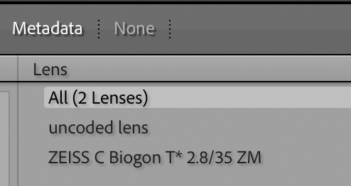

marchyman Posted April 6, 2023 Share #1368 Posted April 6, 2023 1 hour ago, lct said: That's what i do for my dozen CV and ZM lenses. I don't like incorrect metadata. Because of my workflow and the fact I almost never change lenses while shooting it is easier for me to apply proper metadata upon import then pick a code that is close but not accurate. If I changed lenses often it would be a pain. Anyway, metadata for my ZM lens looks like this: Welcome, dear visitor! As registered member you'd see an image here… Simply register for free here – We are always happy to welcome new members! The "uncoded lens" was the test image I used to verify my metadata changes were correct. Link to post Share on other sites Simply register for free here – We are always happy to welcome new members! The "uncoded lens" was the test image I used to verify my metadata changes were correct. ' data-webShareUrl='https://www.l-camera-forum.com/topic/357248-m11-freeze-issues-merged/?do=findComment&comment=4744445'>More sharing options...
lct Posted April 6, 2023 Share #1369 Posted April 6, 2023 41 minutes ago, marchyman said: I don't like incorrect metadata. Because of my workflow and the fact I almost never change lenses while shooting it is easier for me to apply proper metadata upon import then pick a code that is close but not accurate. If I changed lenses often it would be a pain. Anyway, metadata for my ZM lens looks like this: Welcome, dear visitor! As registered member you'd see an image here… Simply register for free here – We are always happy to welcome new members! The "uncoded lens" was the test image I used to verify my metadata changes were correct. So you have one uncoded lens (ZM 35/2.8). Great lens, i have the same as yours. Mine is hand-coded as Summarit 35/2.4. This way the lens can be used on the M11 under lens detection auto. Yours is not hand-coded i suspect. You may wish to enter a lens profile (35/2.4 or other) under lens detection manual. Failing which the lens will not be recognized by the camera which cannot read the metadata you refer to. May i ask where those metadata come from? Link to post Share on other sites More sharing options...
