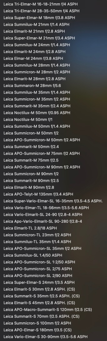

erudolph Posted April 28, 2022 Share #9 Posted April 28, 2022 Some lens profile corrections are being applied: 35mm APO-Summicron-M and the f/.95 Noctilux 1 Quote Link to post Share on other sites More sharing options...

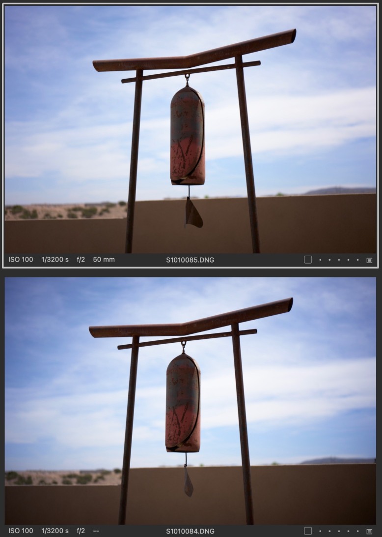

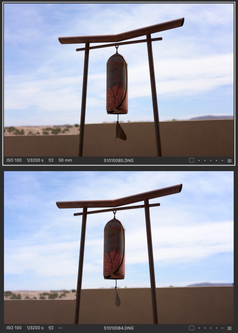

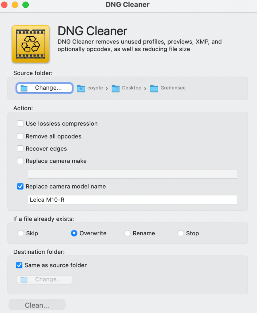

SrMi Posted April 28, 2022 Share #10 Posted April 28, 2022 Note that lens corrections with Tri-Elmar work if I change the model name from "LEICA M11" to "LEICA M10-R" (I used DNG Cleaner to change the name). Seems clearly an Adobe bug. 2 3 Quote Link to post Share on other sites More sharing options...

Adam Bonn Posted April 28, 2022 Share #15 Posted April 28, 2022 (edited) 7 hours ago, SrMi said: Note that lens corrections with Tri-Elmar work if I change the model name from "LEICA M11" to "LEICA M10-R" (I used DNG Cleaner to change the name). Seems clearly an Adobe bug. I forgot to add.. Great work Srdjan. You’ve proved that Leica’s DNG content (this is separate from the dcp file folks) is correct and implemented as per their previous cameras. Adobe appears to be incorrectly rendering the file against the parameters contained within its own lens profile files and has work to do (and no folks, this doesn’t mean making a new dcp profile file) Now that adobe officially lists the M11 as ‘supported’ FWIW I think that M11 owners start logging this bug. https://community.adobe.com/t5/lightroom-ecosystem-cloud-based-bugs/how-do-i-write-a-bug-report/idi-p/12386393 https://www.adobe.com/products/wishform.html Edited April 28, 2022 by Adam Bonn 1 Quote Link to post Share on other sites More sharing options...
