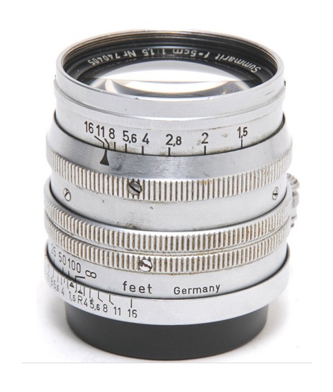

The ELCAN was made to a slightly different spec. - and slightly lower overall performance - to the then-current Summicron. According to Dr. Mandler, who was largely in charge of the ELCAN design,
"The performance specifications did not require the image quality offered by the 5cm f2 Summicron......In image quality I would place it between the 5cm f2 Summitar and the first Summicron (or Summitar*).  The lens type that we have used is overstrained as far as field coverage goes."
This last point might very well be the reason that the OP noted in post #5;
"After pixel peeping, I was able to see that in high contrast areas near the edge of the picture / corners, the lens has some purple chromatic aberration. Fairly well controlled, but I’d say that the summicron does a better job here."

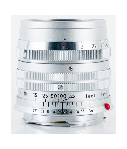

I've only just managed to find the time to watch the whole of the vid. clip you linked-to in post #5; I found it very interesting, informative and enjoyable so, first-off, thanks for that.
Yes; the very compact size is, I must say, something which I find very attractive. Much like the OP I'm not all that bothered by seeking-out absolute optical perfection in every lens I use (to put it mildly) so the slight drop in IQ from my v4 Summicron to this isn't something which would bother me at all. I must say I find it a very interesting proposition. In terms of how it renders it would probably be a very good alternative fitting-in somewhere between the f1.5 Summarit and the v4 Summicron. Add-in the very small size and I see how very tempting the LLL could be.
Shame an 'IROOA' recreation isn't part of the package (as I believe it to be with their 8-Element) but as the lens will take a regular 12585 it's not much of a handicap.
Food for thought...
One last thing; it says in the spec's that the lens' dimensions are "36mm Width; 51mm Length". I believe they've got those sizes the wrong way 'round. If not then the 'ELCAN' is longer than the v4 Summicon. I've just checked and my v4 is 42mm Long and 51mm Wide. Perhaps shirubadanieru could enlighten us?
Philip.
EDIT : Didn't fully appreciate this image previously;
It just became even more interesting!
