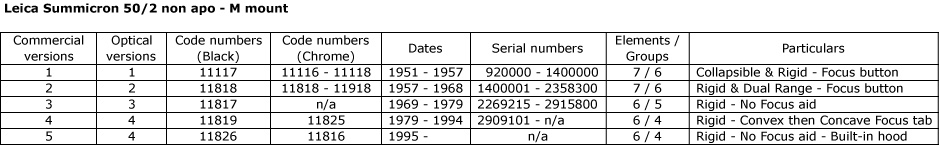

a.noctilux Posted June 7, 2021 Share #8  Posted June 7, 2021 I think that the best way to call those Summicron, as Luigi stated above is by their Leitz/Leica manufacturer number, name or code like : - SOSTA/11018/11518... - SOSIC/11618/11818/11117/11918 - 11817 or 1969-1979 (III ?) - 11819, 11825, 11826, 11816, 11624, 11619, ...10483 = version IV or V ? not simple but precise  1 1 Quote Link to post Share on other sites More sharing options...

romualdo Posted June 9, 2021 Share #14  Posted June 9, 2021 10 hours ago, lct said: Not sure i've ever heard of a numbering system about Leica lenses but there are commercial and optical numbers that most people seem to agree with AFAIK. Welcome, dear visitor! As registered member you'd see an image here⊠Simply register for free here â We are always happy to welcome new members!  I was under the impression (according to Laney) that the first optical version was only available in the collapsible form, screw & M mount (SOOIC & SOOIC-M). There was no rigid version of this first design (or was there)? 1 Quote Link to post Share on other sites More sharing options...
