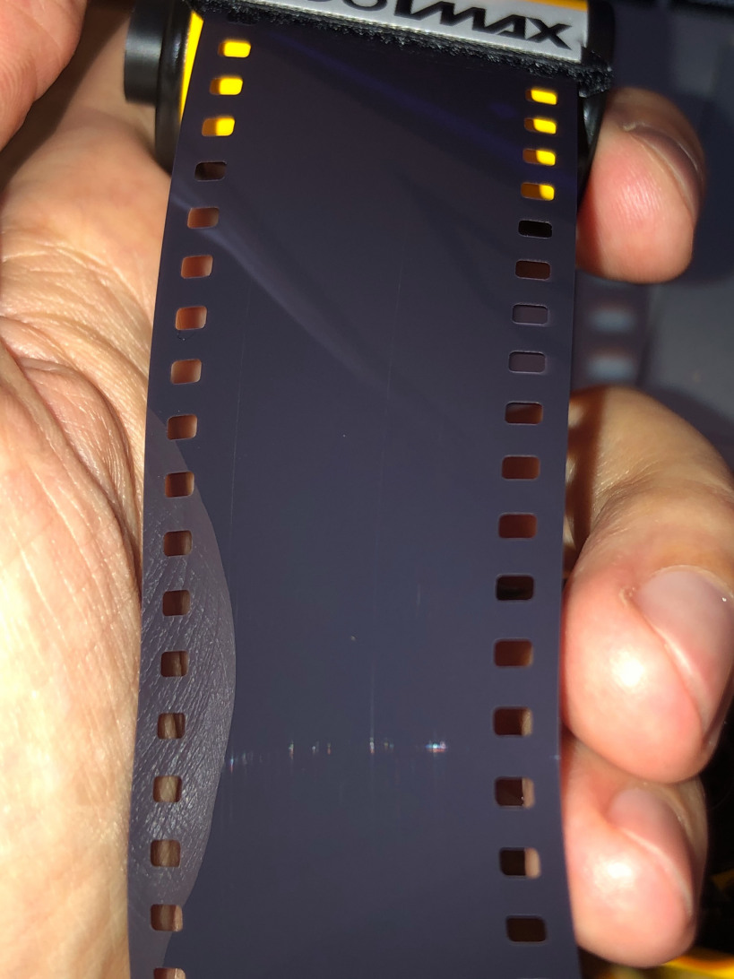

gabrielaszalos Posted April 23, 2021 Author Share #46 Posted April 23, 2021 And here's the beauty shot, going in for my 3rd test with a clean roll. I advanced 5 frames and rewound, then did that again with this film, to make sure extra marks are there. I succeeded, if one can call this a success. Welcome, dear visitor! As registered member you'd see an image here… Simply register for free here – We are always happy to welcome new members! Quote Link to post Share on other sites Simply register for free here – We are always happy to welcome new members! ' data-webShareUrl='https://www.l-camera-forum.com/topic/319869-mechanical-perfection/?do=findComment&comment=4187201'>More sharing options...

logan2z Posted April 23, 2021 Share #48 Posted April 23, 2021 13 minutes ago, gabrielaszalos said: And here's the beauty shot, going in for my 3rd test with a clean roll. I advanced 5 frames and rewound, then did that again with this film, to make sure extra marks are there. I succeeded, if one can call this a success. Welcome, dear visitor! As registered member you'd see an image here… Simply register for free here – We are always happy to welcome new members! I know you're fed up and don't really want to analyze the problem with your latest MP, but I'm curious, are these scratches across the entire length of the previous rolls you shot or just at the start of the roll? I can't see the scratches in the photos of the hanging film or I could probably answer my own question. Quote Link to post Share on other sites More sharing options...
gabrielaszalos Posted April 23, 2021 Author Share #49 Posted April 23, 2021 5 minutes ago, logan2z said: I know you're fed up and don't really want to analyze the problem with your latest MP, but I'm curious, are these scratches across the entire length of the previous rolls you shot or just at the start of the roll? I can't see the scratches in the photos of the hanging film or I could probably answer my own question. You're right. I am fed up. It's not hard to see that they are on all frames of my roll, since the first roll I shot. If you want, I can share one of my rolls in private, although not sure how it helps, unless you have some reason that this will help *you* Quote Link to post Share on other sites More sharing options...
logan2z Posted April 23, 2021 Share #50 Posted April 23, 2021 2 minutes ago, gabrielaszalos said: You're right. I am fed up. It's not hard to see that they are on all frames of my roll, since the first roll I shot. If you want, I can share one of my rolls in private, although not sure how it helps, unless you have some reason that this will help *you* No, it won't help me, I was just curious if it affected the entire roll. That really sucks. As I've mentioned several times before, my M-A bought new a few years ago has been flawless - and I'm not usually particularly lucky with these sorts of things I hate to say this, but it might be time to give up 😔 Quote Link to post Share on other sites More sharing options...

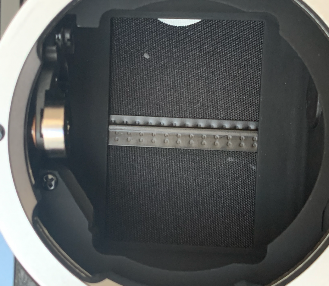

28framelines Posted April 23, 2021 Share #53 Posted April 23, 2021 You’re saying it’s on the non-emulsion side (the back side) of the film. I hate to ask this, as I’m legitimately not trying to provoke you as I’m sure you’ve already checked, but just in case: is there any dust or debris on the back plate of the door that could be scratching the film? I ask because you state that it’s getting worse over time, and that indicates to me it could be a “build up” of something. Quote Link to post Share on other sites More sharing options...

gabrielaszalos Posted April 23, 2021 Author Share #55 Posted April 23, 2021 Just now, logan2z said: You have more patience than I do FWIW, I've never owned an M2, but I do own an M4 and I don't really notice much if any difference between its viewfinder and the one in my M-A. Both are nice and bright. So you may not be giving up much going for an older camera. But if you can manage to get a working BP MP, then it's hard to argue against that option. Thanks, that good to know. Just now, 28framelines said: You’re saying it’s on the non-emulsion side (the back side) of the film. I hate to ask this, as I’m legitimately not trying to provoke you as I’m sure you’ve already checked, but just in case: is there any dust or debris on the back plate of the door that could be scratching the film? I ask because you state that it’s getting worse over time, and that indicates to me it could be a “build up” of something. I appreciate the sensitivity. You're right. I am also wondering. When I did the last test, I did check carefully inside, and tried to wipe the pressure plate clean and feel if there's any debris or dust in there. It does seem to be getting worse and worse. It hasn't helped though. I might try this again. Also, it may be that it's getting worse and worse, but also the fact that this became more noticeable since I switched from HP5 to Tri-X. Maybe Tri-X is just more sensitive. Either way, I'll consider looking once more, even more carefully. I do want to state though that I haven't opened the camera anywhere outside of a house. Whenever I opened it to change film, I always did it quickly, indoors, and without really opening the backdoor much. I'm going to be back with more details if anything changes. Thank you for your suggestions. Quote Link to post Share on other sites More sharing options...
logan2z Posted April 23, 2021 Share #56 Posted April 23, 2021 5 minutes ago, gabrielaszalos said: Thanks, that good to know. I appreciate the sensitivity. You're right. I am also wondering. When I did the last test, I did check carefully inside, and tried to wipe the pressure plate clean and feel if there's any debris or dust in there. It does seem to be getting worse and worse. It hasn't helped though. I might try this again. Also, it may be that it's getting worse and worse, but also the fact that this became more noticeable since I switched from HP5 to Tri-X. Maybe Tri-X is just more sensitive. Either way, I'll consider looking once more, even more carefully. I do want to state though that I haven't opened the camera anywhere outside of a house. Whenever I opened it to change film, I always did it quickly, indoors, and without really opening the backdoor much. I'm going to be back with more details if anything changes. Thank you for your suggestions. Good luck, keep us posted. Quote Link to post Share on other sites More sharing options...

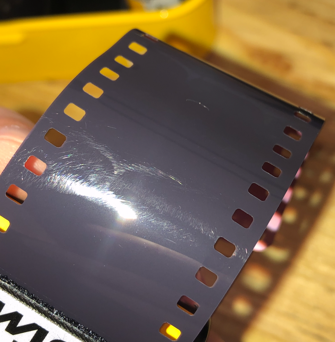

gabrielaszalos Posted April 23, 2021 Author Share #57 Posted April 23, 2021 Thanks. I just opened the back, cleaned the pressure plate with a Zeiss Lens Wipe, then wiped it clean with a microfiber cloth I have from Leica. Afterwards, I took yet another clean new TMax-400 rolls and rubbed it against the pressure plate. This is the result: Welcome, dear visitor! As registered member you'd see an image here… Simply register for free here – We are always happy to welcome new members! Quote Link to post Share on other sites Simply register for free here – We are always happy to welcome new members! ' data-webShareUrl='https://www.l-camera-forum.com/topic/319869-mechanical-perfection/?do=findComment&comment=4187247'>More sharing options...
