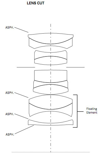

jonoslack Posted March 6, 2021 Author Share #81 Posted March 6, 2021 (edited) Advertisement (gone after registration) 38 minutes ago, UliWer said: Seeing the lens designs of the 35 Summarit and the new Summicron next to each others makes me look at the new lens with mixed feelings. The Summarit still had the „classical“ Double Gauss design which has been the realm of M-lenses for so long. The new Apo Summicron obviously has the much more complicated design of the SL-lenses - forced into the small mount of an M-lens. The times when it was the aim of Leica lenses to achieve better performance with less lens elements seem to be just a faint remembrance of the past. Perhaps the times when lenses for the M set the standard for optical design are gone. Now designs for completely different systems set the standards and are customized for the M. Oh! But the SL summicron is different again. It’s the principal of using APO glass and floating elements. Seems to me that this lens does exactly set standards for optical design of small lenses. Having fewer elements may make it easier/cheaper to design/manufacture but not necessarily better quality. of course this kind of lens would have been both impossible to design (without modern computing techniques) and impossible to manufacture (because of the terrifyingly small tolerances required). Not to mention the impossibility of making the glass! But surely it’s good to take advantage of mechanical and optical advances? If the lens was huge you might have a point, but it isn’t PS Definitely not knocking the Summarit, which is a lovely lens Edited March 6, 2021 by jonoslack 7 Link to post Share on other sites More sharing options...

Herr Barnack Posted March 6, 2021 Share #82 Posted March 6, 2021 (edited) @jonoslack and @UliWer Quote ...But surely it’s good to take advantage of mechanical and optical advances?... I can see no reason that doing so would be a bad thing. Quote ...The times when it was the aim of Leica lenses to achieve better performance with less lens elements seem to be just a faint remembrance of the past... I have never asked, "how many lens elements does it have?" before purchasing a lens. Has anyone else ever asked that question? Quote ...Perhaps the times when lenses for the M set the standard for optical design are gone... Given the performance of Leica's most recent lens offerings, it would appear that the opposite is true. JMHO/YMMV. Edited March 6, 2021 by Herr Barnack 3 Link to post Share on other sites More sharing options...
earleygallery Posted March 6, 2021 Share #83 Posted March 6, 2021 On 3/5/2021 at 5:16 AM, adan said: Good catch. The rainbow-order (and purity) of the color bands screams "diffraction" to me. And I note in the diagram that there are a massive number (well, 5, including a triplet) of large cemented surfaces, with curves that have to fit hand-in-glove to really high tolerances (wavelengths, not 1/mm). Welcome, dear visitor! As registered member you'd see an image here… Simply register for free here – We are always happy to welcome new members! I'm thinking even slightly uneven cemented joins would produce color patterns akin to Newton rings, oil-slick-on-wet-pavement patterns, or even plain old diffraction gratings. I would not think it has anything to do with APO (or even ASPH) construction directly - although obviously the glass was designed to fit together that way for some overlying optical purpose. (Images linked from wikimedia) It might even be a one-off, since Jono was using an early pre-announcement lens, made (possibly) while the production was still getting zeroed in. Imperfect perfection. Kind of Lomo style. Link to post Share on other sites More sharing options...
farnz Posted March 7, 2021 Share #84 Posted March 7, 2021 3 hours ago, UliWer said: The times when it was the aim of Leica lenses to achieve better performance with less lens elements seem to be just a faint remembrance of the past. The 35 APO-M's design shows that Leica is still committed to this particularly when you consider the size of the lens, its performance, and that so many other systems use software to correct for optical aberrations rather than 'in the lens'. Pete. 9 1 Link to post Share on other sites More sharing options...
