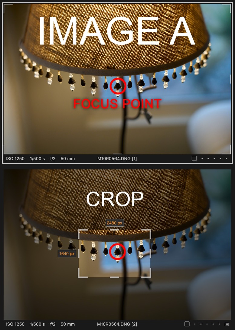

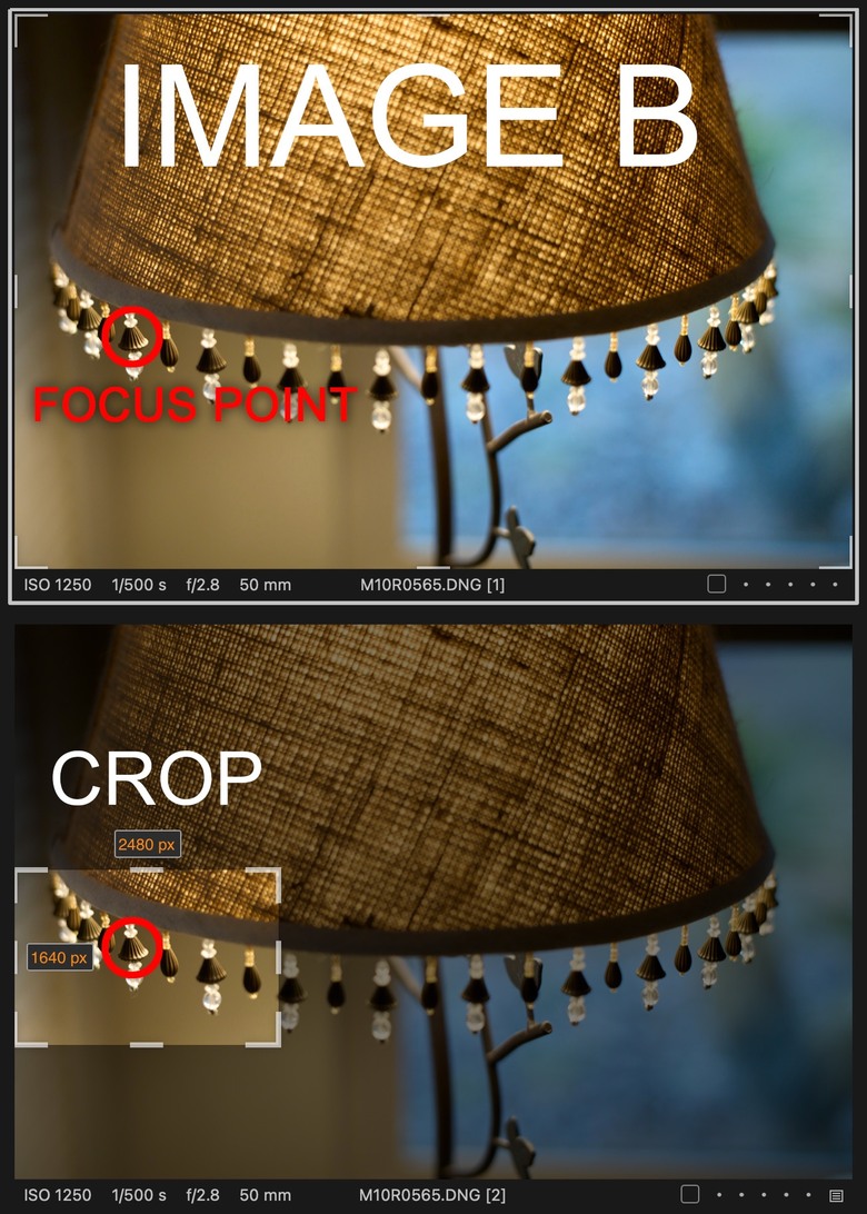

hdmesa Posted March 27, 2021 Share #41  Posted March 27, 2021 Advertisement (gone after registration) 10 minutes ago, lct said: You did not focus the better way or your lens has a problem sorry . Did you recompose after focusing if i may ask? No, I mentioned that in the post – camera position did not move, I just focused on a different spot using the rear LCD. Quote Link to post Share on other sites More sharing options...
Advertisement Posted March 27, 2021 Posted March 27, 2021 Hi hdmesa, Take a look here How and Why does 50 APO perform better than other 50s. I'm sure you'll find what you were looking for!
lct Posted March 27, 2021 Share #42  Posted March 27, 2021 4 minutes ago, hdmesa said: No, I mentioned that in the post – camera position did not move, I just focused on a different spot using the rear LCD. You should not get faulty results like that, sorry again. If i may, just use your EVF w/o focus magnification if it bothers you and you'll get way better results. Quote Link to post Share on other sites More sharing options...

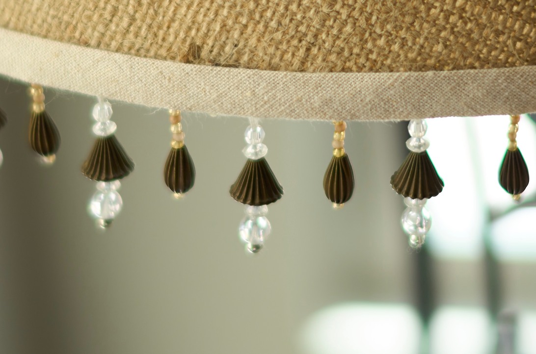

hdmesa Posted March 27, 2021 Share #43  Posted March 27, 2021 (edited) 8 minutes ago, lct said: You should not get faulty results like that, sorry again. If i may, just use your EVF w/o focus magnification if it bothers you and you'll get way better results. I find magnified focusing on the rear LCD is easy to use, and I could clearly tell when something was in focus or not. The center of the frame snapped into focus perfectly. When focusing anywhere in the outer portion of the frame with the 50 Lux (wide open at MFD), the point of focus never becomes sharp, so I took the photo that represented the best possible focus. It could be the field curvature on the 50 Lux at MFD is so strong that the sides of the frame cannot be in focus, and I would have to step back a few feet (which is what I found – stepping back from MFD allowed the sides to be sharper). Have you used the Lux on the M10-R and reviewed off-center sharpness at 100% magnification? It may be much less forgiving than a 24mp camera. Edited March 27, 2021 by hdmesa Quote Link to post Share on other sites More sharing options...
lct Posted March 27, 2021 Share #44  Posted March 27, 2021 Seems like we cannot understand each other i fear. The center of the frame can in no way be in focus together with the corner in your pic. At f/1.4 and 0.7m DoF is too short for that. If you focus at the corner, the latter will be sharp and the center will be blurred but both cannot be sharp altogether. 1 Quote Link to post Share on other sites More sharing options...
dkmoore Posted March 27, 2021 Share #45  Posted March 27, 2021 (edited) 29 minutes ago, lct said: Seems like we cannot understand each other i fear. The center of the frame can in no way be in focus together with the corner in your pic. At f/1.4 and 0.7m DoF is too short for that. If you focus at the corner, the latter will be sharp and the center will be blurred but both cannot be sharp altogether. Fact. I think it’s a faulty understanding of DOF and focus plane for hdmesa Edited March 27, 2021 by dkmoore Quote Link to post Share on other sites More sharing options...
hdmesa Posted March 27, 2021 Share #46  Posted March 27, 2021 (edited) 1 hour ago, lct said: Seems like we cannot understand each other i fear. The center of the frame can in no way be in focus together with the corner in your pic. At f/1.4 and 0.7m DoF is too short for that. If you focus at the corner, the latter will be sharp and the center will be blurred but both cannot be sharp altogether.  1 hour ago, dkmoore said: Fact. I think it’s a faulty understanding of DOF and focus plane for hdmesa  The crops are from TWO DIFFERENT PHOTOS, each focused on a different part of the frame while the camera position did not move. This is not about DOF, it's about sharpness at the exact point of focus. For reference in my first post with the samples: Image 1: Overview to show the subject and camera position Image 2: Crop from Image 1 (focused on the dangly thing in the center) Image 3: Crop from the left side of a DIFFERENT photo (focused on a dangly thing on the left side of the frame) Edited March 28, 2021 by hdmesa Quote Link to post Share on other sites More sharing options...
