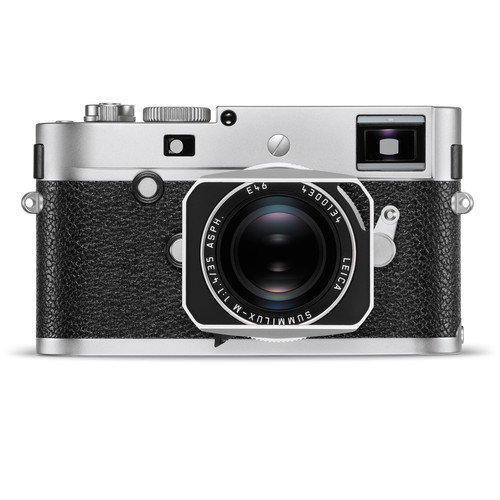

malligator Posted October 2, 2020 Share #1 Posted October 2, 2020 Advertisement (gone after registration) I just got a new FLE and either the entire hood is turned a little counterclockwise or it's just a little asymmetric with the top (and maybe bottom) edges sloping a little from the VF side to the shutter release side. I've looked at it a million times and I can't tell which it is. The lens is mounted correctly and the hood is definitely screwed down all the way. The hood is either a little cockeyed, asymmetric, or it's an optical illusion due to all the different lines and curves of the camera and lens. Quote Link to post Share on other sites More sharing options...
Advertisement Posted October 2, 2020 Posted October 2, 2020 Hi malligator, Take a look here Is the FLE's hood a little asymmetric?. I'm sure you'll find what you were looking for!
pedaes Posted October 2, 2020 Share #2 Posted October 2, 2020 (edited) 1 hour ago, malligator said: I just got a new FLE and either the entire hood is turned a little counterclockwise or it's just a little asymmetric with the top (and maybe bottom) edges sloping a little from the VF side to the shutter release side. I've looked at it a million times and I can't tell which it is. The lens is mounted correctly and the hood is definitely screwed down all the way. The hood is either a little cockeyed, asymmetric, or it's an optical illusion due to all the different lines and curves of the camera and lens. Are you talking about the 35mm..? Are you sure it has 'clicked' home? Answer to question is 'no'. On a flat/plane surface easy to check if bottom edge parallel to surface (assuming you are talking about Summilux 35mm and it is completely mounted) . Edited October 2, 2020 by pedaes Quote Link to post Share on other sites More sharing options...
lct Posted October 2, 2020 Share #3 Posted October 2, 2020 Do you mean this? Welcome, dear visitor! As registered member you'd see an image here… Simply register for free here – We are always happy to welcome new members! Quote Link to post Share on other sites Simply register for free here – We are always happy to welcome new members! ' data-webShareUrl='https://www.l-camera-forum.com/topic/313851-is-the-fles-hood-a-little-asymmetric/?do=findComment&comment=4056224'>More sharing options...
malligator Posted October 2, 2020 Author Share #4 Posted October 2, 2020 I'm almost certain it's my eyes playing tricks on me. When I cover the top half of the hood (looking at the lens/camera from the front) I can see that the bottom is level. When I uncover it everything goes wonky again. My eyes are keying off something that's making things look slanted. I think it's that line that is on the release side, but not on the VF side. https://static.bhphoto.com/images/multiple_images/images500x500/1410865210_IMG_424604.jpg Quote Link to post Share on other sites More sharing options...
chasdfg Posted October 3, 2020 Share #5 Posted October 3, 2020 I've seen the same on my 35FLE and I think my 28cron v2. Makes you want to turn it more to level it but you're at the hard stop. Bothered me at first but it's normal 1 Quote Link to post Share on other sites More sharing options...
CosmoM3 Posted October 3, 2020 Share #6 Posted October 3, 2020 My Cron 28 ASPH II didn’t line up perfectly either Quote Link to post Share on other sites More sharing options...
Mute-on Posted October 4, 2020 Share #7 Posted October 4, 2020 (edited) Advertisement (gone after registration) Surely this is a visual quirk resulting from the cutout in the top-right corner of the hood (viewed from the front)? I have the same style hood on my 28 Elmarit asph, but it looks square to me on a cursory examination. I’ve learnt to avoid very close, detailed inspections of the type described by the OP since I know I will then tend to obsess over the perceived, inconsequential deviation from my impression of symmetry or perfection. In other words, forget about it! Life is too short to waste time on such matters. Edited October 4, 2020 by Mute-on 2 Quote Link to post Share on other sites More sharing options...
