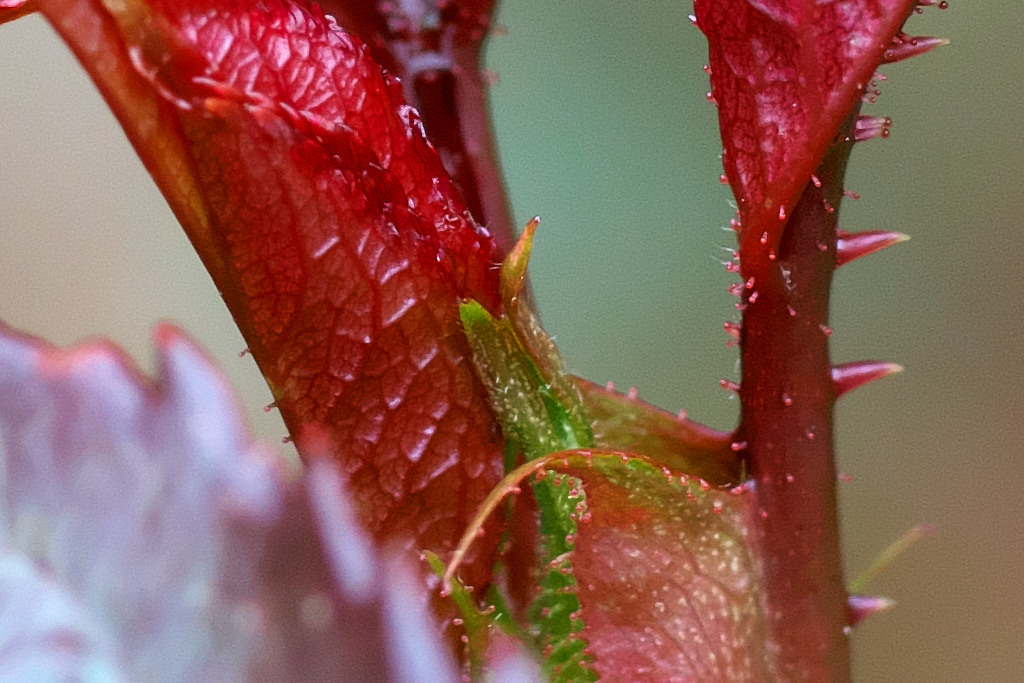

lct Posted March 7, 2020 Share #102 Posted March 7, 2020 Just shot with 90/2 apo on macro adapter. Not sure i could do much better with the 90/4 macro. As for the R 60/2.8 i would have to kneel down due to its shorter reach and my wife would complain about my dirty trousers (Digital CL, Summicron-M 90/2 apo, Macro-Adapter-M v2, f/5.6, about 50cm subject distance, handheld). Welcome, dear visitor! As registered member you'd see an image here… Simply register for free here – We are always happy to welcome new members! 2 1 Link to post Share on other sites Simply register for free here – We are always happy to welcome new members! ' data-webShareUrl='https://www.l-camera-forum.com/topic/306372-macro-lenses-for-leica-cl/?do=findComment&comment=3926662'>More sharing options...

lct Posted March 7, 2020 Share #104 Posted March 7, 2020 1 hour ago, lct said: Digital CL, Summicron-M 90/2 apo, Macro-Adapter-M v2, f/5.6, about 50cm subject distance, handheld Same combo and 100% crop. Who said that the 90/2 apo is soft at close distance? Welcome, dear visitor! As registered member you'd see an image here… Simply register for free here – We are always happy to welcome new members! 1 Link to post Share on other sites Simply register for free here – We are always happy to welcome new members! ' data-webShareUrl='https://www.l-camera-forum.com/topic/306372-macro-lenses-for-leica-cl/?do=findComment&comment=3926729'>More sharing options...
