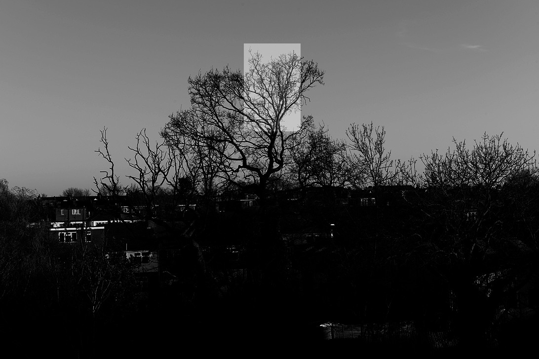

Keith (M) Posted March 23, 2020 Share #13 Posted March 23, 2020 Aside from medium yellow, I been making quite a lot of use of my Heliopan Orange 22 (mostly on 50mm Summilux-M ASPH). Typical result below, followed by a 1:1 crop of the RHS. Can't say I've noticed any loss of resolution/sharpness. Welcome, dear visitor! As registered member you'd see an image here… Simply register for free here – We are always happy to welcome new members! 6 Link to post Share on other sites Simply register for free here – We are always happy to welcome new members! ' data-webShareUrl='https://www.l-camera-forum.com/topic/305498-m10-monochrom-filters/?do=findComment&comment=3937304'>More sharing options...

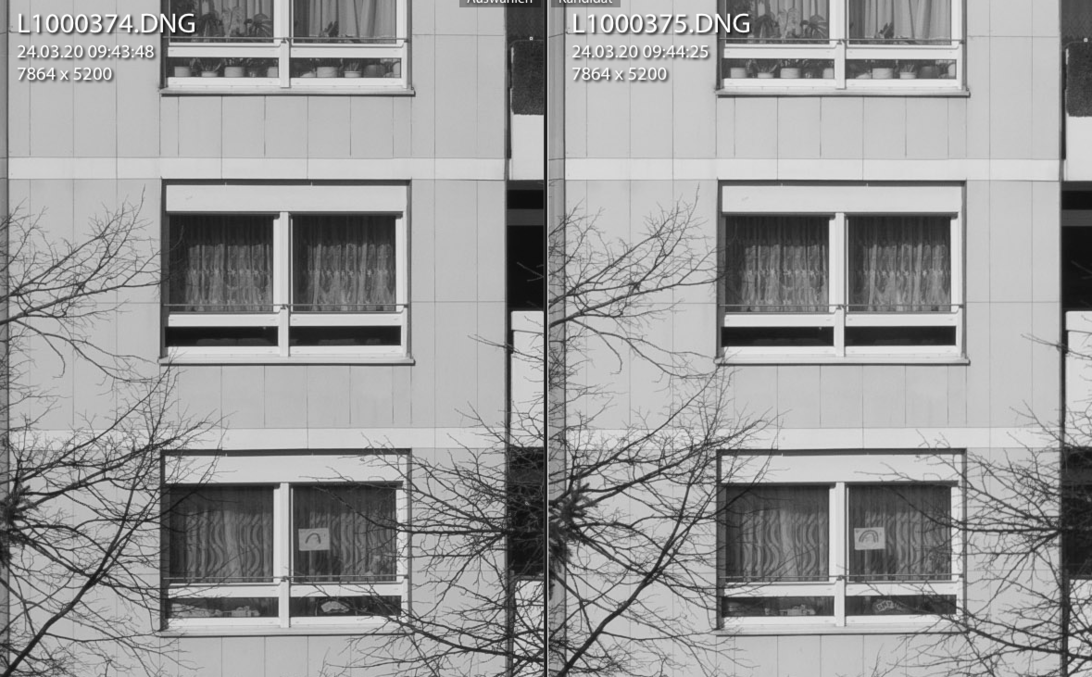

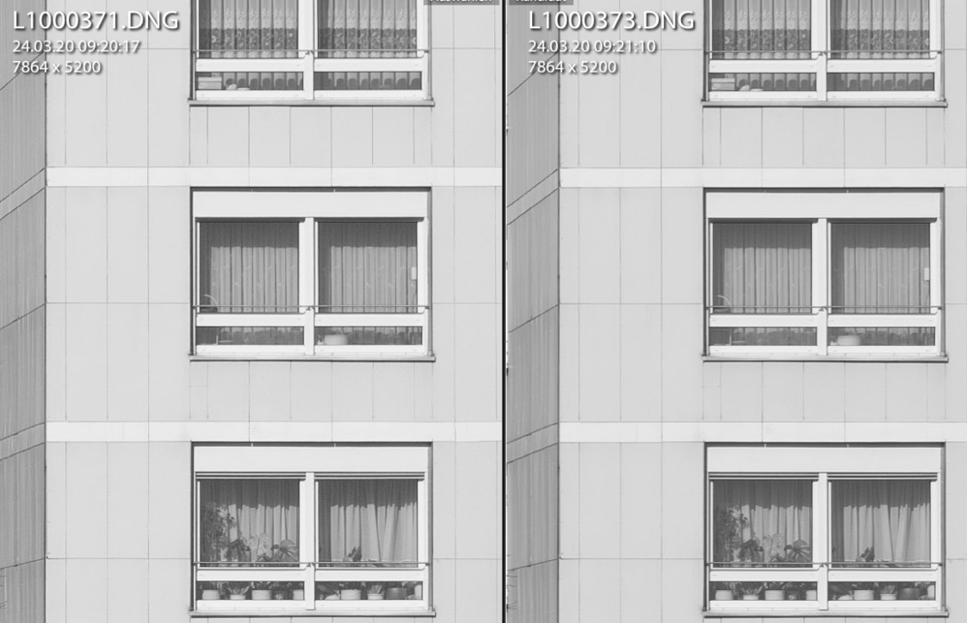

jaapv Posted March 23, 2020 Share #14 Posted March 23, 2020 6 hours ago, Martin Munich said: That´s actually what I was doing yesterday and the results were just BAD. The B&W 091 dark red produced no real sharp images (1.4/35 Summilux). So I made a test this morning and the results are shown in the attached screenshot (100% DNG with standard LR profile). On the left, 091 attached, on the right the bare lens, both at f8. I also tried a precise focusing on tripod, shifted the focus through the entire range, this is the best I could get. Stopping up leads to even more unsharp images. Will make further testing with a 040 orange. My recommendation so far: do not use color contrast filters at all. Which is really sad since I was really looking for that with the M10M. Welcome, dear visitor! As registered member you'd see an image here… Simply register for free here – We are always happy to welcome new members! The cause is not the filter. You probably missed that a red filter will produce pronounced focus shift. You need to adjust your focussing technique with such filters. Note - the shift will vary with the lens - APO lenses are less affected. 1 Link to post Share on other sites More sharing options...
pippy Posted March 23, 2020 Share #15 Posted March 23, 2020 (edited) 6 hours ago, Martin Munich said: ...The B&W 091 dark red produced no real sharp images (1.4/35 Summilux). So I made a test this morning and the results are shown in the attached screenshot......I also tried a precise focusing on tripod, shifted the focus through the entire range, this is the best I could get. Stopping up leads to even more unsharp images.....My recommendation so far: do not use color contrast filters at all... This mirrors my own experience using a red filter on different Ms (M8.2; M9-P; M9M; M-D Typ 262) but not with other colours of filter. The first couple of times I used a red filter I thought I had focussed poorly so tried again taking extreme care. No difference. I then thought that perhaps the quality of filter was perhaps making the images soft - perhaps the surfaces were not ground perfectly flat / perfectly parallel so I (eventually) managed to pick up a Leitz filter. No Difference. I then thought about the possibility that the focus-point might be changed (such as when using infra-red) so did slightly near-focus / correct-focus / slightly long-focus tests. No difference but I'm still not ruling this idea out... Using an ORANGE filter, however, seems to work perfectly fine (as does using a yellow) so there is something going on that I really don't understand when using a red filter. Here's an image I shot on Sat. with a Leitz orange filter on a (1959) 21mm f4 Super-Angulon on the M9M. Full image and 100% crop; Welcome, dear visitor! As registered member you'd see an image here… Simply register for free here – We are always happy to welcome new members! Philip. Edited March 23, 2020 by pippy 1 Link to post Share on other sites Simply register for free here – We are always happy to welcome new members! Philip. ' data-webShareUrl='https://www.l-camera-forum.com/topic/305498-m10-monochrom-filters/?do=findComment&comment=3937352'>More sharing options...

Martin Munich Posted March 23, 2020 Share #19 Posted March 23, 2020 vor 3 Stunden schrieb jaapv: The cause is not the filter. You probably missed that a red filter will produce pronounced focus shift. You need to adjust your focussing technique with such filters. Note - the shift will vary with the lens - APO lenses are less affected. Sorry, but the cause is indeed the filter, since I also tried different focus settings, used LV as well as the app on an iPad etc. and this is as sharp as it could get. Doing this for 40+ years too. So I am sure there is no way to produce sharper images with this filter and this lens at least not with my M10M. The orange filter is not that bad but still not useful for me since I will make real large prints which is why I bought a 40 MP sensor cam and a set of the best lenses you can get on the market. Since this is really an important issue for me, I will also talk to the LEICA store here in Munich and ask for their opinion. They should know in the end. Will keep you guys posted. 1 Link to post Share on other sites More sharing options...
