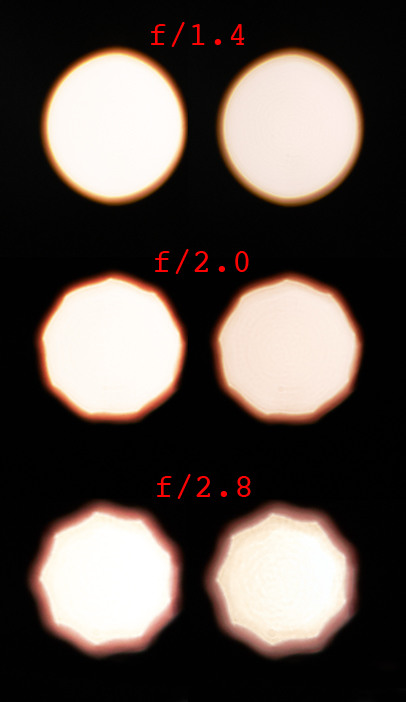

lct Posted October 21, 2019 Share #26 Posted October 21, 2019 15 hours ago, UliWer said: [...] With the Summilux asph you'll see a leap forward in all respects. [...] With some sharper bokeh around f/2.8 though. Welcome, dear visitor! As registered member you'd see an image here… Simply register for free here – We are always happy to welcome new members! 1 Link to post Share on other sites Simply register for free here – We are always happy to welcome new members! ' data-webShareUrl='https://www.l-camera-forum.com/topic/302578-fifties-from-the-fifties-vs-those-from-the-modern-day/?do=findComment&comment=3839713'>More sharing options...

jankap Posted October 21, 2019 Share #30 Posted October 21, 2019 58 minutes ago, lct said: With some sharper bokeh around f/2.8 though. Welcome, dear visitor! As registered member you'd see an image here… Simply register for free here – We are always happy to welcome new members! Please explain this picture. Left <-> right? Right onion rings? How did you produce these? Link to post Share on other sites More sharing options...

lct Posted October 21, 2019 Share #33 Posted October 21, 2019 (edited) 1 hour ago, jankap said: Please explain this picture. Left <-> right? Right onion rings? How did you produce these? Just a test i did 10+ years ago on a Maglite torch in a dark room. Left: 50/1.4 asph, normal contrast. Right: ditto with reduced contrast in PP. Another test hereafter. Above: 50/1.4 asph at f/2.8. Below: 50/1.4 v3 at f/2.8. FWIW. Welcome, dear visitor! As registered member you'd see an image here… Simply register for free here – We are always happy to welcome new members! Edited October 21, 2019 by lct 1 Link to post Share on other sites Simply register for free here – We are always happy to welcome new members! ' data-webShareUrl='https://www.l-camera-forum.com/topic/302578-fifties-from-the-fifties-vs-those-from-the-modern-day/?do=findComment&comment=3839785'>More sharing options...
jankap Posted October 22, 2019 Share #34 Posted October 22, 2019 Thank you, the difference is clear visible. Interesting. Link to post Share on other sites More sharing options...
