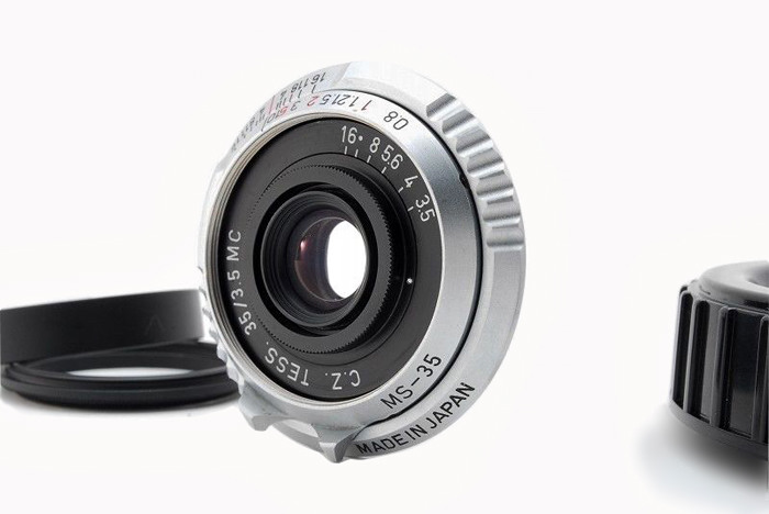

Adapted Carl Zeiss Tessar 35/3.5. Best LTM lens i've ever used. Perfect match with the Elmar-M 50/2.8. Hard to find unfortunately.
For what camera system was this lens made? Not familiar with it.

35/3.5 MS-Optics Perar: classic (low to medium contrast), questionable build quality
