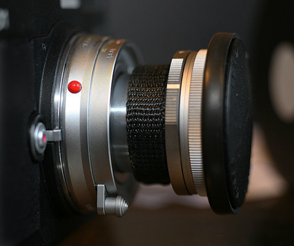

I have the lens and took some pictures.
The first shows the lens full extended on the CL - it really doesn't stick out that much.
When fully retracted, it's about 4mm past the adapter (middle photo) so I wouldn't use or mount it full retracted.
When it's retracted to be flush with the adapter, the lens sticks out very slightly. But you can't safely guesstimate this when mounting lens unless you stick a tape to prevent it full retracting (sounds ridiculous).
It's a great lens on the M or the CL, I would mount/carry it fully extended all the time, or if one must really want super compactness: carry CL and lens separately (full retracted) until need to use (then remember not to mount when fully retracted).

1 hour ago, g2van said:
Here are the abovementioned photos
I don't see any photos. But if the back of the lens extends past the mount adapter when fully retracted, that's enough to know that it should never be fully retracted when mounted on the CL.
Sorry, I'm having so many problems uploading. Hope this works now.
Piece of strap on my M6J's 50/2.8 for use on both Epson R-D1 and digital CL:
