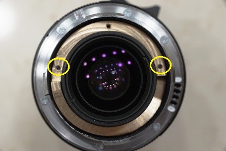

Now slightly loosen the two screws that lock the focus cam in place:

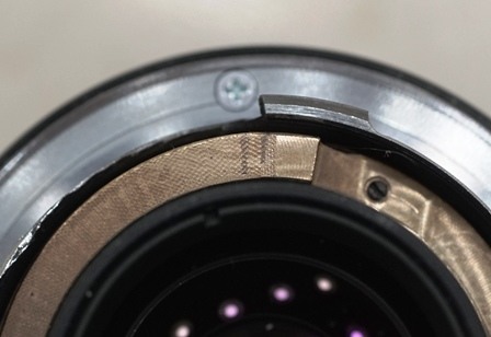

Then, holding the helical against the infinity stop, rotate the focus cam until the "RF" mark aligns with the edge of the bayonet tab:
