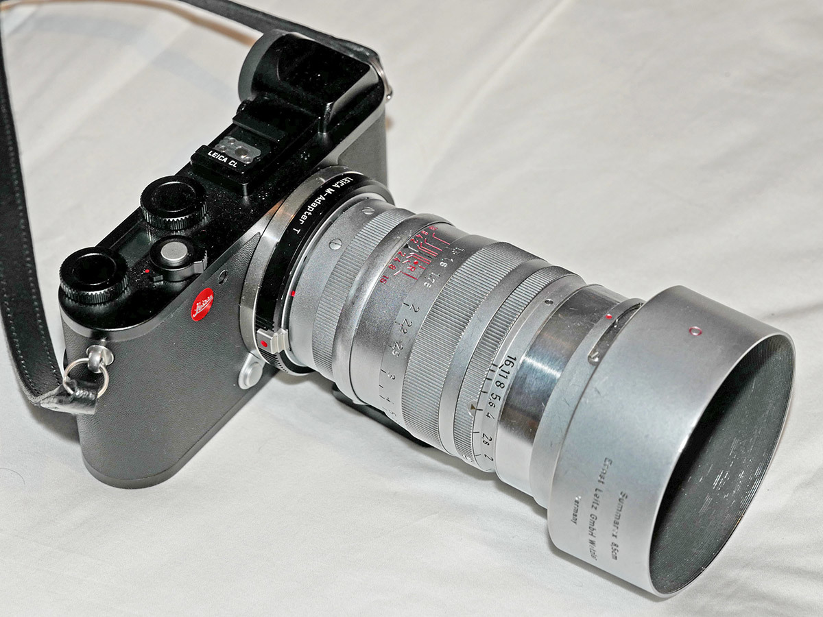

wlaidlaw Posted December 23, 2017 Share #22  Posted December 23, 2017 Just tried my Leica M adapter T /L with a 35 ASPH Summilux and the CL. To my surprise, auto-zoom, which did work with the cam-less R adapter T/L, does not work with the M adapter. You have to flick the right hand control wheel with a finger to get zoom. I have checked and auto-zoom is enabled. I will check whether you have to select manual focus on a menu to get this, but given that the camera immediately recognised the 35 Summilux when mounted, it would be surprising if you had to select manual focus. Does other folks' M adapters T behave like this?  Wilson Link to post Share on other sites More sharing options...

wlaidlaw Posted December 23, 2017 Share #24  Posted December 23, 2017 I have no experience with the R adapter T/L but auto zoom cannot work w/o transmission of focus information between the lens and the body IMHO.  It was my memory at fault. I thought the M adapter T/L auto-zoomed on the SL but I have just checked and it doesn't. It would not actually have been that difficult to implement at the design stage of the adapter. You would just need a photo-cell with an IR LED, which could detect movement of the RF collar.  Wilson 1 Link to post Share on other sites More sharing options...
