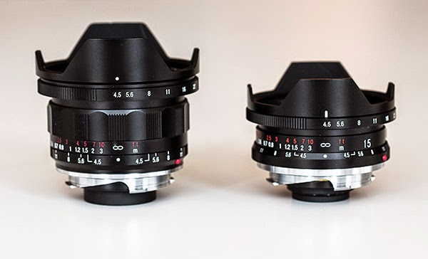

lct Posted November 4, 2017 Share #14 Posted November 4, 2017 How much bigger is v3 compared to M mount v2? Just curious. Link to post Share on other sites More sharing options...
adan Posted November 4, 2017 Share #15 Posted November 4, 2017 lct: v3 (left) is about the same diameter, but longer in length (more like an SLR lens in proportions) - which is of course how it gets rid of the color-stained edges. It has about the "feel" of the Leitz 21mm f/2.8 E60. http://4.bp.blogspot.com/-B-usVg-_cg4/VSppj6amKVI/AAAAAAAASA4/B-tMJ78ZRDo/s1600/ti01082118bl.jpg Link to post Share on other sites More sharing options...
jdlaing Posted November 4, 2017 Share #16 Posted November 4, 2017 How much bigger is v3 compared to M mount v2? Just curious. Not long enough that you can get your fingers in front of the lens. :-) Link to post Share on other sites More sharing options...
