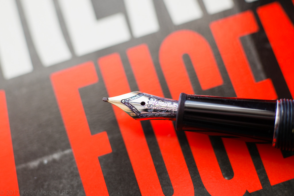

Keith (M) Posted August 25, 2017 Share #16 Posted August 25, 2017 M240, VF-2, R to M adaptor + 60mm Macro Elmarit-R combine to make (hand-held) close-up photography a delight. Welcome, dear visitor! As registered member you'd see an image here… Simply register for free here – We are always happy to welcome new members! 2 Link to post Share on other sites Simply register for free here – We are always happy to welcome new members! ' data-webShareUrl='https://www.l-camera-forum.com/topic/276000-m240-evf-options/?do=findComment&comment=3344938'>More sharing options...
