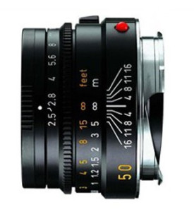

menos I M6 Posted February 26, 2010 Share #1 Posted February 26, 2010 Advertisement (gone after registration) I am interested in getting a very, compact 50mm next to my 50 Lux ASPH for daylight shooting. I am interested in: - best optical performance regarding flare and sagital aberrations wide open - compact size, rigid construction preferred - focus tab I have found no contemporary 50 Elmar 2.8 in the Leica lens line up, but I found 2 different versions at certain online dealers: 1) rigid (preferred) version with focus tab LeiCa � 50mm f/2.8 ELMAR-M ��� ��ͷ ��½�л�-�Ա��� price: apr. 950,- EUR new 2) collapsible version (without focus tab ? ) HKSupplies - Leica 50mm f/2.8 Elmar M in Black Finish price: apr. 800,- EUR new What is the history of these lenses? Where do they fit in the production time line? Can the collapsible version used without limitation on the M8.2 / M9 / EPSON R-D1 (I don't like to play with limitations of being not allowed, to change lenses only collapsed, taping tubes, etc.)? Am I overlooking something, but is this forum missing a genuine "lens forum" aimed at all camera makes and versions, without distincting between lens use on different bodies? I see a lot of threads with moderator comments of moving a topic to a certain Leica body forum? This makes no sense to me, as I use all my Leica M compatible lenses on all bodies of course. Link to post Share on other sites More sharing options...

jamesk8752 Posted February 26, 2010 Share #2 Posted February 26, 2010 The lens in your first photo looks like the Summarit-M 50 rather than the Elmar-M - it appears to have a maximum aperture of f2.5 rather than f2.8. If compactness and rigidity are important, I'd recommend the Summarit. IMO it has better performance wide open than the Elmar, and at 33mm in length, it's shorter than the extended Elmar, which is 38mm long. Bottom line - consider the Summarit-M 50. If you doubt its performance, read what Erwin Puts has to say about it. Regards, Jim Link to post Share on other sites More sharing options...
menos I M6 Posted February 26, 2010 Author Share #3 Posted February 26, 2010 Aah Jim - thanks a lot for your clear eyes ;-) How could I not see that ? Of course, the 50 Summarit looks very interesting, and being a half stop faster than the Elmar doesn't hurt either ;-) How is it about flare resistance (spoilt by the 50 Lux regarding this)? What is the going rate for used ones these days? Link to post Share on other sites More sharing options...
