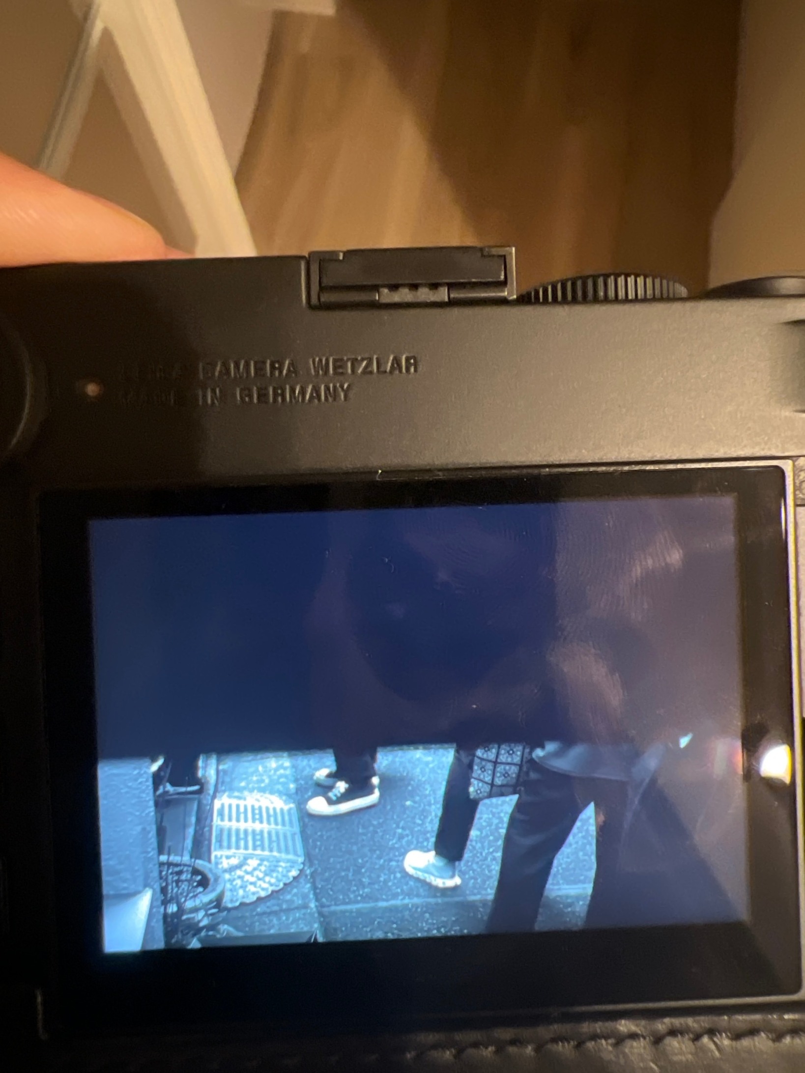

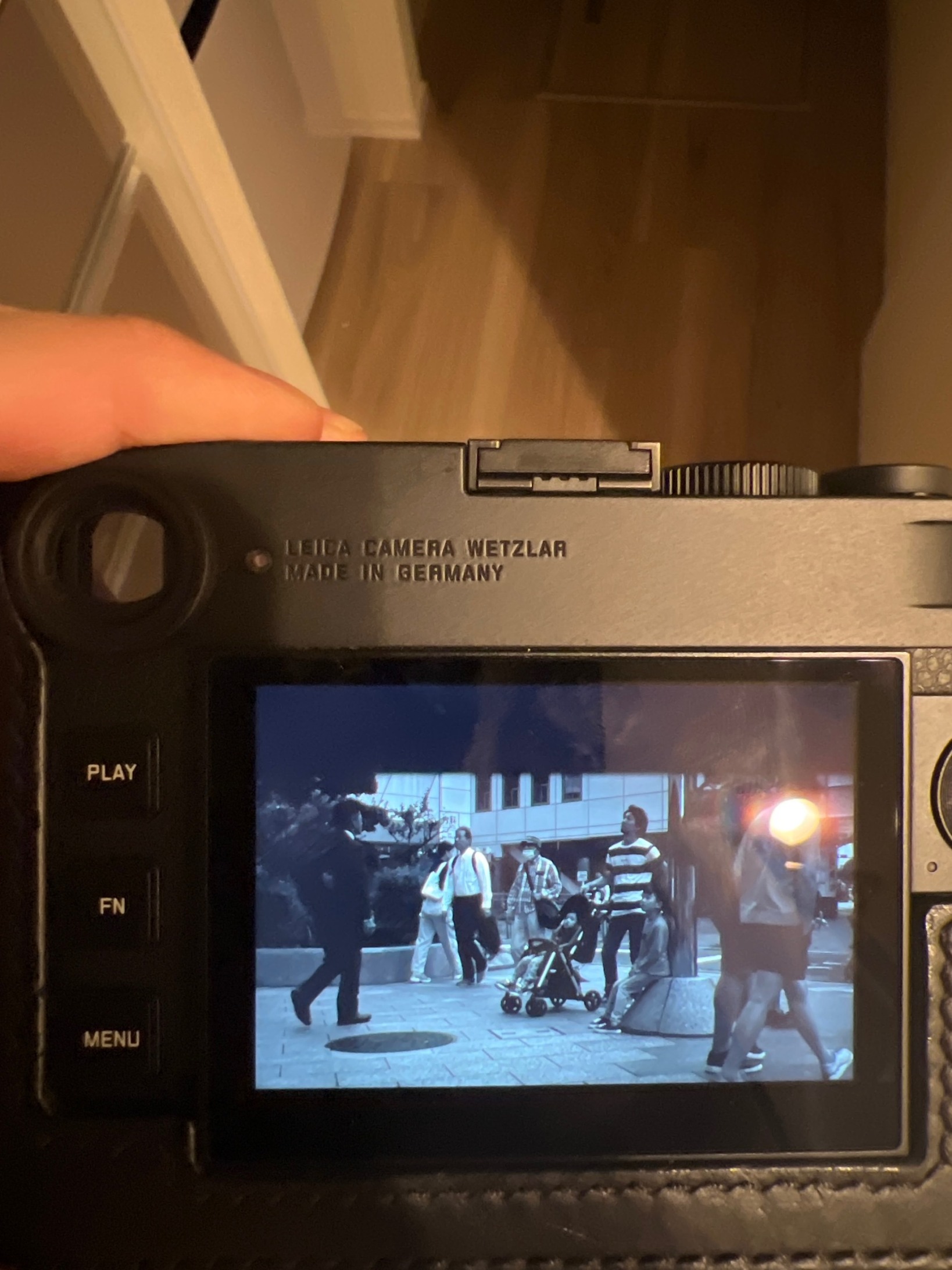

  3. I purchased my Leica M11 Monochrom in July of this year. I have updated it to the latest 2.0.1 firmware. The lens attached 100 percent of the time is the LLL 50 F2.0 ELCAN and it saves files to a UHSII 300MB/s Sandisk 128gb SD card. Recently while shooting continous low or high, after a certain amount of bursts, I see a partial or full screen black areas that appear on live view and in the DNG files. What could be the cause of this? I aim currently on holiday in Japan and am looking to have it serviced at their Ginza service center. They claim to be able to repair by replacing my shutter but will take three weeks. I would have to fly back into tokyo in three weeks time if what they say is true. Can I take their word for it that it will only take three weeks? I eagerly await your helpful comments and suggestions
