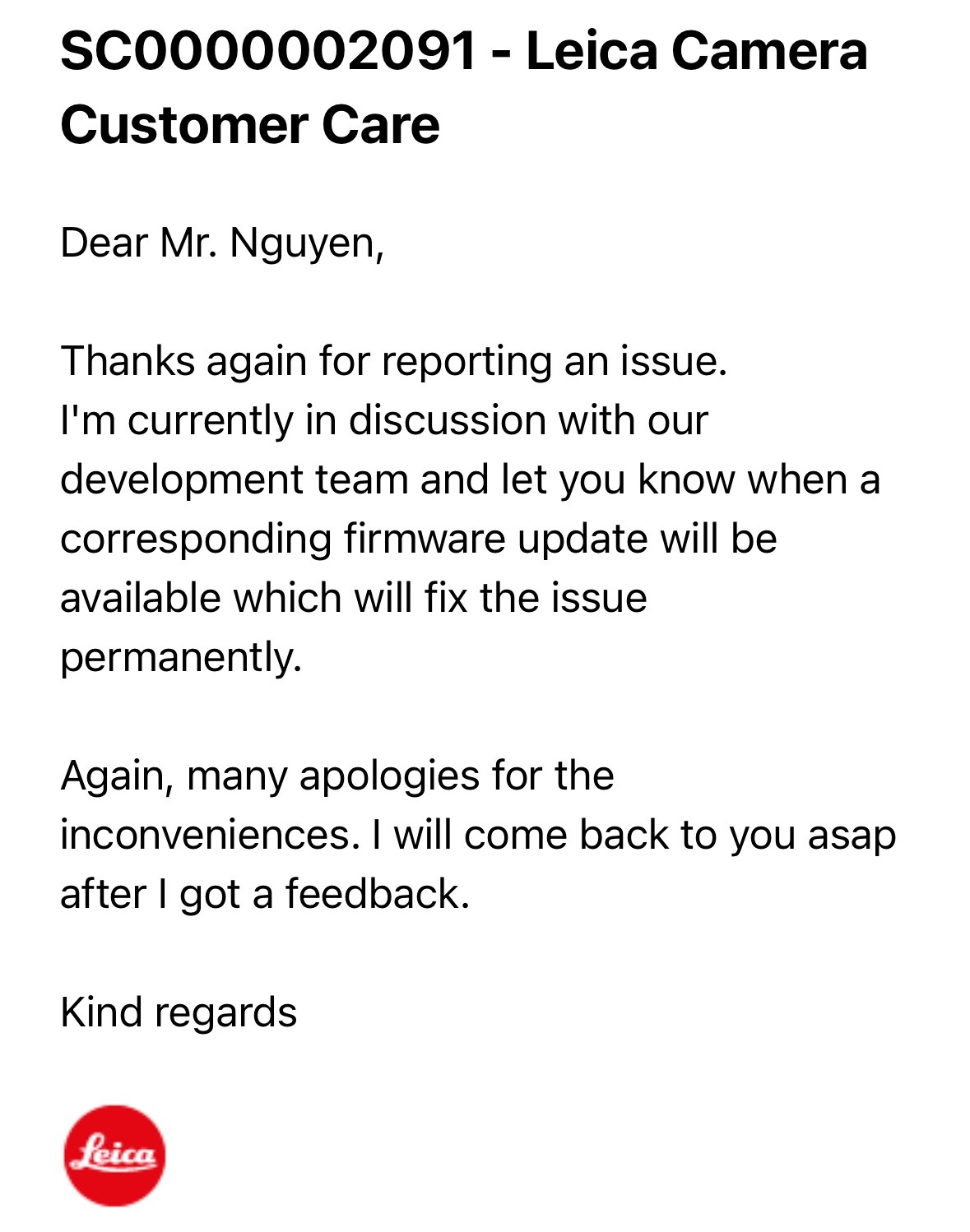

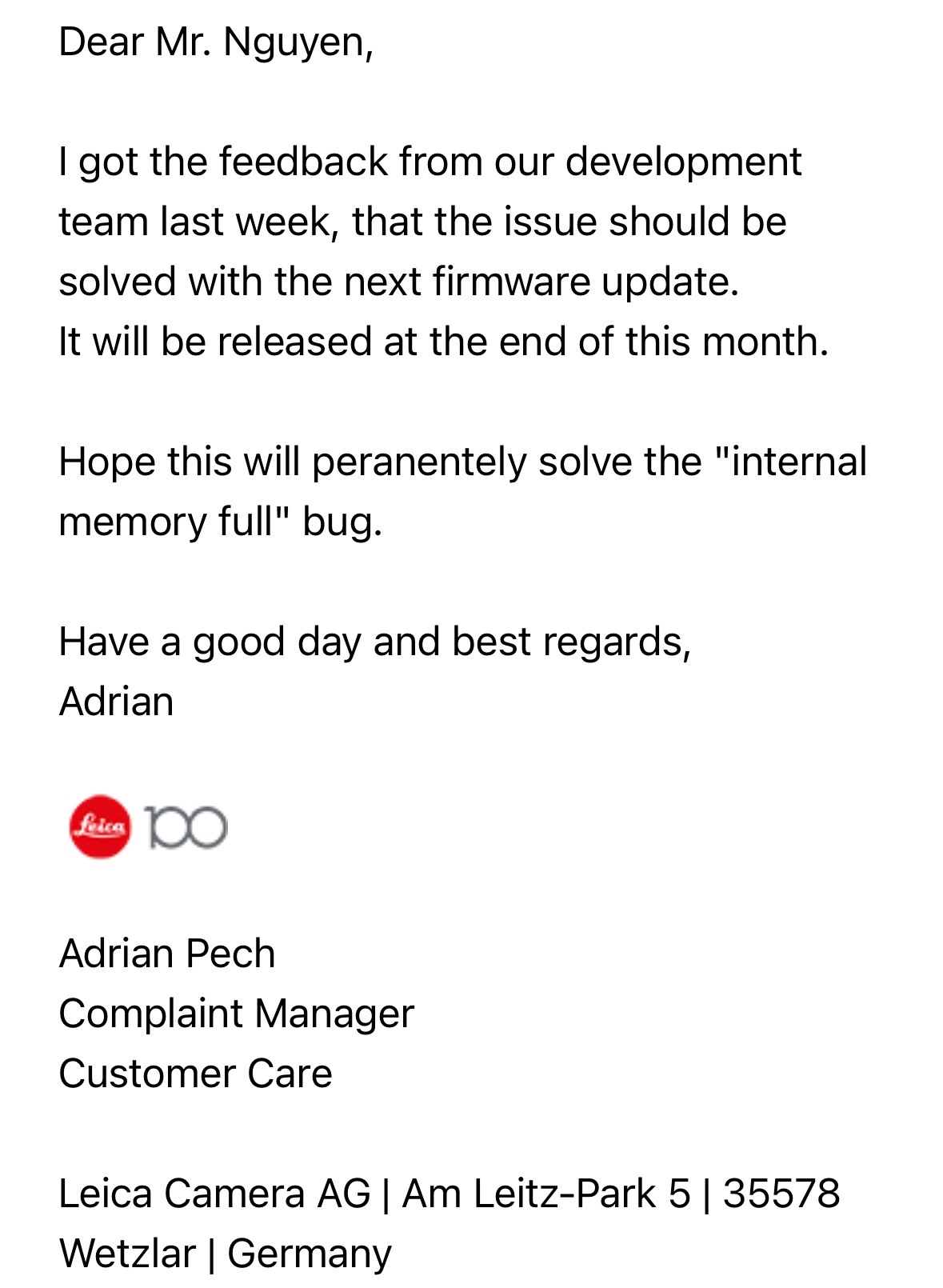

I filled a complaint and got reply by their Complaint manager.Hope it will be fixed in the next comming patch/firmware.
P/S: Been few days since i’ve stopped using FOTOS and my Leica doesn’t have any error so far.I don’t deny that FOTOS is a good app but let’s see.Before,with frequent using FOTOS,i got this error like 2-3 times per week.

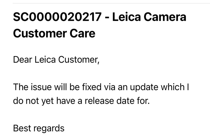

I’ve just receive this reply and wish for the best.
P/S: Previous post i mentioned about not using FOTOS for 1 week;it’s today.I haven’t got any error so far.My guess it may come from compatibility issue between FOTOS and the cam.
