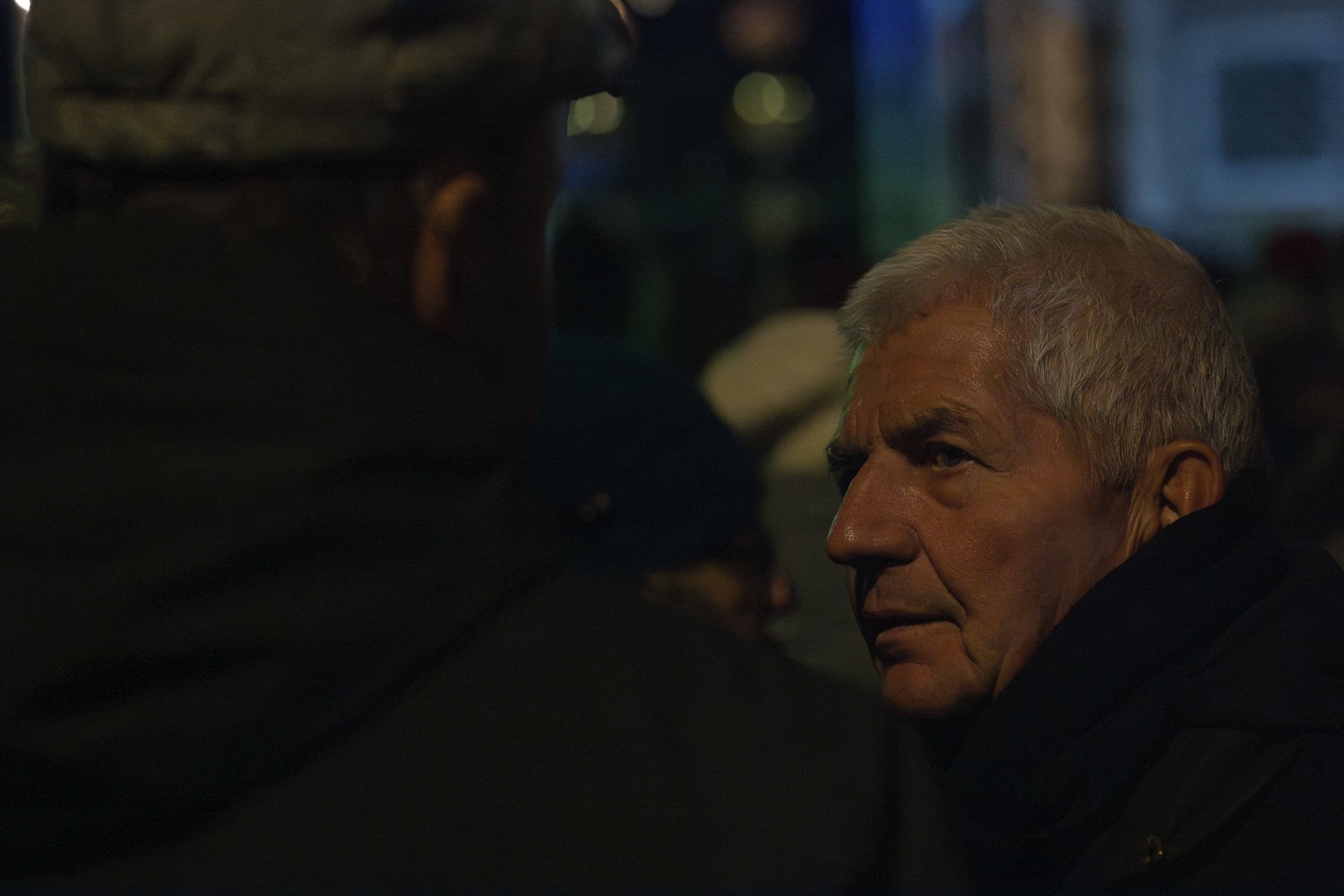

Chuck Albertson Posted December 27, 2024 Share #3  Posted December 27, 2024 This fella was underexposed at ISO 25000 by more than a stop, but I pulled him out of the darkness in Lightroom and ran the AI denoise on the image. At the Pussy Riot concert outside the old Stasi HQ in Berlin last month, SL2-S with 35 SLAPO.  Welcome, dear visitor! As registered member you'd see an image here… Simply register for free here – We are always happy to welcome new members! 3 Link to post Share on other sites Simply register for free here – We are always happy to welcome new members! ' data-webShareUrl='https://www.l-camera-forum.com/topic/418157-shooting-an-event-in-a-few-weeks-sl3-or-sl2-s-as-second-body/?do=findComment&comment=5729387'>More sharing options...

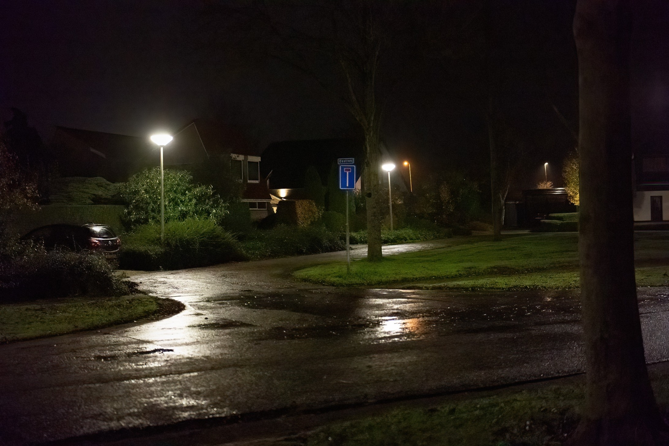

jaapv Posted December 27, 2024 Share #4  Posted December 27, 2024 I can get usable results on the SL2S @ ISO 100.000. Not just noise that the well-known noise reduction programs (LR Enhance, Topaz Photo AI, DXO) can handle and bring down to an acceptable level,, but the real bonus is that it retains colours excellently and still has a decent Dynamic Range. The camera can really see in the dark. Welcome, dear visitor! As registered member you'd see an image here… Simply register for free here – We are always happy to welcome new members!  2 1 Link to post Share on other sites Simply register for free here – We are always happy to welcome new members!  ' data-webShareUrl='https://www.l-camera-forum.com/topic/418157-shooting-an-event-in-a-few-weeks-sl3-or-sl2-s-as-second-body/?do=findComment&comment=5729388'>More sharing options...

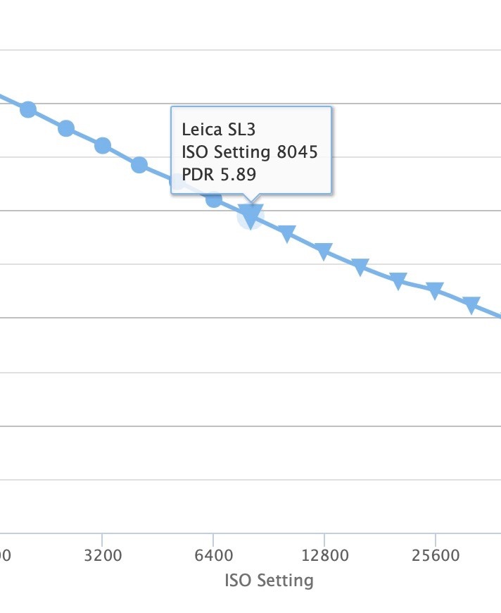

FlashGordonPhotography Posted December 27, 2024 Share #11  Posted December 27, 2024 Respectfully disagree. The SL3 is the equal of the SL2-S at high ISO’s, if you equalise the resolution. The current Sony 60MP sensor is easily the equal of the SL2-S. Sure if you compare at 100% pixel you’ll see some advantage to the SL2-S. But it’s not in the real world. I would not underestimate the convenience of two identical bodies. Gordon 1 Link to post Share on other sites More sharing options...

SrMi Posted December 27, 2024 Share #13 Â Posted December 27, 2024 11 hours ago, Chuck Albertson said: The SL2-S will give you significantly better images at high ISOs. I routinely shoot stuff at ISO 25000/50000 and, while a short cleanup is required in the noise aisle, the resulting images look great. I second Gordon's post: SL2-S is not better than SL3 at high ISOs (I own both). There is a difference between SL2-S and SL2. Link to post Share on other sites More sharing options...

hansvons Posted December 28, 2024 Share #17  Posted December 28, 2024 12 hours ago, FlashGordonPhotography said: True except the last one. Just set the SL3 to 18MP. But then you‘ll lose the downsample advantage of the 60MP sensor regarding noise.  23 hours ago, FlashGordonPhotography said: Respectfully disagree. The SL3 is the equal of the SL2-S at high ISO’s, if you equalise the resolution. Yes to the overall noise. However, the saturation/colour fidelity of the larger pixel-pitched sensor will be a better in the deep shadows. Link to post Share on other sites More sharing options...
SrMi Posted December 28, 2024 Share #18  Posted December 28, 2024 1 hour ago, hansvons said: 14 hours ago, FlashGordonPhotography said: True except the last one. Just set the SL3 to 18MP. But then you‘ll lose the downsample advantage of the 60MP sensor regarding noise. Regarding noise, setting it to 18MP is the same as downsampling it in the post to 18MP. 1 hour ago, hansvons said: On 12/27/2024 at 1:17 PM, FlashGordonPhotography said: Respectfully disagree. The SL3 is the equal of the SL2-S at high ISO’s, if you equalise the resolution. Yes to the overall noise. However, the saturation/colour fidelity of the larger pixel-pitched sensor will be a better in the deep shadows. I have not noticed that and don't see why the larger pixel-pitched sensor should have better saturation/color fidelity. SL2-S is an excellent camera, and it may do something better for the shadows, but that is not coming from larger pixels. Phase One IQ4 and Hasselblad X2D are known for excellent color fidelity and have the same pixel pitch as SL3. Link to post Share on other sites More sharing options...
hansvons Posted December 28, 2024 Share #19  Posted December 28, 2024 4 minutes ago, SrMi said: Regarding noise, setting it to 18MP is the same as downsampling it in the post to 18MP. I was of the impression that the SL3 sensor saves in its DNGs user-selectable full, half, or quarter resolving raw files off the sensor, which then get debayered in the editor of your choice to RGB, which allows for the decreasing file sizes/data. Thus, there is no downsampling from 60MP (full) to 18MP,  but regular debayering from 18MP raw to 18MP RGB. Do I miss here something? Link to post Share on other sites More sharing options...
SrMi Posted December 28, 2024 Share #20  Posted December 28, 2024 25 minutes ago, hansvons said: I was of the impression that the SL3 sensor saves in its DNGs user-selectable full, half, or quarter resolving raw files off the sensor, which then get debayered in the editor of your choice to RGB, which allows for the decreasing file sizes/data. Thus, there is no downsampling from 60MP (full) to 18MP,  but regular debayering from 18MP raw to 18MP RGB. Do I miss here something? The camera reads out the sensor at 60MP, and the firmware scales it down and un-demosaics it. Leica said that using 18MP is similar to downscaling to 18MP in the post (YT link @ 43:10). Initially, the marketing claimed that the DR of 18MP was higher, but that was incorrectly compared. Link to post Share on other sites More sharing options...
