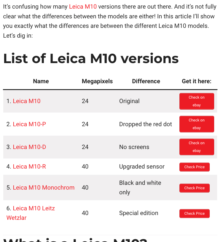

jaapv Posted May 14, 2024 Share #15 Posted May 14, 2024 38 minutes ago, Al Brown said: @Michele Cattani Sorry, just a silly thought - are you sure you do not have the M10-R? I am pretty sure your old firmware 10.20.27.20 was a firmware for the -R series from 2020 adding perspective control... In that case a different firmware update file 30.22.23.34 would be the proper one. I just cannot understand why the camera would not acknowledge the update otherwise... Maybe try downloading the update file I mentioned and try again, nothing can go wrong anyway. Welcome, dear visitor! As registered member you'd see an image here… Simply register for free here – We are always happy to welcome new members! Link to post Share on other sites Simply register for free here – We are always happy to welcome new members! ' data-webShareUrl='https://www.l-camera-forum.com/topic/394472-issues-with-the-firmware-update-on-leica-m10/?do=findComment&comment=5279250'>More sharing options...
UliWer Posted May 14, 2024 Share #16 Posted May 14, 2024 Yes, you are right. Though the link does in no way show any official list for firmware downloads. Michele, I can only advise that you double check which model you have. With a present firmware 10.20….it cannot be a „simple“M10 for which you downloaded the firmware. Better delete this download as it never will fit your camera. When you are really sure which model you have, go to the Leica website and look whether you really need an upgrade. Link to post Share on other sites More sharing options...

jaapv Posted May 14, 2024 Share #18 Posted May 14, 2024 1 hour ago, Al Brown said: This list is put together poorly and deficiently. M10 MONOCHROM Wetzlar is just a special edition and does not use own special firmware (nor does M10-R black paint, missing from here, M10-P Safari, missing from here, M10 Zagato, missing from here, M10-P Reporter, missing from here etc. etc.), but M10-P ASC 100 (also missing from here), even though a special edition, uses own firmware. Blame Red Dot cameras... Link to post Share on other sites More sharing options...
