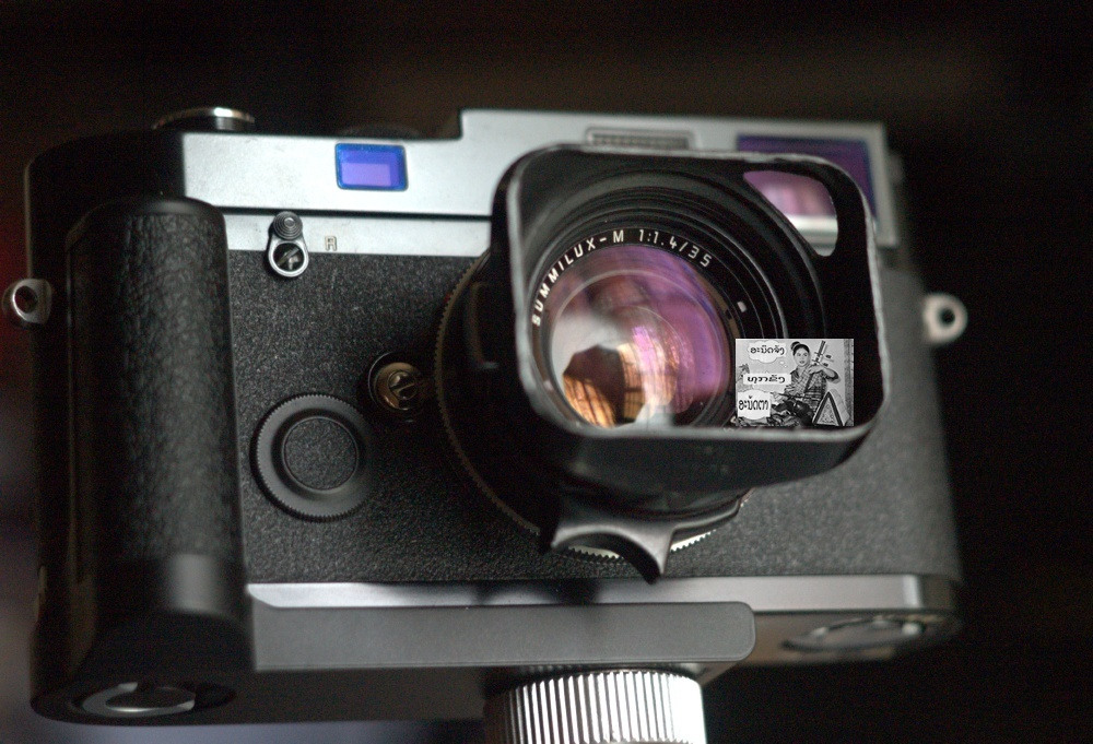

a.noctilux Posted March 17, 2024 Share #3  Posted March 17, 2024 As side note, the square plastic hood for 35mm is very good hood for some customization. I use one on my Summilux pre-asph 35mm, in use this vignettes at large aperture, so I filed the four corners, and made a hole for less VF hiding. Welcome, dear visitor! As registered member you'd see an image here… Simply register for free here – We are always happy to welcome new members! Link to post Share on other sites Simply register for free here – We are always happy to welcome new members! ' data-webShareUrl='https://www.l-camera-forum.com/topic/390980-summicron-35mm-asph-v1-attaching-a-uv-filter-inside-the-plastic-lens-hood/?do=findComment&comment=5107961'>More sharing options...

weatherproof Posted March 20, 2024 Share #14  Posted March 20, 2024 On 3/17/2024 at 2:43 AM, a.noctilux said: As side note, the square plastic hood for 35mm is very good hood for some customization. I use one on my Summilux pre-asph 35mm, in use this vignettes at large aperture, so I filed the four corners, and made a hole for less VF hiding. Welcome, dear visitor! As registered member you'd see an image here… Simply register for free here – We are always happy to welcome new members! Do you have a link to this hood? Does it freely rotate on the Summilux pre-asph?  (Sorry for reviving this thread.) Link to post Share on other sites More sharing options...

weatherproof Posted March 21, 2024 Share #17 Â Posted March 21, 2024 18 hours ago, lct said: The rectangular plastic hood shown above is either that of the Summicron 35/2 v4 (12524) or that of both Summicron 35/2 asph v1 and Elmarit 28/2.8 asph v1 (12526). Â Thanks! For some reason I thought it was an aftermarket hood. Seems like it has the possibility of rotating. Link to post Share on other sites More sharing options...
lct Posted March 21, 2024 Share #18 Â Posted March 21, 2024 1 hour ago, weatherproof said: Thanks! For some reason I thought it was an aftermarket hood. Seems like it has the possibility of rotating. If you mean the rectangular hood, not only it can but it will rotate if you don't stick it with some tape or otherwise. Also it will cause vignetting if you don't butcher it in the corners. Not a good idea if you ask me but the buyer is king... Link to post Share on other sites More sharing options...
pippy Posted March 21, 2024 Share #19 Â Posted March 21, 2024 (edited) 20 hours ago, lct said: The rectangular plastic hood shown above is either that of the......Elmarit 28/2.8 asph v1 (12526). None is made for the Summilux 35/1.4. For the latter, i would rather choose the superb (and expensive) 12504 vented hood or one of its almost as nice and much cheaper China made copies... +1. The 12504 hood (or copies thereof) is a great choice in one unusual respect... Oft-times I use colour-contrast filters even when shooting on 'the Colour Body' because almost everything I shoot as Personal Work ends up as a monochrome image. There are, however, the odd occasions where I will come across a scene which will only really 'work' in colour. In those instances - if I'm using a lens which can accept the hood with integrally-mounted Series VII filter - I can unclip the 12504 in a second rather than having to remove a hood; unscrew a filter; re-attach the hood and reverse these actions once the snap has been taken. FWIW I also did a comparison test which included the 12526 amongst the hoods selected. It had mimimal finder-blockage but not as little as the regular 12585 and, yes, it rotated!... Philip. Edited March 21, 2024 by pippy 1 Link to post Share on other sites More sharing options...
a.noctilux Posted March 22, 2024 Share #20 Â Posted March 22, 2024 On 3/20/2024 at 10:09 PM, weatherproof said: Does it freely rotate on the Summilux pre-asph? No I put a rubber ring around the lens groove to prevent the hood's rotation. Link to post Share on other sites More sharing options...
