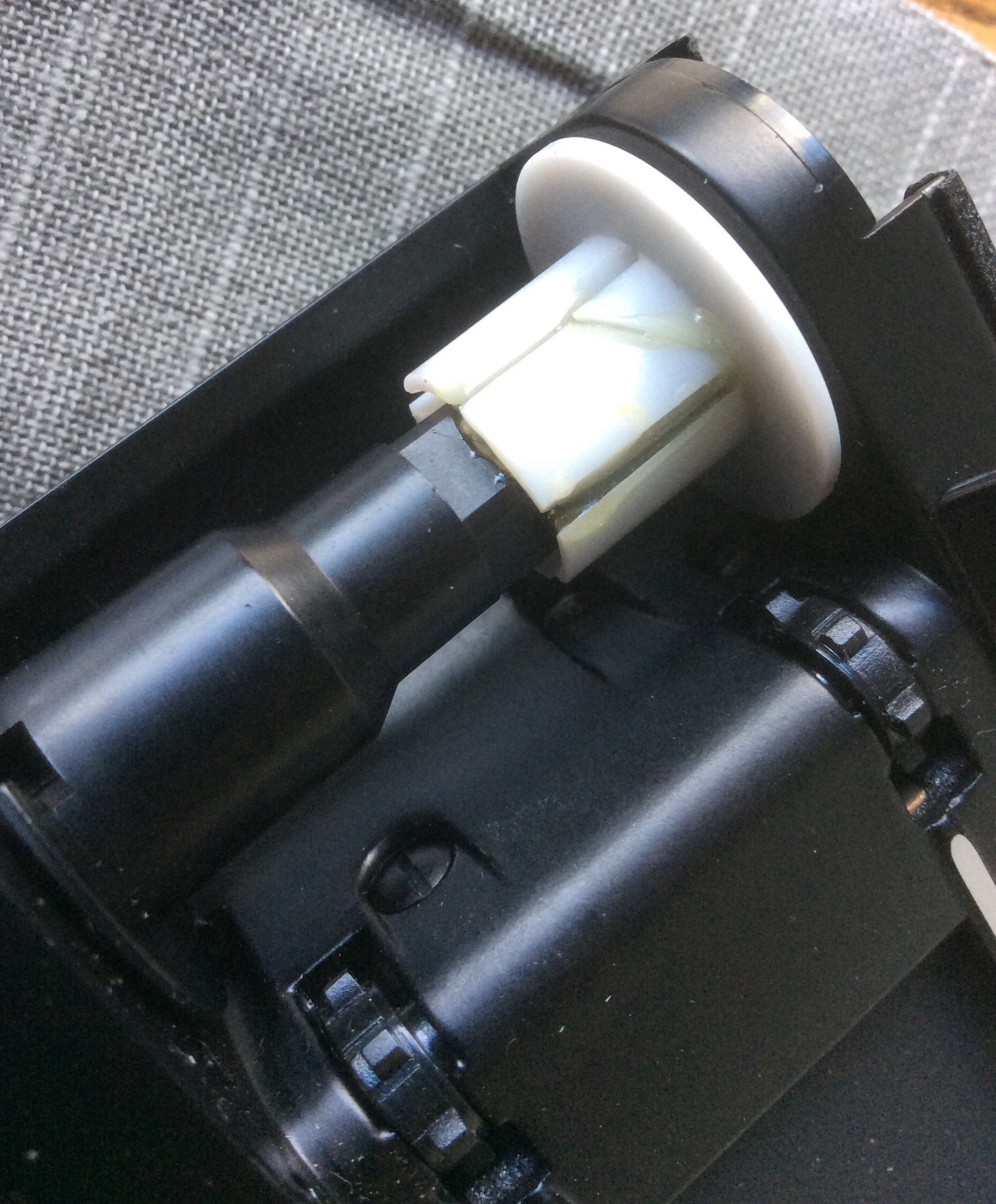

The plastic bits of the take up spool that you clip the film under can break off after time. That happened to this one and the film was then free wheeling without winding onto the spool. I glued back the one leaf that had broken ( it was loose inside the camera) and now add a bit of masking tape as well to fix the film to the takeup spool. There is someone selling replacement spools who says they are easy to fit, but I have read on the forum that you have to take a lot of the camera apart to fit a new spool. The same would apply to the M5 spool.

The CL has some particular vulnerabilities. A broken takeup spool is one of the commonest (there is a reason why other Leicas use metal). They realised there was a problem and added a brass bush to later CL spools. The electromechanical light meter is often dead or inaccurate at this point. The CdS cell has a much more limited lifespan than the silicon cell used in cameras like the M6 and degrades over time, leading to loss of sensitivity. The coil can stick and the mechanical linkages can be disrupted by a knock. The rangefinder prism is 'silvered' with aluminium, which can also degrade. If left too long between services, the unlubricated shutter gears can seize up completely. The viewfinder is glued in position by epoxy resin, and if this cracks it can fall out.
On the plus side there are technicians who can restore them to fully working condition - I think DAG and Cameraworks UK still work on them. Sadly Peter Grisaffi, author of the link above, is no longer with us.

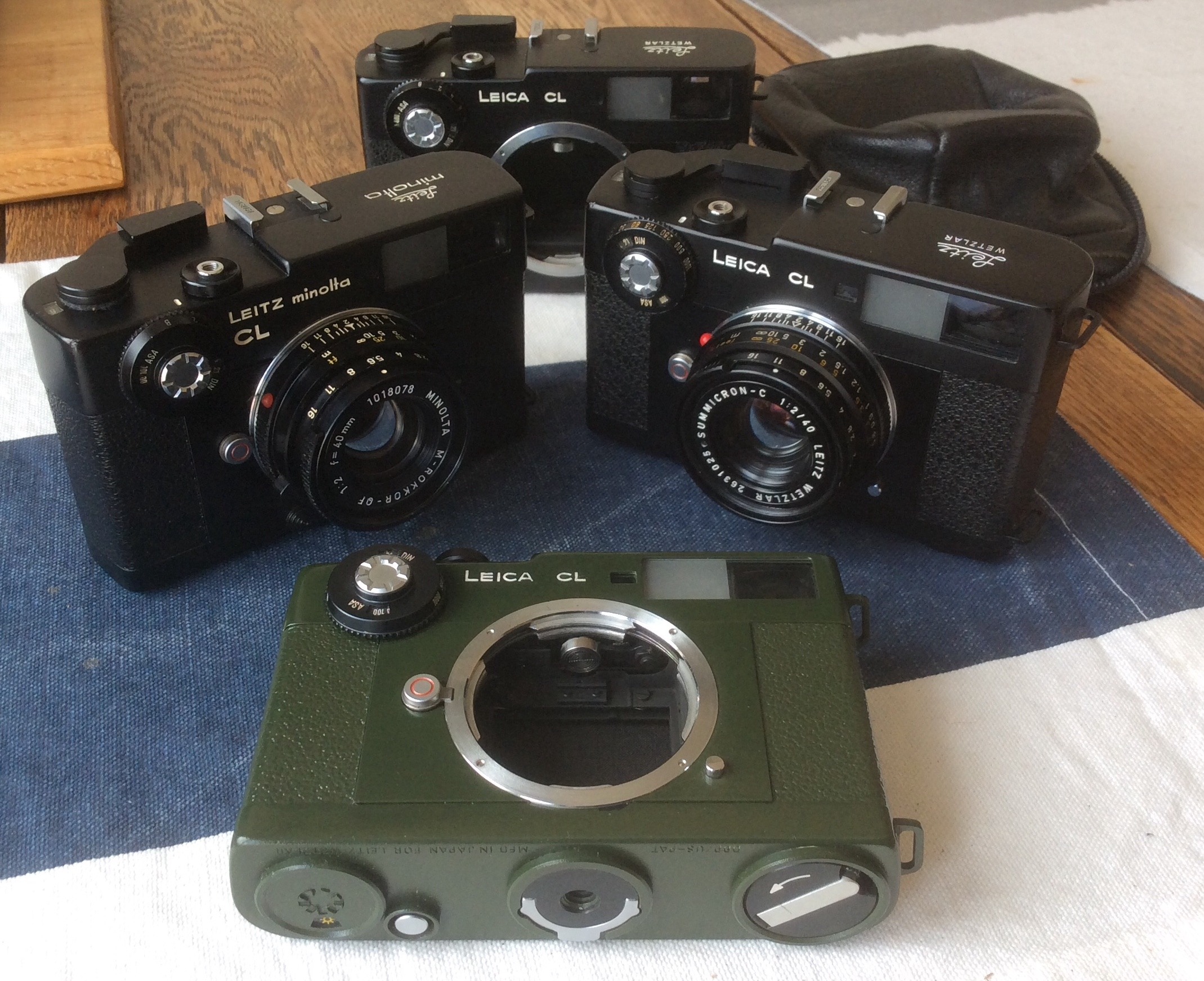

The camera inside is made of cost saving materials (compared to other M Leicas), some space saving build solutions are present and once you open it you start realizing how fragile the interior actually is... definitely not for professional use because many things can go wrong even at the smallest force or impact...
Check the interior of a CL I repaired yourselves:
