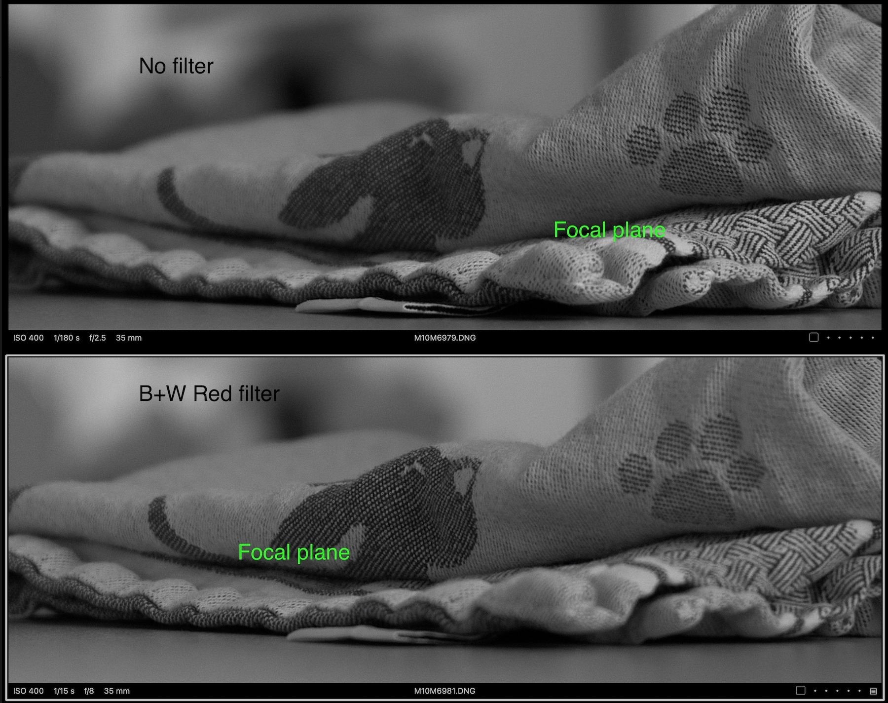

As I said, I shoot with the M10 Monochrome and as such, I love to use orange and red filters for dramatic contrast and dark skies. This is one of the main use-cases for shooting a B&W sensor, to me. It is known that color filters, especially in the red spectrum, can cause focus shift. I have not encountered this phenomenon in my modern lenses, so I was under the impression this is more an issue for vintage lens designs. As it turns out, the Summarit 35mm exhibits EXTREME Focus shift with red and orange filters
At first I thought I must have made a mistake but I was able to replicate this phenomenon numerous times in controlled conditions. I focus on an object, take an image, add the orange filter without touching the lens and repeat, do the same with a red filter. You can clearly see the focal plane creep away from the sensor. Less so with orange, quite significantly with red. This makes shooting the Summarit 35mm with an orange filter permanently attached (as I like to do) AND using the rangefinder to focus almost impossible. Keep this in mind if you shoot B&W sensors or even worse film! I will need to stick with the LCD for these instances, which is a real bummer.
The Voigtländer 35mm does not exhibit this behaviour in a noticeable extend, so I assume this has to do with the Summarit not being properly corrected for red-shifted light (again, only 6 elements).

This cannot be. You are not seeing focus shift due to colour focus variation because if this was the case then colour photographs would exhibit significant flaws too because red objects would appear fuzzy from your description (and this is not so!). I'd say this is much more likely due to a filter issue - the thickness of the filter you are using - and not the lens.

Behold what cannot be.
I did not move the camera or change the focus.
The filters used are B+W light red and Heliopan Slim Orange (doesn't get thinner than those).

Disclaimer: I honestly do not know the cause for this.

I’m not disagreeing with the shift, just the reason. At a guess I’d suggest that the Summarit is sensitive to filters with varying thickness of filter glass perhaps? What it will not be is the colour as this would show up on B&W and colour sensors. One way to check this would be to focus then position the filters some way in front of the lens and see what effect this has. My Summarit has a Leica UV filter which shows no discernible focus shift that I’ve noticed so I would think that your filters are the cause, but not the colour of them.
I actually did that and did not find a difference.
Also, there is really no thinner filters than the ones I am using, so for all intents and purposes this effect is inevitable for the Summarit 35mm.
Posts like this and this one lead me to believe the correction for red might be at fault. The common denominator with my experiences is the shift towards infrared light becoming dominant when going from none to orange to red in increasing order of magnitude. Infrared is simply negligible when shooting normal or in colour, hence the problem is not apparent.
It could be an IR component but testing to find out could be messy. But I very much doubt that its visible light because it would show up as softness around red subject matter if it was.

My filters don't shift focus on my copy. I would think that perhaps the lens’ retro-focus design (I assume that, don't know it) may be sensible to filter thickness and distance to the front lens. I would think that attributing this to the coatings being less/more sensible to red light is unlikely as this would be visible in regular, non-filtered images. However, I read that IR filtering can cause focus shifts. Perhaps you are up to something.

I would also like to amend my earlier comment about orange filters. Indeed, the focus shift with the red filter is too significant for me to rely on the viewfinder. However, with the orange filter I can get away with it almost all of the time, even close up and wide open. The focus shift with orange is just not that significant
