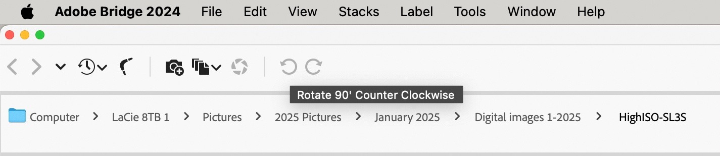

When I had this happen to me I took a few steps.  I use Capture One for my normal workflow, so I verified the files on the SD using other tools.  The images were inverted.  I put the SD card back into the camera, and the same images were inverted.
For my case, it is clear that it happened at the time I captured the image.
It has not happened since.
