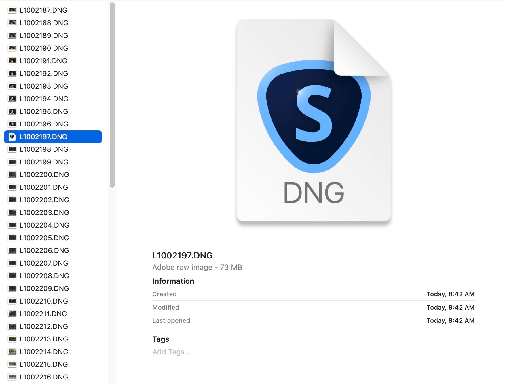

Eesand Posted November 4, 2023 Share #1 Posted November 4, 2023 (edited) Advertisement (gone after registration) Using proper so card, and after upgrade, shooting in dng mode only, the first click after powering the camera up produces a corrupt dng file, both m11 and m11m. Only the first click all others just fine. I wonder whether power up takes longer or something. Anyone else? Given it doesn’t do it every time, I am guessing about it not being quite ready even though it seems to be. Likely sometimes after power up and first click will be a longer time, naturally thanks! Edited November 4, 2023 by Eesand 1 Link to post Share on other sites More sharing options...

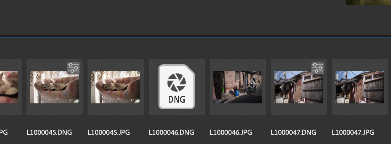

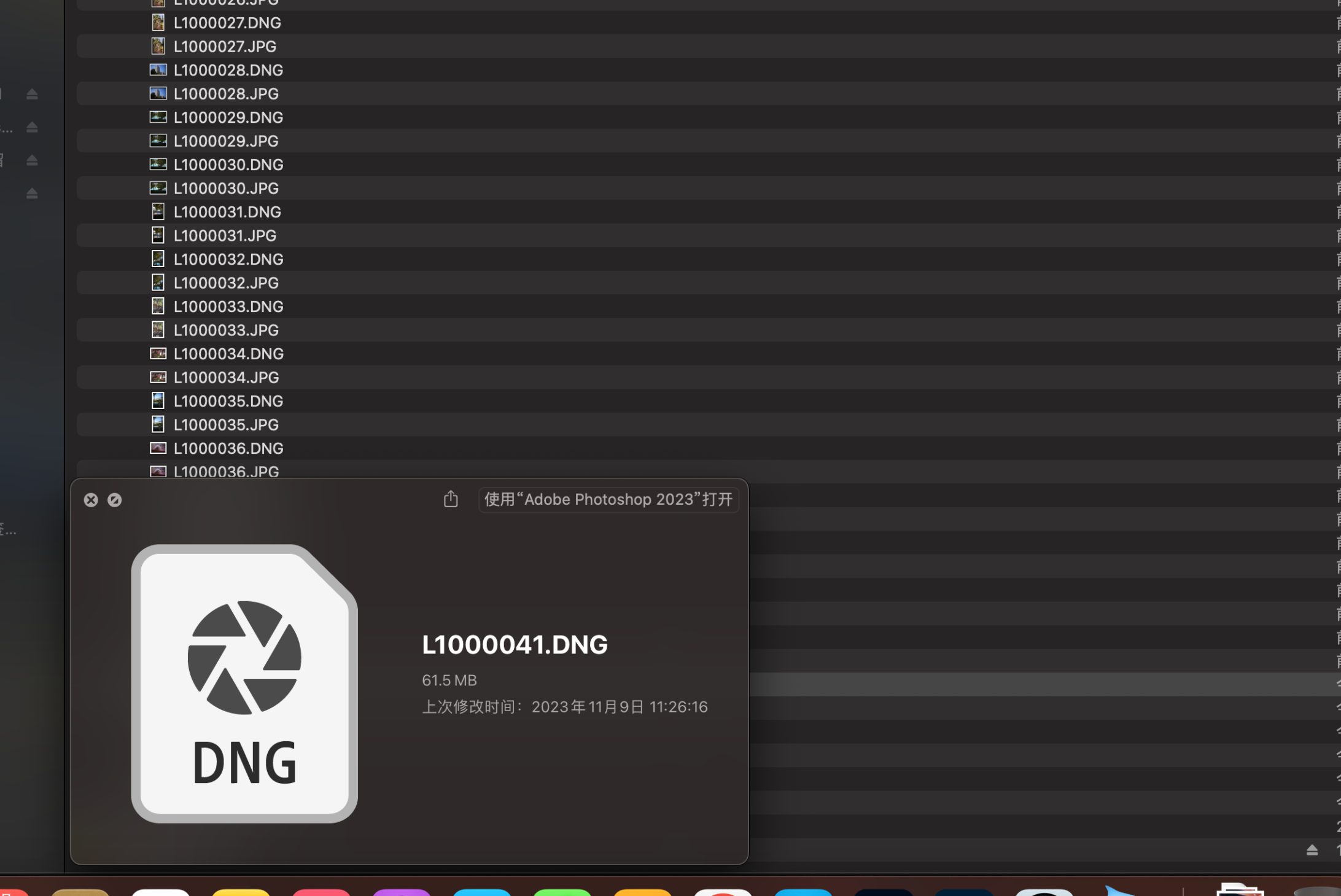

hjddd Posted November 6, 2023 Share #10 Posted November 6, 2023 I just had the exactly same problem using M11-P 2.0.1. The file size is good , but no readable. Link to post Share on other sites More sharing options...
