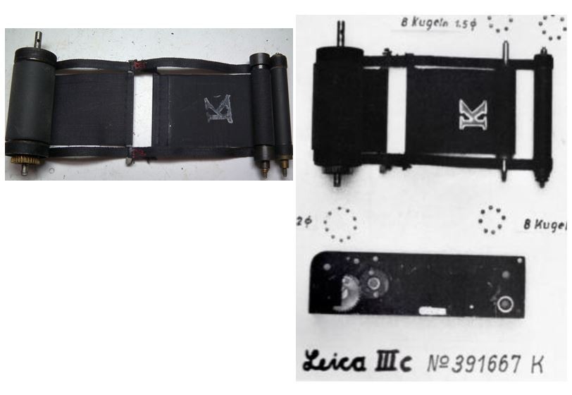

jerzy Posted February 20, 2022 Share #8 Posted February 20, 2022 vor 8 Stunden schrieb willeica: The curtain that is visible when the camera is unwound sorry William, but I think that this is opening curtain that is stamped, opening curtain is visible when camera is wound. Left is K shutter that i had on my table some time ago, right is a copy from literature Welcome, dear visitor! As registered member you'd see an image here… Simply register for free here – We are always happy to welcome new members! Link to post Share on other sites Simply register for free here – We are always happy to welcome new members! ' data-webShareUrl='https://www.l-camera-forum.com/topic/329884-wartime-leica-iiic-k/?do=findComment&comment=4387181'>More sharing options...

willeica Posted February 20, 2022 Share #10 Posted February 20, 2022 49 minutes ago, jerzy said: sorry William, but I think that this is opening curtain that is stamped, opening curtain is visible when camera is wound. Left is K shutter that i had on my table some time ago, right is a copy from literature Welcome, dear visitor! As registered member you'd see an image here… Simply register for free here – We are always happy to welcome new members! Thanks Jerzy. I am sure you are right. However, my IIIcK, which is genuine and was checked out with Archives, has a faint K on the curtain when unwound. No K when wound. While we are discussing this, my grey IIIc (no K) was described by the Archives as having gone to the Luftwaffe, but it is not in Cane's list. I discussed it with Jim Lager and we both agreed that it had gone to Berlin, but there was no evidence that the destination was military. Here are the two cameras together, IIIcK in front. I did not buy the IIIcK as a military camera, but it had been sold before as a military camera. My grey IIIc came with a flash base which has to be removed and replaced before it can be used. This does not bother me as I got that camera for an 'attractive' price. For what it is worth, I don't collect military cameras, but I know that a lot of other collectors like to do this. My only other war-time IIIc is a chrome one with a red shutter. I feel that I have covered that period with my 3 IIIcs. William Link to post Share on other sites More sharing options...

jerzy Posted February 20, 2022 Share #13 Posted February 20, 2022 vor 6 Stunden schrieb willeica: However, my IIIcK, which is genuine and was checked out with Archives, has a faint K on the curtain when unwound. apology William for I correcting you before but until now I saw it only on opening, you never learn out 🙂 1 Link to post Share on other sites More sharing options...
jerzy Posted February 20, 2022 Share #14 Posted February 20, 2022 vor 7 Stunden schrieb doctorlebel: The Leica IIIf RD has 12-1mm balls in the main drum race IIIf has alltogether 4 bearings: the one your mentioned above, another one on upper part of main drum (it is in a cage) and additionally 2 bearings for one gear (one bearing visible on the photo below) within film transport. Reason for having 2 bearings there is that this gear rotates when the first curtain travels, any obstacle impacts exposure time Welcome, dear visitor! As registered member you'd see an image here… Simply register for free here – We are always happy to welcome new members! IIIcK have additionally 3 bearings on small drums (one drum has only one bearing). But not every K ist the same - WH series have additionaly bearings on wind and rewind Link to post Share on other sites Simply register for free here – We are always happy to welcome new members! IIIcK have additionally 3 bearings on small drums (one drum has only one bearing). But not every K ist the same - WH series have additionaly bearings on wind and rewind ' data-webShareUrl='https://www.l-camera-forum.com/topic/329884-wartime-leica-iiic-k/?do=findComment&comment=4387468'>More sharing options...
