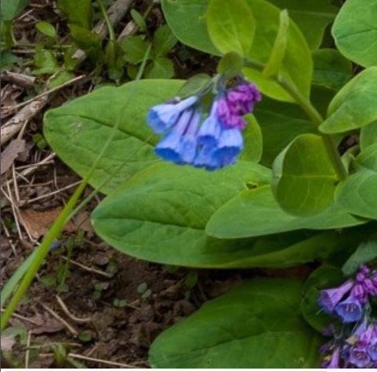

SoarFM Posted April 5, 2022 Share #411 Posted April 5, 2022 (edited) This is my unscientific explanation. As resolution increases, and with exceptional lenses, out of focus areas are more apparent, especially while in pixel peeping mode. This is why landscape photographers are focus stacking. While f 5.6 or f8 with a 35mm or 50mm lens could once be considered to have a significant zone of focus area, with a 60 megapixel image that zone is apparently narrower. Today I went for a walk with my M11, no tripod. I am not as steady as most of you since a spinal cord injury 13 years ago. In fact I use hiking poles quite often on walks of any distance off paved paths. I took some pictures handheld using 1/4f shutter speeds. They are unmistakably "sharp" in the zone of focus, which is quite narrow even at f5.6 or f8. The idea that an M11 can't be successfully focused handheld is just not so, even in my case, which is that of a sometimes wobbly 62 year old, even while stooped over. Welcome, dear visitor! As registered member you'd see an image here… Simply register for free here – We are always happy to welcome new members! M11 35-APO ~f8.0 Edited April 5, 2022 by SoarFM 1 Link to post Share on other sites Simply register for free here – We are always happy to welcome new members! M11 35-APO ~f8.0 ' data-webShareUrl='https://www.l-camera-forum.com/topic/329865-problems-getting-sharp-images-by-60mp/?do=findComment&comment=4412812'>More sharing options...
lct Posted April 5, 2022 Share #412 Posted April 5, 2022 Focusing issue? The ground looks sharper than the flowers. Welcome, dear visitor! As registered member you'd see an image here… Simply register for free here – We are always happy to welcome new members! Link to post Share on other sites Simply register for free here – We are always happy to welcome new members! ' data-webShareUrl='https://www.l-camera-forum.com/topic/329865-problems-getting-sharp-images-by-60mp/?do=findComment&comment=4412815'>More sharing options...
SoarFM Posted April 5, 2022 Share #413 Posted April 5, 2022 1 hour ago, lct said: Focusing issue? The ground looks sharper than the flowers. Welcome, dear visitor! As registered member you'd see an image here… Simply register for free here – We are always happy to welcome new members! Ok, well maybe you should go to a portion of the frame where the zone of focus occurs. You chose the lower front left corner of the frame, which might have been useful had I been taking a picture of a brick wall. Probably start about 1/3 of the way in is my suggestion. Link to post Share on other sites More sharing options...
lct Posted April 5, 2022 Share #414 Posted April 5, 2022 (edited) Sorry but i'm just trying to understand. At what subject distance were you focusing? Or were you zone focusing? Edited April 5, 2022 by lct Link to post Share on other sites More sharing options...
SoarFM Posted April 5, 2022 Share #415 Posted April 5, 2022 (edited) 2 hours ago, lct said: Sorry but i'm just trying to understand. At what subject distance were you focusing? Or were you zone focusing? Every time you focus, there is a resulting zone of focus, more commonly referred to as depth of field. I'm sure I confused the discussion by referring to it otherwise. This whole thread was started on the premise that nothing is in focus when people are trying to shoot handheld with their 60mp camera without IBIS. IBIS buys you a couple stops, that's all, the alternative being using 2 stop higher ISO and a faster shutter speed in place of IBIS has imperceptible or nonexistent impact on the image in almost all situations. Higher resolution requires a steadier hand or a higher shutter speed, that's the bottom line. I am focusing an M11 handheld and getting sharp results using the range of 28mm-75mm. I use 1/4f and it works great. Today I used the Visoflex so I could focus with the camera low to the ground. Usually, I just use the rangefinder. Edited April 5, 2022 by SoarFM 1 Link to post Share on other sites More sharing options...
lct Posted April 5, 2022 Share #416 Posted April 5, 2022 The zone of focus you're referring to is not the same if you focused say at 2m or at 5m, right? Assuming you focused at 3m, your zone of acceptable sharpness was between 2m and 7m more or less on the basis of average circle of confusion values. This has nothing to do with IBIS or camera shake of course. At 1/(4f) and 35mm it would be a pity if the M11 was not able to take normally sharp photos. 1 Link to post Share on other sites More sharing options...
aristotle Posted April 5, 2022 Share #417 Posted April 5, 2022 11 hours ago, SoarFM said: While f 5.6 or f8 with a 35mm or 50mm lens could once be considered to have a significant zone of focus area, with a 60 megapixel image that zone is apparently narrower. Depth of field isn't affected by sensor resolution. If you enlarge an image from a 60MP sensor more than you would from a 24 MP sensor, the depth of field will be more compresed. But that's just a function of how much it was enlarged, not a function of the sensor resolution. 1 Link to post Share on other sites More sharing options...
