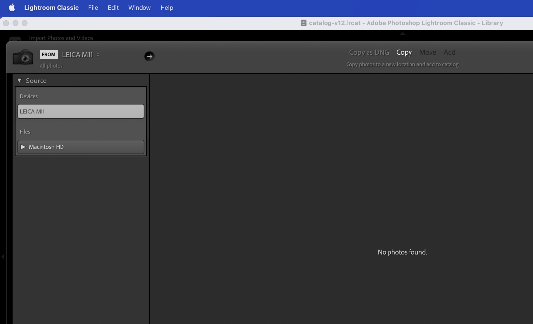

digitalfx Posted January 15, 2022 Share #24 Posted January 15, 2022 Im on a M1X Mac and the trick in post 1 is not working...I assume this is because im on Apple Silicon. I can make a data transfer from Camera to MBP in Lightroom using a TB4 cable but the thumbnails are all blank, so my transfers are blind. But via Finder and Android Transfer I get the warning "Cant access device storage" 1 Link to post Share on other sites More sharing options...
SrMi Posted January 15, 2022 Author Share #25 Posted January 15, 2022 16 minutes ago, digitalfx said: Im on a M1X Mac and the trick in post 1 is not working...I assume this is because im on Apple Silicon. I can make a data transfer from Camera to MBP in Lightroom using a TB4 cable but the thumbnails are all blank, so my transfers are blind. But via Finder and Android Transfer I get the warning "Cant access device storage" Post #1 was tested on M1 Mac Mini. Yes, the thumbnails are all blank, maybe because LrC does not support M11 officially. Once you import, the thumbnails look fine. I have also started getting "Can't access device storage" recently when trying to use Android Transfer. Will investigate. Link to post Share on other sites More sharing options...
digitalfx Posted January 15, 2022 Share #26 Posted January 15, 2022 5 minutes ago, SrMi said: Post #1 was tested on M1 Mac Mini. Yes, the thumbnails are all blank, maybe because LrC does not support M11 officially. Once you import, the thumbnails look fine. I have also started getting "Can't access device storage" recently when trying to use Android Transfer. Will investigate. Yea, I can import fine in LR...just have no idea what im importing. RE: The error in finder...I think its waiting on the "phone" to confirm the transfer...sine we are using a M11 instead of an actual Android thats obviously not possible. If you watch the Android Transfer videos, you have to confirm a few steps on the phone before transferring files. The error seems to be a timeout waiting on this confirmation Link to post Share on other sites More sharing options...
digitalfx Posted January 16, 2022 Share #27 Posted January 16, 2022 Advertisement (gone after registration) Finally got USB-C connection working. If I open LR and put it in import mode, then connect the camera to my MBP via TB3 cable I get the Android Transfer dialog box to pop up and display contents on both internal memory and SD card on M11. I still get the warnings, but if I ignore them I can drag the files to an open Finder window Link to post Share on other sites More sharing options...
SrMi Posted January 16, 2022 Author Share #28 Posted January 16, 2022 13 minutes ago, digitalfx said: Finally got USB-C connection working. If I open LR and put it in import mode, then connect the camera to my MBP via TB3 cable I get the Android Transfer dialog box to pop up and display contents on both internal memory and SD card on M11. I still get the warnings, but if I ignore them I can drag the files to an open Finder window If you quit Android Transfer, you should be able to import directly from the camera. Link to post Share on other sites More sharing options...

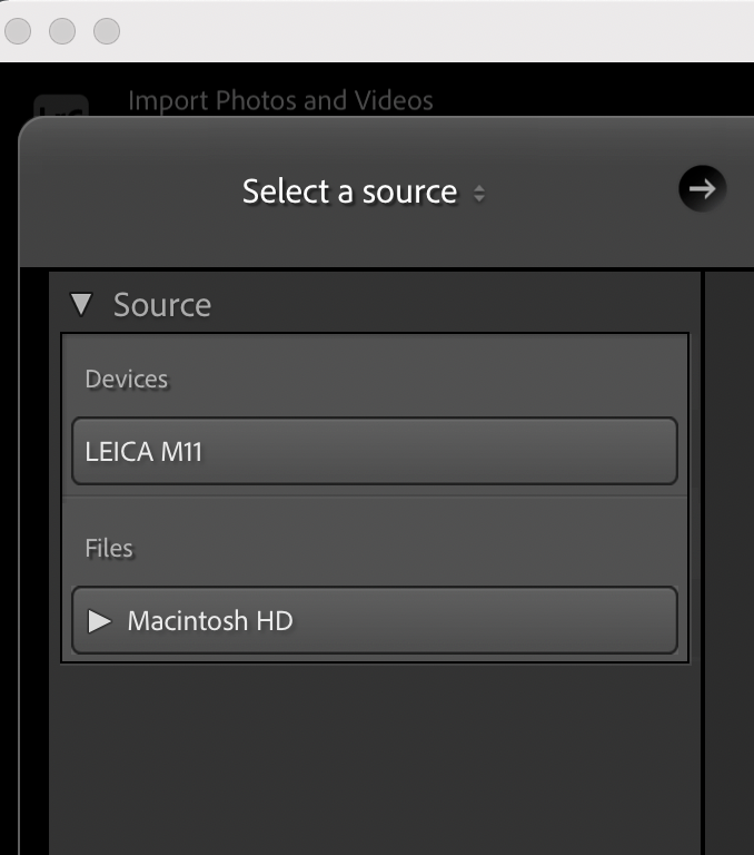

maxpachernigg Posted January 24, 2022 Share #32 Posted January 24, 2022 It worked for me. 1. Switched to PTP 2. Connected the USB-A to USB-C cable that came with the M11 to my (M1) MacBook using an adapter. 3. Opened Lightroom import dialogue 4. Switched the camera on – then the photos showed up. For some reason there where no previews available during import.. that's a real downside. Maybe to be improved some day. Welcome, dear visitor! As registered member you'd see an image here… Simply register for free here – We are always happy to welcome new members! 3 Link to post Share on other sites Simply register for free here – We are always happy to welcome new members! ' data-webShareUrl='https://www.l-camera-forum.com/topic/328443-connecting-m11-to-mac-via-usb-cable/?do=findComment&comment=4366948'>More sharing options...
SrMi Posted January 24, 2022 Author Share #33 Posted January 24, 2022 11 minutes ago, maxpachernigg said: It worked for me. 1. Switched to PTP 2. Connected the USB-A to USB-C cable that came with the M11 to my (M1) MacBook using an adapter. 3. Opened Lightroom import dialogue 4. Switched the camera on – then the photos showed up. For some reason there where no previews available during import.. that's a real downside. Maybe to be improved some day. Welcome, dear visitor! As registered member you'd see an image here… Simply register for free here – We are always happy to welcome new members! AFAIR @elmars wrote that the previews will be coming. 1 Link to post Share on other sites More sharing options...
digitalfx Posted January 24, 2022 Share #34 Posted January 24, 2022 46 minutes ago, maxpachernigg said: It worked for me. 1. Switched to PTP 2. Connected the USB-A to USB-C cable that came with the M11 to my (M1) MacBook using an adapter. 3. Opened Lightroom import dialogue 4. Switched the camera on – then the photos showed up. For some reason there where no previews available during import.. that's a real downside. Maybe to be improved some day. Leica doesnt support this yet, so the functionality is not quite there. I think the next update should fully support transfers to Mac via USB-C 3.1 cables. The Lightning cable should be slower than if you used a regular USB-C 3.1 cable Link to post Share on other sites More sharing options...
