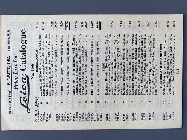

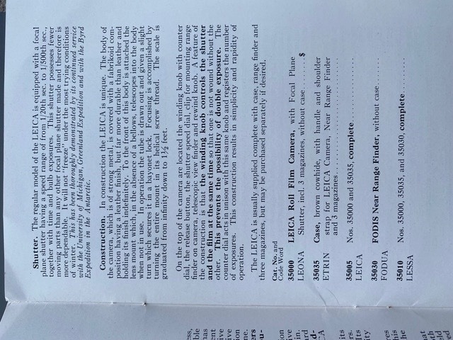

luigi bertolotti Posted September 28, 2021 Share #3 Posted September 28, 2021 (edited) The close focus IA is reported as an "export only" model... this can explain why it was made with feet scale only. I think that anyway both versions were available.... indeed could be interesting to see, for instance, a UK or USA pricelist of the '20s : I can't find one, but the USA instruction booklet of 1928 specifies that "close ranges may be as short as 3 ft." ... probably the close focus was a "special order" item: afaik, they did not assign a specific 5 letters product code for it. ABout focusing : they indeed provided the external rangefinder (FOFER) in a version that went to 0,5 meters... I don't know if its availability was coincident with the 1A close focus (maybe it was made for other usage, too, as normal for Leitz old rangefinders) : it's an uncommon version, but time to time they are seen. Edited September 28, 2021 by luigi bertolotti 3 Link to post Share on other sites More sharing options...

willeica Posted September 28, 2021 Share #7 Posted September 28, 2021 Advertisement (gone after registration) 2 hours ago, luigi bertolotti said: The close focus IA is reported as an "export only" model... this can explain why it was made with feet scale only. I think that anyway both versions were available.... indeed could be interesting to see, for instance, a UK or USA pricelist of the '20s : I can't find one, but the USA instruction booklet of 1928 specifies that "close ranges may be as short as 3 ft." ... probably the close focus was a "special order" item: afaik, they did not assign a specific 5 letters product code for it. ABout focusing : they indeed provided the external rangefinder (FOFER) in a version that went to 0,5 meters... I don't know if its availability was coincident with the 1A close focus (maybe it was made for other usage, too, as normal for Leitz old rangefinders) : it's an uncommon version, but time to time they are seen. I would be interested to see a Feet Scale I A that is not close focus. I have never seen a Metre Scale model with close focus. As for the FOFER this was also produced for cameras which were not Leicas eg FOFER N for the Nagel Pupille. I believe that the FOFER could also be used with large format cameras , but for most of them the closest focus would be a lot more than 0.5m . William Link to post Share on other sites More sharing options...

nf3996 Posted September 30, 2021 Author Share #17 Posted September 30, 2021 I have an old copy of Neill Wright and Colin Glanfield's book 'The Collector's Checklist of Leica Cameras, Lenses and Accessories'. In there the authors note three different focus-scale versions of 50mm Elmar lenses on Leica I (Model A) cameras. They state: "(a) normally infinity to 1m (b) infinity to 3 ft (uncommon version) (c) infinity to 1.5 ft. This version was apparently only made in feet, about 1927-1930, and may represent a special large order from the importers, Ogilvy & Co, for sale on the UK market." I have no idea whether the authors' suggestion re Ogilvy & Co is correct, but it sounds like an interesting possibiltiy. Alan Link to post Share on other sites More sharing options...
luigi bertolotti Posted September 30, 2021 Share #18 Posted September 30, 2021 (edited) I remember distinctly to have read somewhere the name of Ogilvy related to the close focus 1A... but regrettably don't remember the source (probably not on one of my books... it must have been on the Net....) Later edit : I've found... indeed is a book : Filippo Giunta - Leica screw mount cameras : 2446 to 6433 are stated as "normal focus 1mtr 3ft - close focus 1,5 ft for Ogilvy & co., UK" . In the meantime, surfing in various past auctions and similar, I checked that finding a 1A with 3ft is really difficult (didn't find one... 🙄) Edited September 30, 2021 by luigi bertolotti 1 Link to post Share on other sites More sharing options...
Anbaric Posted September 30, 2021 Share #19 Posted September 30, 2021 As William pointed out in another thread, Ogilvy shared an address with (and may well have become) E Leitz UK: https://www.l-camera-forum.com/topic/317854-one-of-those-superlative-pieces-of-mechanism/#comments So I suppose it's not surprising they could have special orders made! I wonder if there was a premium for this model (does anyone have a price list?). Around 0.5 m is a pretty useful close focus distance for a 50mm lens, typical for an SLR lens today, and would have been an attractive option if focusing and parallax could be managed. Link to post Share on other sites More sharing options...
