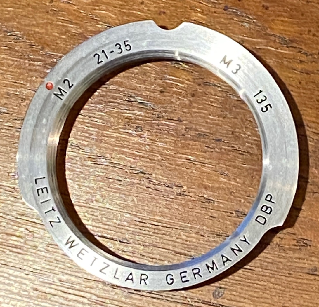

lct Posted August 27, 2021 Share #3 Posted August 27, 2021 Would you mind to show the flange of your lens? Link to post Share on other sites More sharing options...

MikeMyers Posted August 27, 2021 Author Share #6 Posted August 27, 2021 6 minutes ago, lct said: Would you mind to show the flange of your lens? Sure - does this show what you want to see? Welcome, dear visitor! As registered member you'd see an image here… Simply register for free here – We are always happy to welcome new members! Link to post Share on other sites Simply register for free here – We are always happy to welcome new members! ' data-webShareUrl='https://www.l-camera-forum.com/topic/323988-should-my-old-35mm-summaron-lens-select-the-35mm-frame-lines-on-an-m2/?do=findComment&comment=4264727'>More sharing options...

lct Posted August 27, 2021 Share #8 Posted August 27, 2021 58 minutes ago, MikeMyers said: Sure - does this show what you want to see? Welcome, dear visitor! As registered member you'd see an image here… Simply register for free here – We are always happy to welcome new members! I just wanted to check that it is a 50mm flange. You will never use your lens as a 50mm one i guess so i would have it adapted to 35mm if i were in your shoes. I would be probably tempted to do the same fix as below but i have no experience with your lens. Link to post Share on other sites More sharing options...
