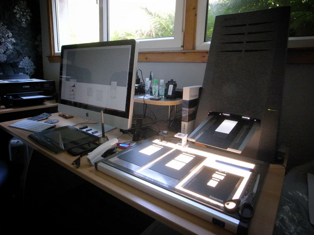

TomB_tx Posted July 24, 2021 Share #7 Posted July 24, 2021 Advertisement (gone after registration) I shoot mainly B&W on film, and use an Epson 850 Pro flatbed that can handle about any format. It will scan 18 to 24 frames at a time (depending on the carrier used), with a single click. I scan to a LAN server so I can check progress and see results during the scan on an iPad. For my use the automatic scan is usually adequate to use without post-processing. It also does a reasonable job on color, but I usually just have the lab scan those, and I can always scan any images I want to customize once the negatives or slides come back. Lately for color I do mainly Ektachome, as the slide is a nice color reference. 1 Quote Link to post Share on other sites More sharing options...
