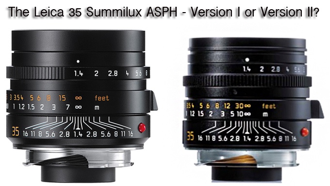

evikne Posted May 22, 2021 Share #17 Posted May 22, 2021 Welcome, dear visitor! As registered member you'd see an image here… Simply register for free here – We are always happy to welcome new members! Which of these do you have? FLE (11663) to the left, pre-FLE (11874) to the right. All M lenses produced after July 2006 are 6-bit coded. The FLE was introduced in 2010. So if it's not 6-bit coded, you probably have the pre-FLE, or ASPH v1. Link to post Share on other sites Simply register for free here – We are always happy to welcome new members! Which of these do you have? FLE (11663) to the left, pre-FLE (11874) to the right. All M lenses produced after July 2006 are 6-bit coded. The FLE was introduced in 2010. So if it's not 6-bit coded, you probably have the pre-FLE, or ASPH v1. ' data-webShareUrl='https://www.l-camera-forum.com/topic/321068-any-problem-with-my-m240-summilux-35mm-14-asph-fle-strong-vignetting/?do=findComment&comment=4205475'>More sharing options...
Pablete Posted May 22, 2021 Author Share #18 Posted May 22, 2021 5 hours ago, jaapv said: But how come not coded? So it is not the FLE but an older lens design. 3 hours ago, evikne said: Welcome, dear visitor! As registered member you'd see an image here… Simply register for free here – We are always happy to welcome new members! Which of these do you have? FLE (11663) to the left, pre-FLE (11874) to the right. All M lenses produced after July 2006 are 6-bit coded. The FLE was introduced in 2010. So if it's not 6-bit coded, you probably have the pre-FLE, or ASPH v1. It's al older version, according with the serial number, It's a 1995 Summilux 35mm 1.4 apsh, same to the right in picture. Link to post Share on other sites More sharing options...
