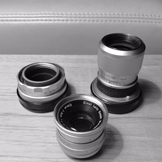

lm_user Posted November 20, 2018 Share #51  Posted November 20, 2018 (edited) Jaeger.  You have to understand that only lenses designed for the visoflex will work and focus to infinity.  All of these are longer focal lengths with 65mm being the shortest Some lenses - the 90mm elmar for example have a removable lens head that can be placed on either a rangefinder focus mount or visoflex focus mount.  The visoflex foxus mount is 41mm shorter to account for the thickness of the visiflex. (See photo - head in front with viso mount on left and rangefinder mount on right  Welcome, dear visitor! As registered member you'd see an image here… Simply register for free here – We are always happy to welcome new members! Edited November 20, 2018 by lm_user 1 Link to post Share on other sites Simply register for free here – We are always happy to welcome new members! ' data-webShareUrl='https://www.l-camera-forum.com/topic/31884-visoflex-question/?do=findComment&comment=3633966'>More sharing options...
