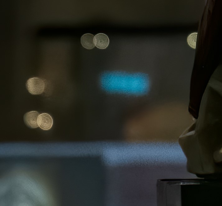

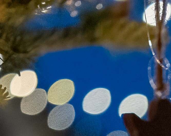

Chaemono Posted December 30, 2020 Share #141 Posted December 30, 2020 (edited) Advertisement (gone after registration) vor einer Stunde schrieb Daedalus2000: And to show an example of what I mean, if we take the picture that @Chaemono posted above and take a crop you will see that it will not clean all areas, and for some it will keep the noise or reduce it less, like the highlights in the crop below. I am not sure how the algo works, but I am guessing the model underneath it tries to identify the areas where the image has information (details) and therefore should not be denoised too much and areas where it does not have information/detail and need to be smoothed. Sometimes it gets it wrong, observe how smooth the darker areas are below and how noisy the highlights are... Welcome, dear visitor! As registered member you'd see an image here… Simply register for free here – We are always happy to welcome new members! Another example from one of the iso 12500 pics from @Chaemono, observe how the noise between the branches is still high (and on the bokeh balls) but other blue areas have been smoothed a lot. There are trade-offs. At some point AI will become so good, it’ll be able to distinguish and adjust even these areas. It just has to look at thousands of Leica bokeh balls first. 😂 Edited December 30, 2020 by Chaemono 3 Link to post Share on other sites More sharing options...

SrMi Posted December 30, 2020 Share #142 Posted December 30, 2020 (edited) 1 hour ago, Daedalus2000 said: And to show an example of what I mean, if we take the picture that @Chaemono posted above and take a crop you will see that it will not clean all areas, and for some it will keep the noise or reduce it less, like the highlights in the crop below. I am not sure how the algo works, but I am guessing the model underneath it tries to identify the areas where the image has information (details) and therefore should not be denoised too much and areas where it does not have information/detail and need to be smoothed. Sometimes it gets it wrong, observe how smooth the darker areas are below and how noisy the highlights are... <snip> Another example from one of the iso 12500 pics from @Chaemono, observe how the noise between the branches is still high (and on the bokeh balls) but other blue areas have been smoothed a lot. <snip> I have also observed inconsistencies in Topaz DeNoise AI: flat surfaces having varying amount of noise reduction. Therefore, I prefer doing it manually (LrC or PS), unless I am in a rush :). Edited December 30, 2020 by SrMi 2 Link to post Share on other sites More sharing options...
