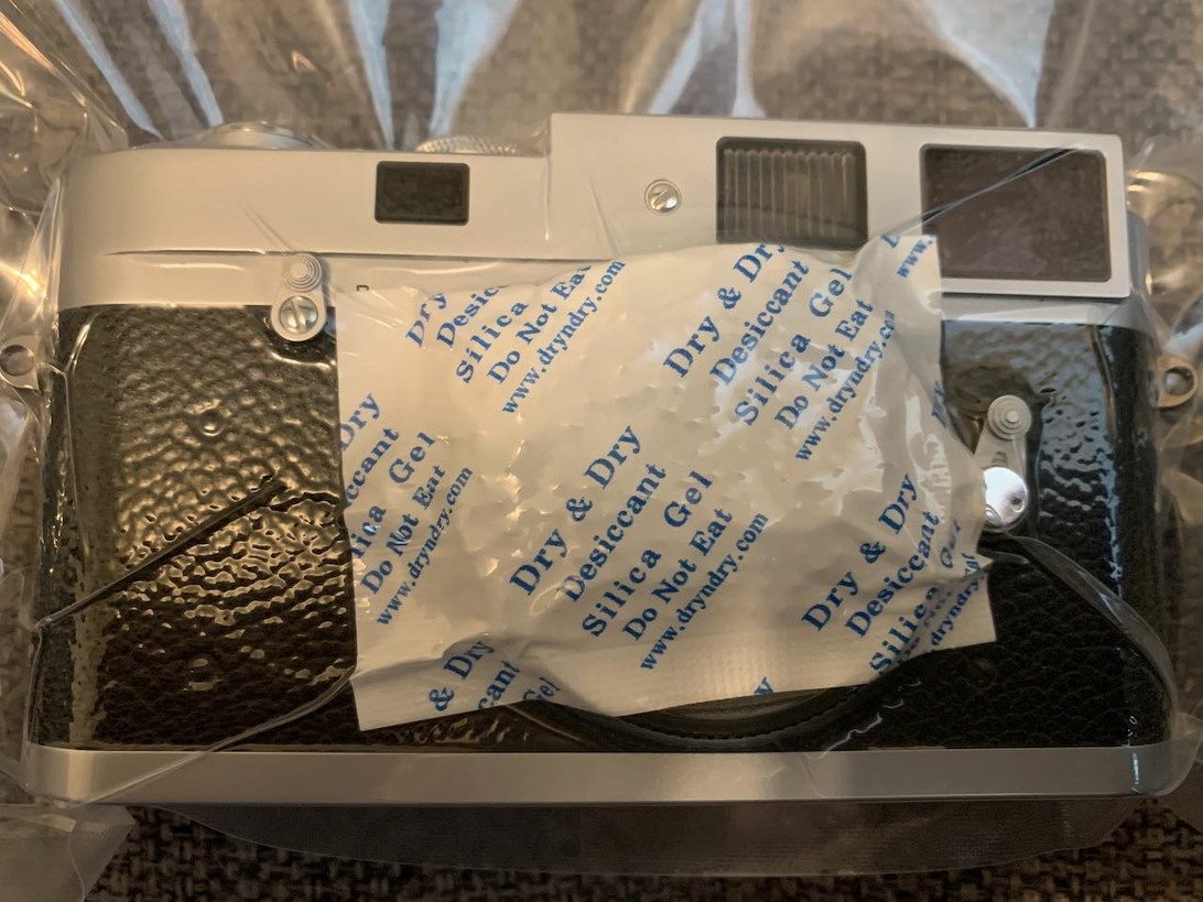

malligator Posted September 25, 2020 Author Share #31  Posted September 25, 2020 I received my loupe and it's most definitely a little critter. Very clear white with multiple legs scurrying along like a little microorganism. It's all packed up with desiccants and in the freezer for the next 24 hours. Welcome, dear visitor! As registered member you'd see an image here… Simply register for free here – We are always happy to welcome new members! Link to post Share on other sites Simply register for free here – We are always happy to welcome new members! ' data-webShareUrl='https://www.l-camera-forum.com/topic/313596-bugs-literally-in-my-m-a-viewfinder/?do=findComment&comment=4051756'>More sharing options...
logan2z Posted September 25, 2020 Share #32  Posted September 25, 2020 (edited) 1 hour ago, malligator said: I received my loupe and it's most definitely a little critter. Very clear white with multiple legs scurrying along like a little microorganism. It's all packed up with desiccants and in the freezer for the next 24 hours. Welcome, dear visitor! As registered member you'd see an image here… Simply register for free here – We are always happy to welcome new members! Dumb question, but is it actually ok to freeze a camera? Are the lubricants, shutter etc designed to be frozen/thawed? I can't say I've ever heard of anyone doing that, but I may have led a sheltered life Edited September 25, 2020 by logan2z 1 Link to post Share on other sites More sharing options...

malligator Posted September 25, 2020 Author Share #37  Posted September 25, 2020 37 minutes ago, logan2z said: Dumb question, but is it actually ok to freeze a camera? Are the lubricants, shutter etc designed to be frozen/thawed? I can't say I've ever heard of anyone doing that, but I may have led a sheltered life I can't find the operating temp of analog M cameras, but I'd be surprised if it couldn't handle 0F. I've vacuum sealed the camera using my professional vacuum chamber with some desiccants to reduce any condensation when I remove it from the freezer. If everything goes as planned the camera should go down to 0F, the mite(s) should die, and the camera will warm back up in a benign environment. As an aerospace electrical engineer I routinely test flight components at much colder temps. I would love to use my equipment from work to do this, but I've done everything I can at home to reduce any risk of damage. Link to post Share on other sites More sharing options...
logan2z Posted September 25, 2020 Share #38 Â Posted September 25, 2020 12 minutes ago, malligator said: I can't find the operating temp of analog M cameras, but I'd be surprised if it couldn't handle 0F. You may be right: https://leicarumors.com/2010/05/24/leica-mp-survives-40c-temperatures-during-60-days-trek-on-the-north-pole.aspx/ Are you just going to leave the dead bugs inside the viewfinder? Link to post Share on other sites More sharing options...
malligator Posted September 25, 2020 Author Share #39  Posted September 25, 2020 11 minutes ago, logan2z said: You may be right: https://leicarumors.com/2010/05/24/leica-mp-survives-40c-temperatures-during-60-days-trek-on-the-north-pole.aspx/ Are you just going to leave the dead bugs inside the viewfinder? I don't really have a choice without giving up my camera for a period of time to CLA. There's only one that I can see and it's literally the size of a speck of dust. I only noticed it because I saw it in perfect light and saw that it was moving after watching it for a while. Link to post Share on other sites More sharing options...
logan2z Posted September 25, 2020 Share #40  Posted September 25, 2020 11 hours ago, malligator said: I don't really have a choice without giving up my camera for a period of time to CLA. There's only one that I can see and it's literally the size of a speck of dust. I only noticed it because I saw it in perfect light and saw that it was moving after watching it for a while. If they're that small as to be almost imperceptible, I would probably just leave them there to expire on their own. With any luck, they might even crawl back out the same way they got in. Link to post Share on other sites More sharing options...
