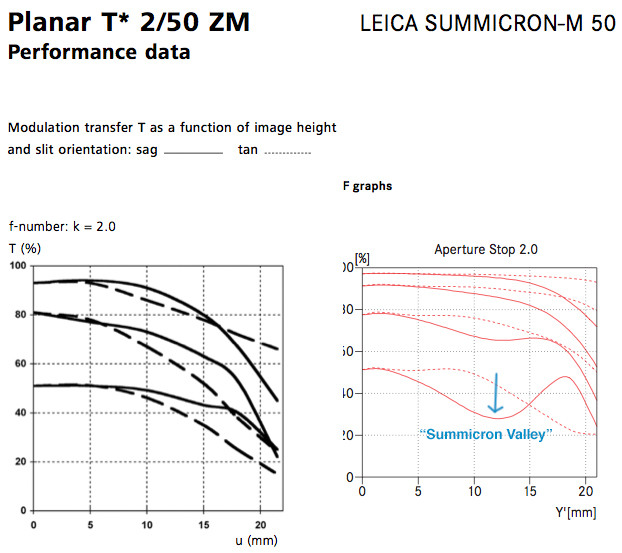

TomB_tx Posted July 14, 2020 Share #11  Posted July 14, 2020 I think there is a characteristic in the Summicron layout, or in the optimization of other factors, that gives the family this tendency. I first noticed it in 1969 shooting a ver1 Summicron R on my Leicaflex SL. That lens fed the Summicron M ver III that I also bought about that time. The III design was modified to the IV (& V) design, which ultimately fed the 2.5 Summarit. All of these can exhibit the effect. However, the APO is a fresh, very different design, and of course they had a recall of that for a central flare issue. Perhaps the Leica design philosophy to optimize certain other characteristics doesn’t see this issue as so important. Link to post Share on other sites More sharing options...
Jeff S Posted July 14, 2020 Share #12  Posted July 14, 2020 33 minutes ago, logan2z said: So I wonder if there is some aspect of their optical design that makes them more prone to flare. Or is it simply that buyers of these lenses are particularly inept at using them? Both,  I would say.  But I’m not an optical specialist, so I can’t speak to specific design elements that affect flare, which are probably multiple given variables such as coatings, secondary internal reflections, number and complexity of glass elements, etc.  I know that Leica made a point, for example, about flare resistance regarding the M Summarits (now discontinued) as part of the marketing.  I recall reading somewhere about internal blackening to reduce secondary reflections, but don’t remember the source.  Even the Summarits, though, will flare under certain conditions.  I owned a MATE that also was more prone to flare at 50mm, as others have also experienced, but I learned to avoid/minimize it. User technique and judgment affects every aspect of photo and print workflow. Jeff  Link to post Share on other sites More sharing options...

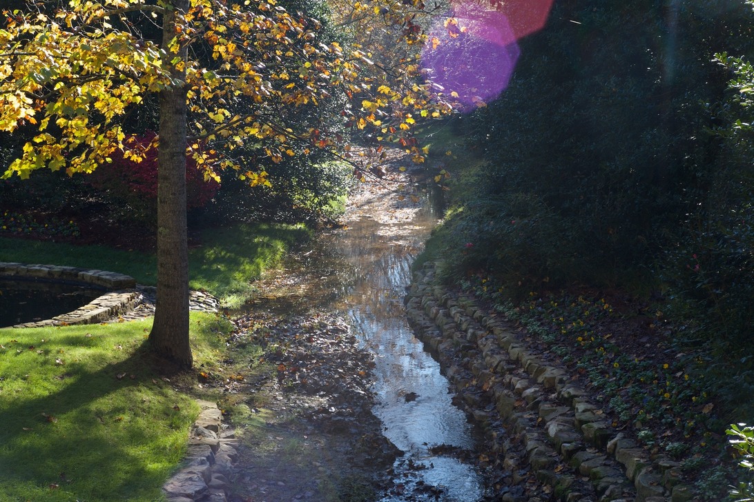

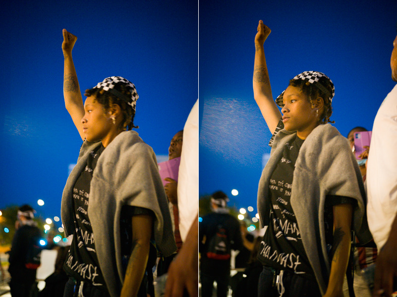

m410 Posted July 14, 2020 Share #13  Posted July 14, 2020 (edited) Yes, the 50mm f2 Summicron V is prone to flare. This is not caused by the user as previously expressed but rather this lenses ability to deal with bright concentrations of light with its particular combination of design, glass qualities and coatings. Of course the user can minimize/maximize the impact of flare in the photograph with composition, using a lens hood, filters, software etc. Also, you can just include flare as an artistic element. At first I was startled by the flare in my new 50mm Summicron, especially compared with my other Leica lenses, but I learned to deal with it. I even, at times, enjoy the challenge of using or eliminating the impacts of these areas of low contrast or flare. As my version of the 50mm f2 Summicron is my only 50mm, I do not know how it's flare characteristics compares with Leica's other 50mm lenses. The 50mm f2 Summicron V is a nice lens and has been a good choice for me. I appreciate its weight, small physical size, 39mm filters, focal length and most of all:  the images. Photo below is Luang Prabang, Laos shooting towards, but not directly at the sun with my M10+50mm f2 Summicron (current version), UV filter and hood retracted. Welcome, dear visitor! As registered member you'd see an image here… Simply register for free here – We are always happy to welcome new members! Edited July 14, 2020 by m410 yes 6 Link to post Share on other sites Simply register for free here – We are always happy to welcome new members! ' data-webShareUrl='https://www.l-camera-forum.com/topic/311314-is-the-latest-50mm-non-apo-summicron-still-flare-prone/?do=findComment&comment=4008816'>More sharing options...
logan2z Posted July 14, 2020 Author Share #14  Posted July 14, 2020 2 hours ago, m410 said: Photo below is Luang Prabang, Laos shooting towards, but not directly at the sun with my M10+50mm f2 Summicron (current version), UV filter and hood retracted. Welcome, dear visitor! As registered member you'd see an image here… Simply register for free here – We are always happy to welcome new members! Hmm, I wonder how different the result might have been with the hood extended. That result is a bit disappointing. Again, I realize that any optical system has flaws but this is a lens with a fairly hefty price tag and is seemingly more prone to flare than other, less expensive options - some from Leica themselves. I'm a big fan of Leica and don't really have a desire to use a non-Leica lens on my M-A or M4, but this Summicron is giving me pause... Link to post Share on other sites More sharing options...

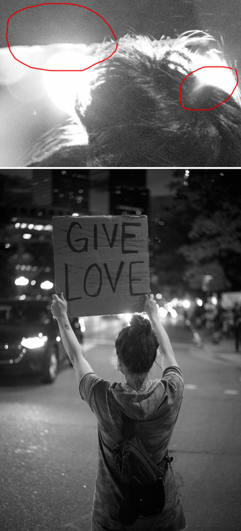

adan Posted July 16, 2020 Share #18  Posted July 16, 2020 Here's my (very recent) experience with a 50 v.5 of recent make (post-2010). First up - actual optical flare "through" the lens glass, cement and coatings (and, for completeness, the sensor cover glass). Under fairly extreme lighting. Note how the brightest light leaks or flares into the poster-board and the woman's hair. if I were guessing, this "leakage" comes from the v.4/5's four flat (and thus relatively inexpensive) lens surfaces either side of the diaphragm. But maybe not. Welcome, dear visitor! As registered member you'd see an image here… Simply register for free here – We are always happy to welcome new members! The pair below shows another kind of flare - internal reflections off the lens's metal housing OR the inside of the camera (digital M10). Interestingly, when I swung the lens slightly more to the right, the street light just outside the frame on the left produced even more flare. Which just goes to show how sneaky some flare can be to analyze. (Built-in lens hood was extended for these shots). It all has to do with just what "spill" light from just outside the picture area is falling on, in between the back of the lens and the image plane. If it reflects inside the camera, it can't really be blamed on the lens, but if it is reflecting inside the lens tube itself somewhere, then the lens gets the "credit."  Link to post Share on other sites Simply register for free here – We are always happy to welcome new members! The pair below shows another kind of flare - internal reflections off the lens's metal housing OR the inside of the camera (digital M10). Interestingly, when I swung the lens slightly more to the right, the street light just outside the frame on the left produced even more flare. Which just goes to show how sneaky some flare can be to analyze. (Built-in lens hood was extended for these shots). It all has to do with just what "spill" light from just outside the picture area is falling on, in between the back of the lens and the image plane. If it reflects inside the camera, it can't really be blamed on the lens, but if it is reflecting inside the lens tube itself somewhere, then the lens gets the "credit."  ' data-webShareUrl='https://www.l-camera-forum.com/topic/311314-is-the-latest-50mm-non-apo-summicron-still-flare-prone/?do=findComment&comment=4010026'>More sharing options...
