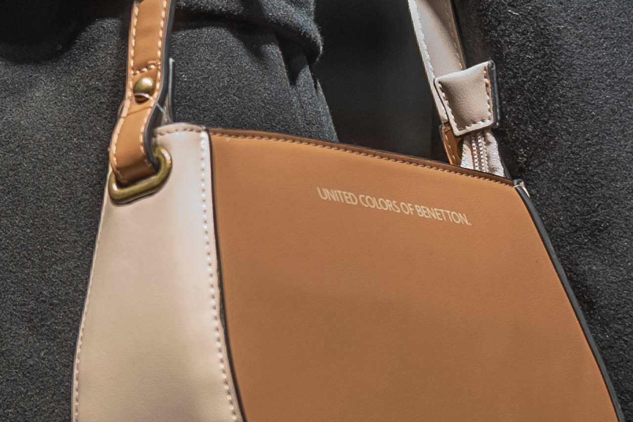

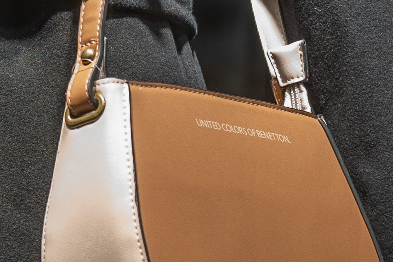

Chaemono Posted January 8, 2020 Share #89  Posted January 8, 2020 (edited) vor 2 Stunden schrieb SrMi: Did you underexpose appropriately with ISO 50? No, but I ETTRed in this scene here equally at ISO 50 and ISO 100.  See which file has more DR when one actually attempts to recover highlight details.  Link for DNG download ist provided. Less compressed JPEGs here: https://www.smugmug.com/gallery/n-tzdLng/ SL2 + 35 Summicron-SL opened in LR and exported as JPEG, not touched. DNG download here: https://cc2032.zenfolio.com/img/g11576374-o750076470.dat?dl=2&tk=BJLV7gSeX6iQtuVCZ3H3pOldQoT_wbLZST2aMzZA0Wo= Welcome, dear visitor! As registered member you'd see an image here… Simply register for free here – We are always happy to welcome new members! ISO 50 f/2 @1/20 sec. SL2 + 35 Summicron-SL opened in LR and exported as JPEG, not touched. DNG download here: https://cc2032.zenfolio.com/img/g332911839-o750076470.dat?dl=2&tk=swwbK_HIUvbrI6mTRRx3usXZoJA2-wm9E8vjBYpNV74= ISO 100 f/2 @1/40 sec. Edited January 8, 2020 by Chaemono Link to post Share on other sites Simply register for free here – We are always happy to welcome new members! ISO 50 f/2 @1/20 sec. SL2 + 35 Summicron-SL opened in LR and exported as JPEG, not touched. DNG download here: https://cc2032.zenfolio.com/img/g332911839-o750076470.dat?dl=2&tk=swwbK_HIUvbrI6mTRRx3usXZoJA2-wm9E8vjBYpNV74= ISO 100 f/2 @1/40 sec. ' data-webShareUrl='https://www.l-camera-forum.com/topic/305002-sl2-vs-sl-feedback/?do=findComment&comment=3887673'>More sharing options...
Chaemono Posted January 8, 2020 Share #90  Posted January 8, 2020 And now with Highlights -100, Shadows +100, and in the ISO 100 file NR +20.  Look at the mannequin's face. Less compressed JPEGs here: https://www.smugmug.com/gallery/n-tzdLng/ Welcome, dear visitor! As registered member you'd see an image here… Simply register for free here – We are always happy to welcome new members! ISO 50 f/2 @1/20 sec. Highlights -100, Shadows +100 ISO 100 f/2 @1/40 sec. Highlights -100, Shadows +100, NR +20 Link to post Share on other sites Simply register for free here – We are always happy to welcome new members! ISO 50 f/2 @1/20 sec. Highlights -100, Shadows +100 ISO 100 f/2 @1/40 sec. Highlights -100, Shadows +100, NR +20 ' data-webShareUrl='https://www.l-camera-forum.com/topic/305002-sl2-vs-sl-feedback/?do=findComment&comment=3887675'>More sharing options...
Chaemono Posted January 8, 2020 Share #91  Posted January 8, 2020 It's not just the mannequin's face, look at the purse.  DR of ISO 100 files is much better than of ISO 50 files, obviously. Less compressed JPEGs here: https://www.smugmug.com/gallery/n-tzdLng/ Crop from #92 Welcome, dear visitor! As registered member you'd see an image here… Simply register for free here – We are always happy to welcome new members! ISO 50 f/2 @1/20 sec. Crop from #92ISO 100 f/2 @1/40 sec. Link to post Share on other sites Simply register for free here – We are always happy to welcome new members! ISO 50 f/2 @1/20 sec. Crop from #92ISO 100 f/2 @1/40 sec. ' data-webShareUrl='https://www.l-camera-forum.com/topic/305002-sl2-vs-sl-feedback/?do=findComment&comment=3887677'>More sharing options...
SrMi Posted January 8, 2020 Share #92  Posted January 8, 2020 3 minutes ago, Chaemono said: It's not just the mannequin's face, look at the purse.  DR of ISO 100 files is much better than of ISO 50 files, obviously. Less compressed JPEGs here: https://www.smugmug.com/gallery/n-tzdLng/ Crop from #92 Welcome, dear visitor! As registered member you'd see an image here… Simply register for free here – We are always happy to welcome new members! ISO 50 f/2 @1/20 sec. Crop from #92ISO 100 f/2 @1/40 sec. As Bill said, I think you are confusing exposure with dynamic range. Bill’s measurements are theoretical and very reliable. However, for practical purposes, ISO 50 may have less usable dynamic range. I need to run some more tests to wrap my head around it.  Link to post Share on other sites More sharing options...
Chaemono Posted January 8, 2020 Share #93  Posted January 8, 2020 Gerade eben schrieb SrMi: As Bill said, I think you are confusing exposure with dynamic range. Bill’s measurements are theoretical and very reliable. However, for practical purposes, ISO 50 may have less usable dynamic range. I need to run some more tests to wrap my head around it.  How am I confusing exposure with DR? The ISO 50 and the ISO 100 files are equally exposed. Link to post Share on other sites More sharing options...
SrMi Posted January 8, 2020 Share #94  Posted January 8, 2020 57 minutes ago, Chaemono said: How am I confusing exposure with DR? The ISO 50 and the ISO 100 files are equally exposed. Because you are not talking about dynamic range per se, but about the dynamic range of a properly exposed image. Granted your discussion may be more relevant than the theoretical one. The best dynamic range may apparently not always be achievable with correct exposure. Link to post Share on other sites More sharing options...
Aktenschrank Posted January 8, 2020 Share #95  Posted January 8, 2020 53 minutes ago, Chaemono said: How am I confusing exposure with DR? The ISO 50 and the ISO 100 files are equally exposed. What I have found in my personal (unscientific but persistent:) tests is that ISO 50 has just a tad more usable DR. About 1/3-2/3 of a stop when underexposed accordingly. One needs to underexpose the ISO 50 shot by about 1/3 - 2/3 of a stop to get the same highlight recoverability as ISO 100, then lift the overall exposure by the same amount in post. This will result in the same highlight recoverability with the ISO 50 file, but slightly cleaner shadows. Now, the difference is not that big and, just like probably many on this thread, I´m still debating if it's worth even doing😀 1 1 Link to post Share on other sites More sharing options...
