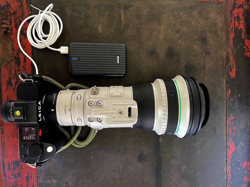

michali Posted December 21, 2019 Share #1 Posted December 21, 2019 (edited) Advertisement (gone after registration) One of my biggest gripes is that the Sigma MC-21 adapter for Canon EF lenses does not work at all on the SL601. The only way to use Canon EF lenses with AF on the SL601 is via the Novoflex EF to L adapter. The Novoflex adapter functions on a scale of about 7 or 8 out of 10, which is less than ideal. On the SL601 with my Canon EF 400mm f/4 DO IS II USM there's great amount of focus hunting going on, and 80% of the time you have to intervene by using the MF ring to help lock focus. Once you add Tele-converters with the Novoflex adapter the lens is just about unusable in AF. As a comparison, on the S1R however the lens & MC-21 adapter functions on a scale of about 9 out of 10 with minimal MF intervention on the part of the user. I collected my SL2 yesterday, and am very pleased to report that the Sigma MC-21 adapter works really well on the SL2 😁! In fact just as well if not better than it did on the S1R. I've tested it with the Canon 400mm and it works seamlessly. No focus hunting. I then also tried the Novoflex EF-L adapter on the SL2 and it behaves the same way as it does on the SL601, plenty of focus hunting and almost unusable when you add Tele-converters. The MC-21adapter on the SL2 also works with the Canon 1.4X & 2X Tele-converters, AF is slightly slower with the 1.4X TC, more so with the 2x TC, but still very usable, it locks on to focus with no intervention. Personally I'm very pleased with this outcome. Edited December 21, 2019 by michali 7 1 Link to post Share on other sites More sharing options...

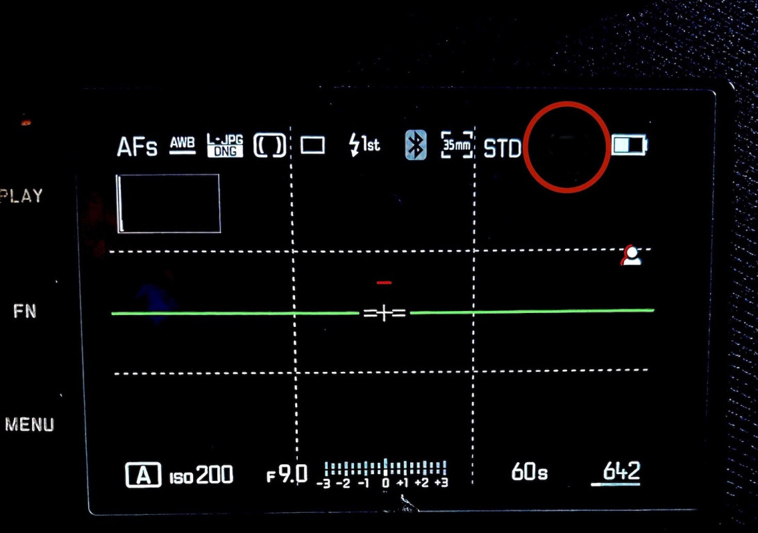

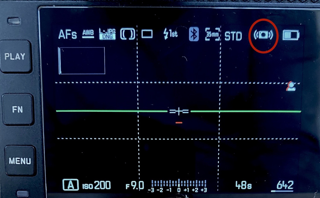

sagarwal Posted December 22, 2019 Share #17 Posted December 22, 2019 2 hours ago, HeinzX said: I just tried again the SL 2 and both adapters -MC 21 an Novoflex with the Canon 180 mm and the Canon 100 mm Macro - non L version. Both adapters allow switch on and switch off of the stabilizer - nothing grayed out. I first connected the lenses with the adapter and then connected this combination with the SL and switched the camera on. The Novofle adapter has been bought a few years in the past together with my sold SL 1 - the Sigma one has been bought quite recently together with myy SL 2. Thanks for trying this out and reporting back. I did follow the same process as you did, but with Sigma mount equipment: MC-21 SA-L adapter and Sigma 60-600mm Sigma mount connected together first, then the combination connected to the SL2 and then the SL2 was switched on. IBIS was grayed out. Hence my emails to Sigma and Leica. I wonder if this is something specific to Sigma mount lenses, while EF-L mount connections allow IBIS to be used. In any case, I will try this again as soon as I can. Link to post Share on other sites More sharing options...
