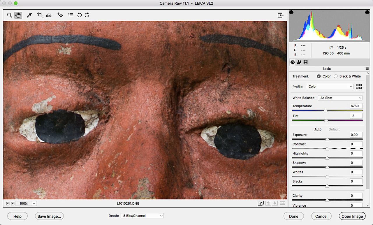

fotonutzz Posted April 1, 2020 Share #36 Posted April 1, 2020 (edited) On 12/23/2019 at 8:58 PM, michali said: I did the FW upgrade of the MC-21 (Canon EF-L vers.) on the SL2. IBIS does not work, OIS on the lens does work. Here's an image I took with the Canon 400mm f4 mounted on the SL2 via the MC-21 after the FW upgrade. ISO50 1/25s f4 - hand held, standing with no support, overcast day. There's no motion blur. The IS on the lens is working perfectly even without IBIS being available. 100% crop of unprocessed image: Welcome, dear visitor! As registered member you'd see an image here… Simply register for free here – We are always happy to welcome new members! Hi Michali How did you manage to get your 400mm DO II OIS to work ? I have the first version of the 400mm F4 DO, but I couldn’t get the lens IS to work. I’ve set the LENS PROFILE to the Leica R 400/F4, but when I mount the lens, the LENS PROFILE is grayed off. AF and aperture controls works fine on the 400 DO, but not the OIS My MC-21 is updated to the latest Firmware. Edited April 1, 2020 by fotonutzz Quote Link to post Share on other sites More sharing options...
