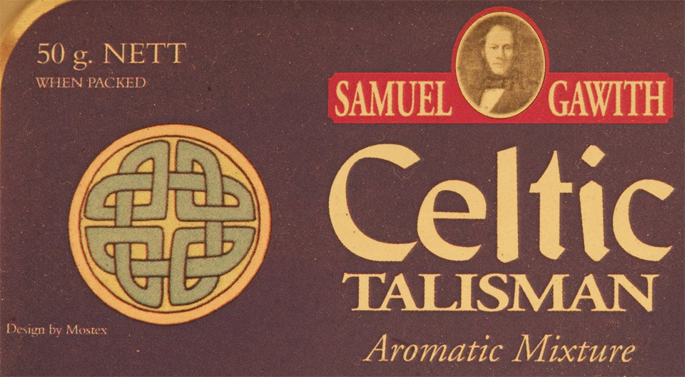

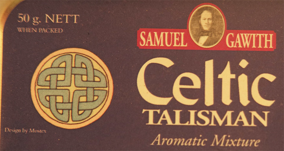

luigi bertolotti Posted October 28, 2019 Share #4  Posted October 28, 2019 I have 2 Summicron collapsible (both SM) : first one shows haze, and it was never CLAed : see hereunder Welcome, dear visitor! As registered member you'd see an image here… Simply register for free here – We are always happy to welcome new members! the second one (a bit older) was professionally cleaned-repolished ; see herunder quick takings just made :  jpg out of camera (M240), cropped and resized for publish : f8 on bot, best focus I could achieve in 3 test shots for each (EVF) Not exahustive test (more colors would be appreciable to evaluate contrast) but a clear difference imho  4 1 Link to post Share on other sites Simply register for free here – We are always happy to welcome new members! the second one (a bit older) was professionally cleaned-repolished ; see herunder quick takings just made :  jpg out of camera (M240), cropped and resized for publish : f8 on bot, best focus I could achieve in 3 test shots for each (EVF) Not exahustive test (more colors would be appreciable to evaluate contrast) but a clear difference imho  ' data-webShareUrl='https://www.l-camera-forum.com/topic/302900-summicron-5cm-collapsable-with-haze/?do=findComment&comment=3843827'>More sharing options...

jaapv Posted December 24, 2019 Share #8  Posted December 24, 2019 On 10/28/2019 at 11:05 PM, luigi bertolotti said: I have 2 Summicron collapsible (both SM) : first one shows haze, and it was never CLAed : see hereunder Welcome, dear visitor! As registered member you'd see an image here… Simply register for free here – We are always happy to welcome new members! the second one (a bit older) was professionally cleaned-repolished ; see herunder quick takings just made :  jpg out of camera (M240), cropped and resized for publish : f8 on bot, best focus I could achieve in 3 test shots for each (EVF) Not exahustive test (more colors would be appreciable to evaluate contrast) but a clear difference imho  Totally OT: Luigi, I thought these tins were blue? Link to post Share on other sites More sharing options...
luigi bertolotti Posted December 24, 2019 Share #9  Posted December 24, 2019 19 minutes ago, jaapv said: Totally OT: Luigi, I thought these tins were blue? Ah... do you like that tobacco, Jaap ? (isn't easy to find in my town... but i liked it and kept the tin to remember to buy again if I find) And... 😎 you're right, real color is blue... but the above pics were quickly taken in warm home light, didn't perform any white balancing, and, given that the tin almost filled the frame (I used an extension ring, with EVF) the color balancing was completely fooled... and I quickly cut and resized the jpgs with no process... to amend, here's one taken just now in sunlight... 😉 (same camera, but another Summicron 50... 😊) Welcome, dear visitor! As registered member you'd see an image here… Simply register for free here – We are always happy to welcome new members! 1 Link to post Share on other sites Simply register for free here – We are always happy to welcome new members! ' data-webShareUrl='https://www.l-camera-forum.com/topic/302900-summicron-5cm-collapsable-with-haze/?do=findComment&comment=3878731'>More sharing options...
