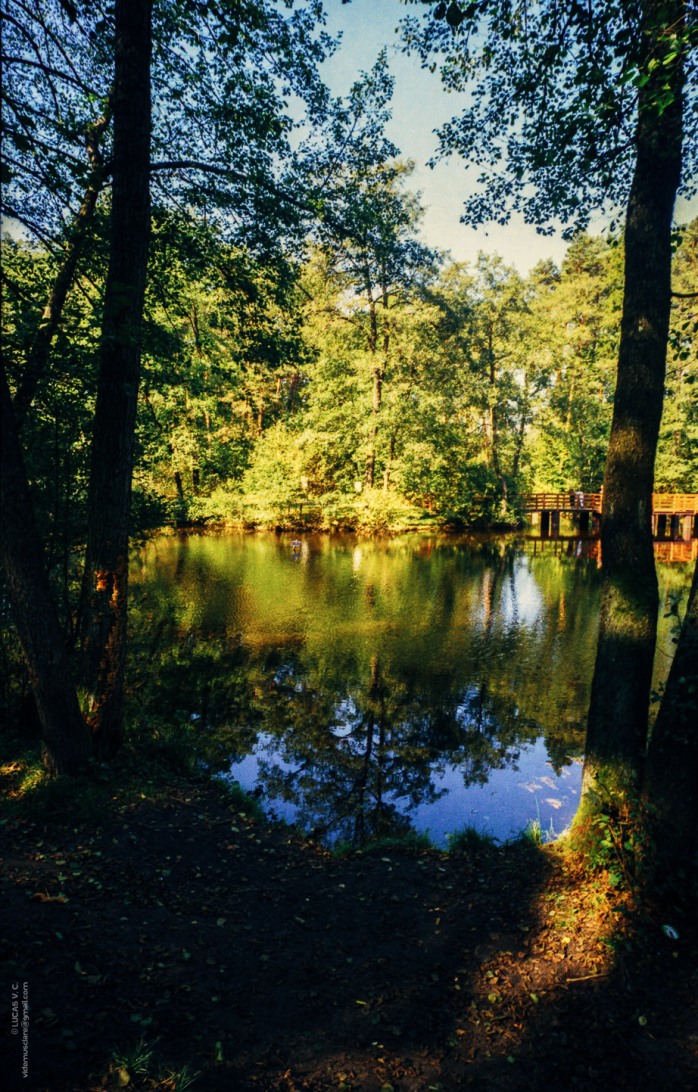

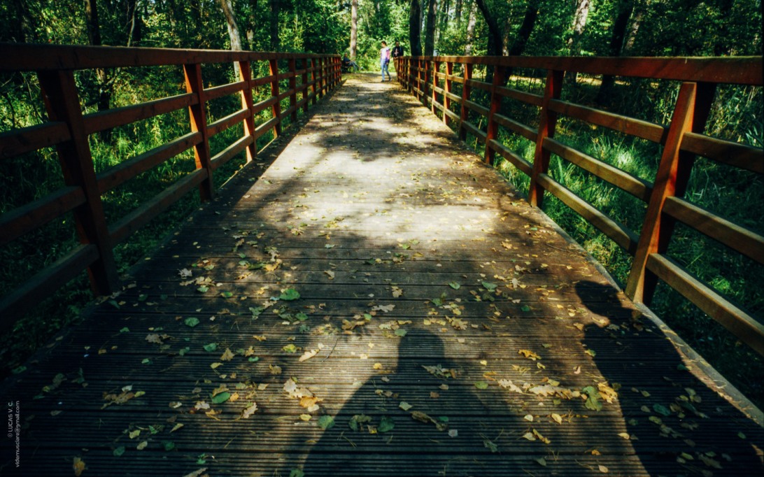

lct Posted June 12, 2019 Share #24 Posted June 12, 2019 Comparing results is always possible fortunately but my 6-bit coded Summicron 35/2 asph v1 and 7art 35/2 look so close that i did not have the courage to do side by side comparos so far. Couple of test pics with the 7art 35/2 on the Digital CL below, most if not all at f/2. This great litle lens works fine on my M240 and Sony A7s mod as well but i prefer the handling of the Summicron 35/2 asph v1 on those bodies, also its smoother OoF rendition to be honest. Now in spite of their different prices, both lenses look very close actually. Same for the CV 35/2 BTW. Great to find lenses that good at affordable prices nowadays. https://lctphot.smugmug.com/Diverse/7-artisans-352-on-Leica-digital-CL/n-nJBCXF 2 Link to post Share on other sites More sharing options...

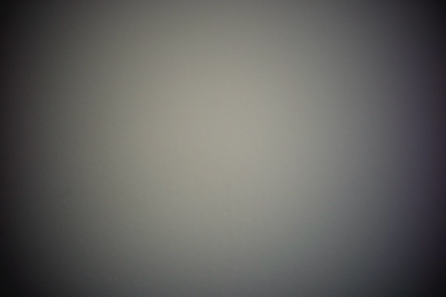

adan Posted December 31, 2019 Share #32 Posted December 31, 2019 Well, it's interesting.... The picture below was made with an un-IDed, uncoded (and uncodable) 1976 28mm Elmarit v.2 on an M10. Now, this version 2 was the one introduced for the M5 metering, and has the longest back-focus of any M-28 (except maybe the tiny Summaron) - Leica rather overcooked the retrofocus design (and dialed it back a bit with subsequent versions) to be sure of clearing the M5/CL metering arms. Nevertheless, some combination of the lens design and the additional M10 sensor revision completely eliminate any color vignetting at 28mm, even without a profile. No Italian Flag or other color shifts at all. That feature, plus a generally lower contrast (but high saturation) has made this 28 my new "best-friend-forever" for digital, even though it is a bit weak at f/2.8. Welcome, dear visitor! As registered member you'd see an image here… Simply register for free here – We are always happy to welcome new members! 1 Link to post Share on other sites Simply register for free here – We are always happy to welcome new members! ' data-webShareUrl='https://www.l-camera-forum.com/topic/298111-leica-m240-purple-magenta-cast/?do=findComment&comment=3882272'>More sharing options...

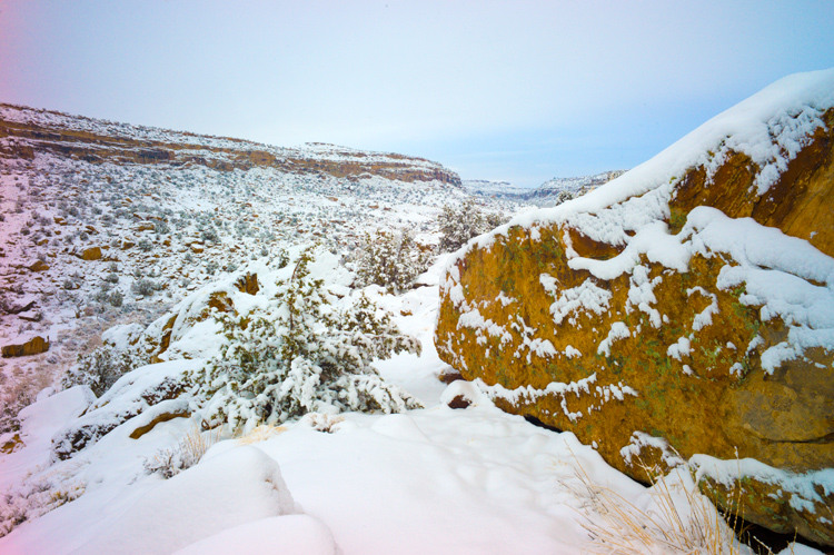

84bravo Posted December 31, 2019 Share #33 Posted December 31, 2019 I have the 7A 35mm f2, 50mm f1.1 and the 28mm f1.4 and used them with M240 and M10 cameras. The 35 and the 50 came from the factory with six bit coding, the 28mm did not. Only the 50mm gives me odd color casts on the edges, and then only in certain situations. I really notice it when I photographed a snow scene. The other two lenses work just fine and the 50 is terrific for low light work or wide aperture portraiture. I think that 7Artisans does not six bit code any of their Leica M mount lenses anymore. Link to post Share on other sites More sharing options...
