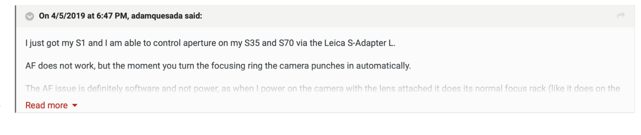

adamquesada Posted April 20, 2019 Share #7 Posted April 20, 2019 Advertisement (gone after registration) 44 minutes ago, Stuart Richardson said: Regarding AF, the more that I think about it, the more it makes sense that Leica has not made AF available to the Panasonic S1 and S1R. Think about how much grief they have had with AF failures...if a third party company comes in and the lenses AF on their body, and they decide to focus them as fast as possible or even somehow have an algorithm that stresses the AF system more than the S or SL, then they might wind up with a lot of AF gear failures on bodies which they did not design, and still have to either replace the lenses under warranty or clog up their repair section with AF replacements from angry customers. I would hope they can find a way to implement it, but perhaps that was part of their thinking...or perhaps it is not on Leica at all, but all Panasonic? Agreed. Link to post Share on other sites More sharing options...

Stuart Richardson Posted April 23, 2019 Share #10 Posted April 23, 2019 That appears to have been contradicted by others (see the other threads)...apparently it DOES work with aperture and focal length, and it automatically brings up the magnified screen during focus, but the adapter does not allow AF. 1 Link to post Share on other sites More sharing options...
BernardC Posted April 24, 2019 Share #11 Posted April 24, 2019 I don't know if it's a coincidence, but it seems like people with the S1 say that it works, and people with the S1r say that it doesn't. Link to post Share on other sites More sharing options...
darylgo Posted April 24, 2019 Share #12 Posted April 24, 2019 29 minutes ago, BernardC said: I don't know if it's a coincidence, but it seems like people with the S1 say that it works, and people with the S1r say that it doesn't. When I tested my S70mm on the S1R it didn't allow aperture settings but I am thinking that there was a necessary update that I hadn't done, because others report they can control aperture. It's not unusual for adapters to work well for some and not for others, a look at the SL/Canon adapter reports on these forums show that the variability is great, similar combinations have variability that work/don't work. Link to post Share on other sites More sharing options...
