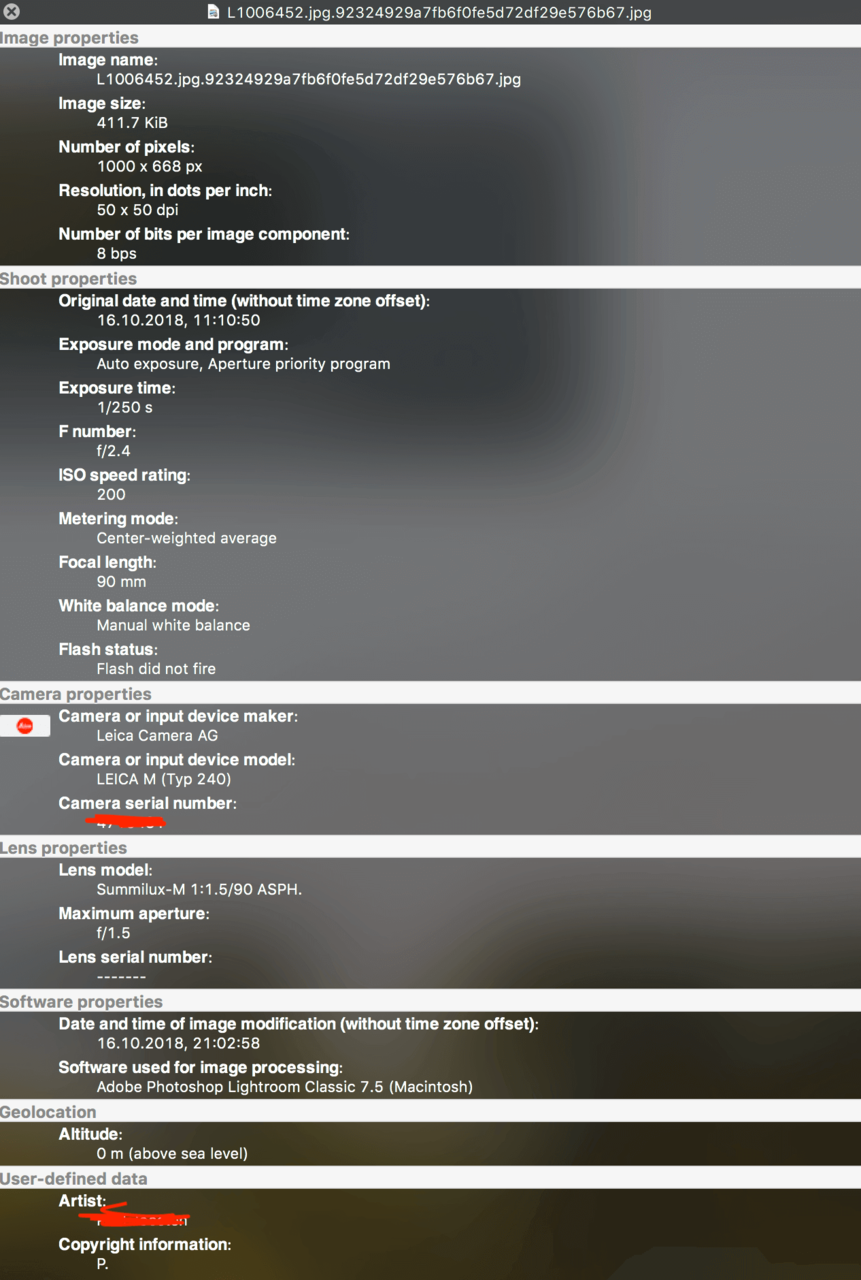

lct Posted October 16, 2018 Share #21 Â Posted October 16, 2018 Advertisement (gone after registration) 10 minutes ago, ianman said: I would suggest that this lens is "known" in the firmware, and as you mentioned maybe some dirt corrupted the reading of the real lens and the camera just thought that a lens having this "new" code was attached. +1 Link to post Share on other sites More sharing options...

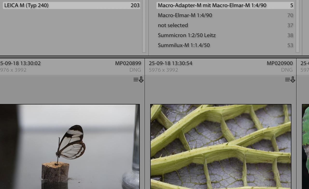

UliWer Posted October 16, 2018 Share #24  Posted October 16, 2018 You need to move the lever for frame selection as well, since the lens detection and so the writing in the EXIF depend on the 6-bit-code together with the position of the frame selector. I just tried with the coded 50 Summilux asph and the frames for 90mm - but didn't get any entry in the EXIF. We have to know which lens Paulus used and can perhaps try with the frames.  Link to post Share on other sites More sharing options...

luigi bertolotti Posted October 16, 2018 Share #26  Posted October 16, 2018 (edited) 6 minutes ago, UliWer said: You need to move the lever for frame selection as well, since the lens detection and so the writing in the EXIF depend on the 6-bit-code together with the position of the frame selector. I just tried with the coded 50 Summilux asph and the frames for 90mm - but didn't get any entry in the EXIF. We have to know which lens Paulus used and can perhaps try with the frames.  .. but EXIF says it's a M 240... it hasn't frame lever. Btw… a lens that is in the firmware ought to be also manually selectable (or not?) … my M240 hasn't Summilux 90 in the list (but I probably haven't made the latest FW update ) Edited October 16, 2018 by luigi bertolotti Link to post Share on other sites More sharing options...

UliWer Posted October 16, 2018 Share #29  Posted October 16, 2018 vor 9 Minuten schrieb luigi bertolotti: .. but EXIF says it's a M 240... it hasn't frame lever. Btw… a lens that is in the firmware ought to be also manually selectable (or not?) … my M240 hasn't Summilux 90 in the list (but I probably haven't made the latest FW update ) Yes, but even without a frame lever, there is an internal selctor for the frames, which is triggered by the lens. And even if the code of the "90mm Summilux" was read due to some error of the coding, the right frames for 90mm must have been triggered as well, otherwise a 90mm lens could not show up.  There are some hidden entries for lenses in the menu. I think it was 01av who found an entry for a 14mm lens long ago, which has never materialized since. Rumors about the 90mm Summilux came at the same time when the 75mm Noctilux was presented.  Link to post Share on other sites More sharing options...

luigi bertolotti Posted October 16, 2018 Share #34  Posted October 16, 2018 20 minutes ago, UliWer said: Yes, but even without a frame lever, there is an internal selctor for the frames, which is triggered by the lens. And even if the code of the "90mm Summilux" was read due to some error of the coding, the right frames for 90mm must have been triggered as well, otherwise a 90mm lens could not show up.   True… which makes to repeat our question to Paulus… which lens had you on ? Which frame did you see in the VF ?  Link to post Share on other sites More sharing options...

01af Posted October 16, 2018 Share #36 Â Posted October 16, 2018 vor 4 Stunden schrieb Paulus: Just happened to see this in Lightroom, I don't know what it means. It probably means the camera got the 6-bit code of the lens wrong. Maybe the lens wasn't properly attached; it didn't fully click into place or it was slightly beyond the proper position in the mount, so the code wasn't recognised correctly. Which lens did you actually use? In any case it means that the rumour about an upcoming Summilux-M 90 mm 1:1.5 Asph is correct. Obviously the camera's current firmware knows this lens yet. And no, it won't be part of the Noctilux family. Noctilux lenses are members of the Noctilux family; this one is going to be part of the Summilux family. Link to post Share on other sites More sharing options...

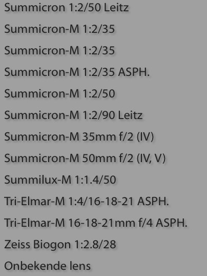

ianman Posted October 16, 2018 Share #37 Â Posted October 16, 2018 2 hours ago, luigi bertolotti said: a lens that is in the firmware ought to be also manually selectable (or not?) No. What would be the point? For example, the 28mm Summaron-M is not in the list of my M9... because all 28mm Summaron-M lenses are coded. I guess only older lenses of which uncoded examples exist are manually selectable. This makes sense. Link to post Share on other sites More sharing options...

ianman Posted October 17, 2018 Share #39  Posted October 17, 2018 Looking again at the exif data, something is bothering me. It indicates "Summilux-M 1:1.5/90 ASPH." and yet, when I look at all the other coded lenses, the nomenclature is different. In the list provided on this page, the nomenclature is familyName-M + focalLength + maxAperture + info. With this "new" lens, it is quite different with the maxAperture preceding the focal length and being written 1:1.5 instead of the f/1.5 format. Taking the standard notation format, the exif should read: "Summilux-M 90mm f/1.5 ASPH." This may be nothing, or it could be that someone (not mentioning any names here Paul 😉) is playing an elaborate joke. After all, it's very easy to modify a files exif data. Link to post Share on other sites More sharing options...
