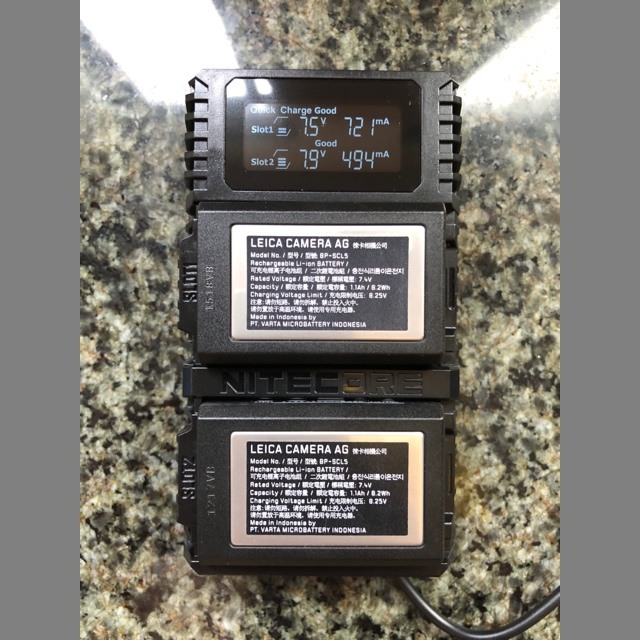

rnl Posted October 13, 2018 Share #1 Posted October 13, 2018 (edited) Advertisement (gone after registration) Just weird. Put an M10 battery in the Nitecore charger and it charged to 8.2V. Took it out, put it in the M10 and the camera showed the battery fully charged and in good condition. I removed the battery and inserted it and another battery into the Nitecore charger. The next day the charger showed both batteries as fully charged - 8.2 v - and in good condition...removed a battery and inserted into the M10...the camera showed a 5% charge and turned off. The other battery showed a 25% charge... I reinserted the batteries and the Nitecore proceed to charge one of the two showing a 7V charge...I immediately removed the batteries and charged them in the Leica charger... I used a reliable electric source for the charger. It's going back to the store for a refund...I am lucky as I am going on a Leica trip to Zion next week and planned to take only the Nitecore charger...that's not happening. Edited October 13, 2018 by richardlipow Link to post Share on other sites More sharing options...

rnl Posted October 13, 2018 Author Share #4 Posted October 13, 2018 this garbage is going back to the retailer I was concerned that the batteries were ruined, but they are fine and fully charged using the Leica charger Link to post Share on other sites More sharing options...

rnl Posted October 13, 2018 Author Share #8 Posted October 13, 2018 19 minutes ago, ramarren said: My Nitecore charger says right on the side that it requires a 5V-2A USB power supply. Laptops and inexpensive hubs often provide about 5.V-1A, which is insufficient for the charger to work reliably. I've been using a Nitecore charger for my CL batteries exclusively since I bought the CL, and for my M-D for a bit longer than that. I used one for the SL batteries too. I power the Nitecore chargers with an Apple iPad Pro charger rated at 5.2V–2.4A output or a CyberPower TR12U3A dual-port charger rated at 5V-3.1A output. I have had no problems with the Nitecore chargers. used a 5V 2A usb power supply and it failed. It's going back today. Link to post Share on other sites More sharing options...

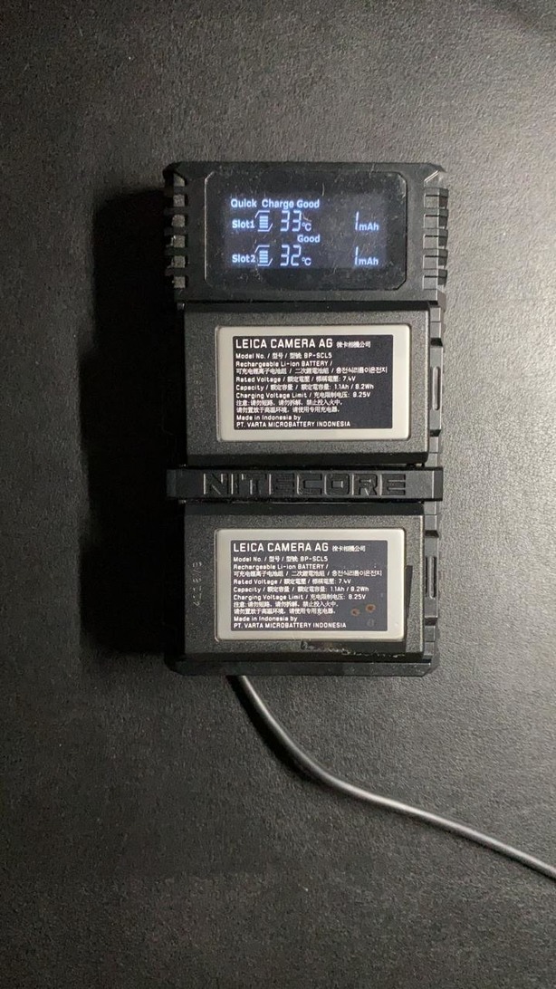

bencychin Posted October 18, 2018 Share #14 Posted October 18, 2018 My M10 nitecore charger arrived today. First impression: 1. larger than i had imagined. 2. the micro USB cable is detachable. 3 charging is sequential, one at a time, no problem detected so far. Personal conclusion: No real advantage over single slot charger other than no need to change battery after charging first of the two Cheers! Benedict Link to post Share on other sites More sharing options...
jkcampbell2 Posted October 18, 2018 Share #15 Posted October 18, 2018 Got mine yesterday. Typical Nitecore quality, still wish for a smaller single slot USB charger the size of my Nitecore M9 charger. 1 Link to post Share on other sites More sharing options...
pico Posted October 18, 2018 Share #16 Posted October 18, 2018 1 hour ago, bencychin said: My M10 nitecore charger arrived today. [...] charging is sequential, one at a time Well, that is stupid. 3 Link to post Share on other sites More sharing options...
jkcampbell2 Posted October 19, 2018 Share #17 Posted October 19, 2018 Well mine definitely does not charge sequentially. Both batteries are charged at the same time. jc 1 Link to post Share on other sites More sharing options...
jkcampbell2 Posted October 19, 2018 Share #18 Posted October 19, 2018 Thinking about it, perhaps it depends on the amperage of the USB source. I'm using a 2 amp USB wall cube. Maybe if you are plugged into a computer or a tiny cell phone charger it goes into a sequential mode because there's just not enough "juice" to charge two batteries at the same time. jc Link to post Share on other sites More sharing options...
bencychin Posted October 19, 2018 Share #19 Posted October 19, 2018 Hi JC, Many thanks for sharing your experience on simulateous charging of both batteries. Indeed it is stated in the leaflet that the charger has 2 modes - Normal and Quick Charge. So my USB plug at 5V 2A will not trigger dual charge. It seems to need 9V 2A to go into QC mode. I now need to buy a USB plug that support QC2.0 or QC3.0 to get simultaneous charging. Every day I am learning new things! Benedict. Link to post Share on other sites More sharing options...
