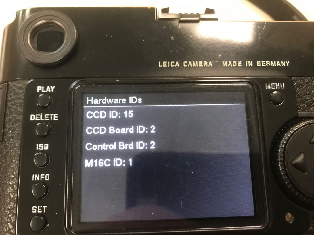

Infantasy Posted December 1, 2017 Share #80 Â Posted December 1, 2017 Dear forum members, My M9 was sent to Leica in October 2015 and collected back in July 2016. The hardware info is: CCD ID :15 CCD Board ID : 2 Control Brd ID : 2 M16C ID : 0 Firmware now is 1.210 as I forget whether had updated or not. There is no corrosion issue at all. Does anyone know the CCD is a new one or still has corrosion issue sensor. Thanks Link to post Share on other sites More sharing options...
