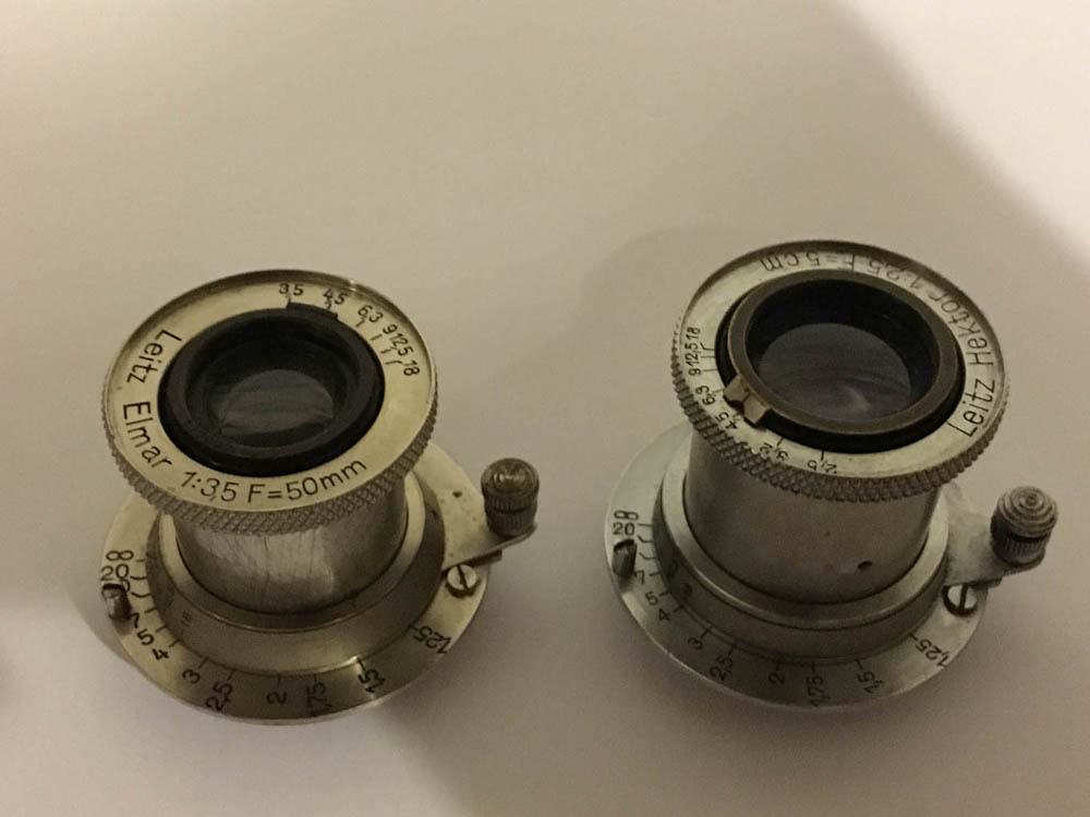

seekwhence Posted May 3, 2016 Author Share #7 Posted May 3, 2016 Advertisement (gone after registration) Thanks guys for the information. I made some quick images of the Hektor lens with my cellphone. Sorry for the poor quality.The first shows the chrome non-serial numbered Hektor next to an early nickel Elmar (SN: 137097). The next image shows the Hektor lens on the camera it came with - a Leica II (SN: 83126) Any further insights or opinions? I suppose the most plausible explanation for the lack of serial number is that the lens was upgraded/converted from an earlier Hektor as Jerzy suggested. Dave Link to post Share on other sites More sharing options...

jerzy Posted May 4, 2016 Share #10 Posted May 4, 2016 Your camera as produced as II and does not show any visible signs of an upgrade. Just the speed dial, although correct for Leica II must have been replaced some time, the original one should have been larger, 15,4mm in diameter if I remember correctly. Isn't it chrome? Looks shiner On your photo compared to other nickeled elements. In any case, the lens seem to be earlier than the camera and converted after 1936, more precise dating is not possible. Link to post Share on other sites More sharing options...
willeica Posted May 4, 2016 Share #11 Posted May 4, 2016 Jerzy is correct. This is a regular series camera with just a replacement for the shutter speed dial. There is nothing to associate the Hektor with the camera and they were probably put together later. van Hasbroeck states that many chrome Hektors were produced in wartime with poor quality chrome. Variant No 7 (the last one) on van Hasbroeck's list is the chrome one with IR mark. I suspect that an early Hektor lens head (possibly from an II O'Clock lens) was used with a later mount and was chromed, possibly during wartime. This re-matching of mount and head is similar to what was done with my Elmar shown above on a Standard. I also have a Summar where a lens head was mated with a mount from a different period. Upgrades and various other re-matches were quite common in the pre-war period. William Link to post Share on other sites More sharing options...
